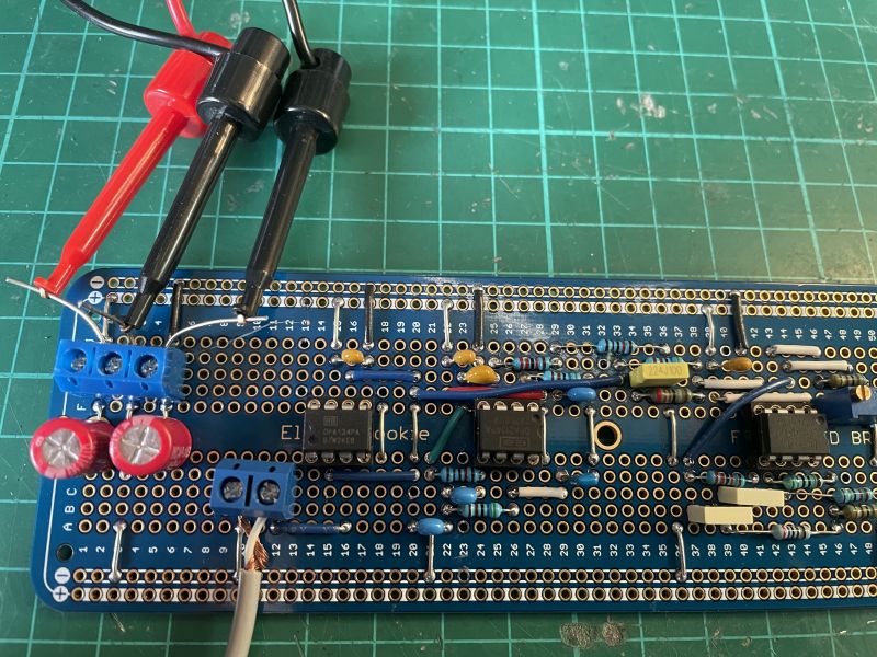

I was in the final stages of assembling an opamp-based active filter on a solder protoboard when I saw this, so had the opportunity for a little experimentation. Supply was connected using rather thin probe leads (sorry) from a good quality Philips dual bench supply.
Each opamp is locally-ish decoupled with 100nF rail-rail. The first stage is configured as a unity gain buffer as in your case.
Before adding the red rail-ground electrolytics, I could indeed get some HF oscillation at its output, dependant on the rail voltage; at +-5v, all was quiet, but above about +-8v a ~10Mhz oscillation would occur at the buffer output, with an amplitude of about 5-10% of the absolute supply voltage. Waving the supply leads around a bit slightly altered the frequency and amplitude of the oscillation, so maybe the (mutual) inductance of the leads was a contributing factor.
Introducing the electrolytics completely cured the issue at any supply voltage. So this definitely appears to back up the concerns/ideas of all the helpful suggestions already received.

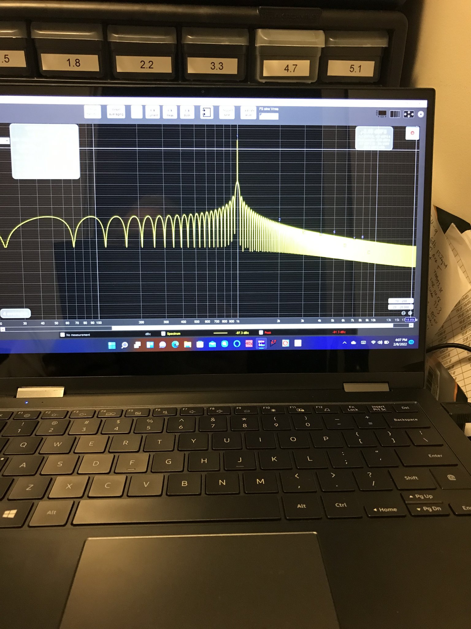

This is most likely a Buffer and/or system activity issue. Are you using ASIO?Every few minutes the REW rta display does this,
If so, in the ASIO Control Panel, increase your buffer size to maximum and re-check whether REW still does this. Another thing you could do is to deactivate as many processes as possible when measuring, e.g. turn off your Wi-Fi.
BTW, if this happens, click on the Reset Averaging button and REW will re-start the calculation afresh.
Is there any reason you aren't showing a picture of your breadboard circuit?
The LM4562 is unity gain stable according to spec so it should not be such a hassle to keep it from oscillating, right? Anything could happen on the workbench if the setup is to blame but lets assume its OK.
