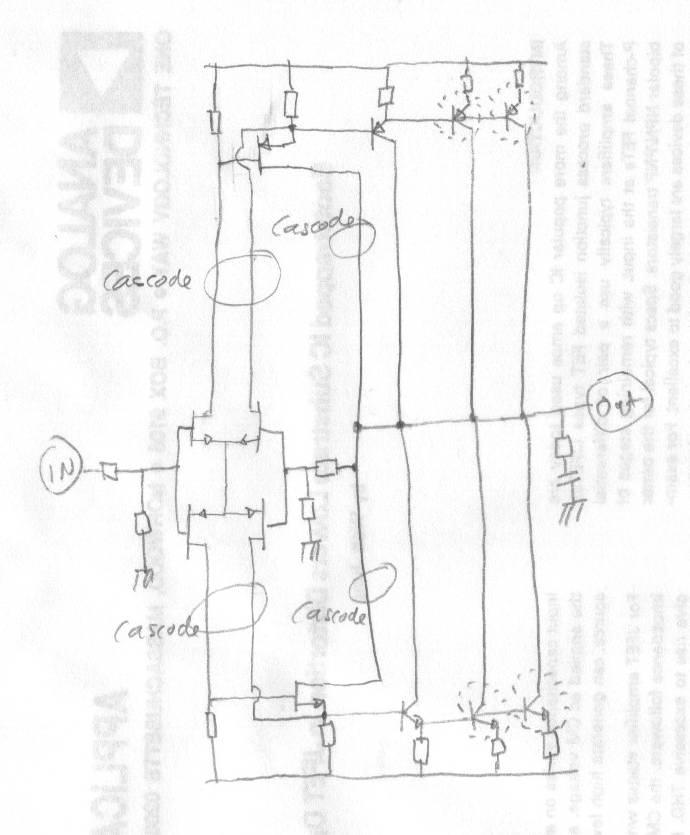

I have somewhere a circuit diagram said to be SCP, reverse engineered by someone I guess. Not me. I must check first.
RK
RK
It would appear that the schematic in the FIRST submission of the 'Inverting fet open-loop gain-stage' thread would work with a few small changes.
