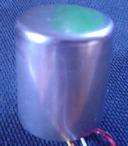

(Steve Eddy current is an alias for Mr Ice Rowland)

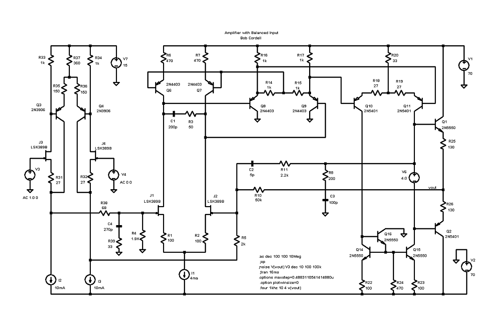

Bob, why don't you modify your amplifier to do balanced, as well as single ended, depending on the choice and need of the amp's owner? Then we will have a common point of discussion.
Hi John,
Attached below is the schematic of my input/VAS circuit modified to accept balanced inputs.
As you know, it is normally the case that some sort of buffering is required to perform the differential-to-single-ended conversion for an amplifier with substantial gain, largely due to the need to drive the inverting input. Here I have chosen to pass both differential inputs through a symmetrical discrete balanced JFET buffer. This means that both of the differential inputs can have identical, high values of input impedance and that both positive and negative signals encounter the same signal path for symmetry (unlike the more common approach of just buffering the negative side).
The differential buffer, which I refer to here as a Differential Complementary Feedback Quad (DCFQ), employs two JFETs and two BJTs in a differential arrangement analogous to a pair of JFET-Bipolar CFPs. This arrangement provides a low-distortion, low-impedance drive to the subsequent differential amplifier arrangement of the input/VAS stage.
J3 and J4 form a pair of source-followers that are “helped” by their respective complements Q3 and Q4. Q3 and Q4 are arranged as a differential pair, resulting in much-improved bias stability as compared to the use of two individual JFET-bipolar CFPs. R31 and R32 drop the source voltages down to zero volts.
THD of the DCFQ stage is less than 0.002% under all conditions of positive, negative and differential drive. This arrangement also takes advantage of the good offset matching of the dual JFET, with common variations in Vgs resulting in just a common mode offset that is ignored by the subsequent differential amplifier. If desired, the common mode level presented to the subsequent differential amplifier can be trimmed to zero with R37.
Gain of the amplifier is set to 28 dB, and input-referred noise is 6.9 nV/rt Hz using the LSK389 JFET pairs.
Input common mode rejection is 62 dB out to 1 MHz. This could probably be improved, at least in the audio band, by closer resistor tolerances. The C4-R39 combination plays an important role in maintaining the balance necessary for good HF CMRR.
When a single-ended RCA input arrangement is desired, the negative differential input can just be switched to ground.
