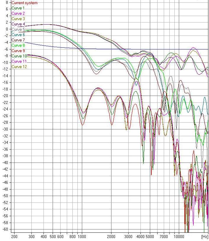

Assuming this being a real system, how would you estimate
consistency of dispersion, say above 600 Hz ?
Upper set of curves around 00 degrees off axis
Middle set of curves around 45 degrees of axis
Lower set of curves around 65 degrees of axis
