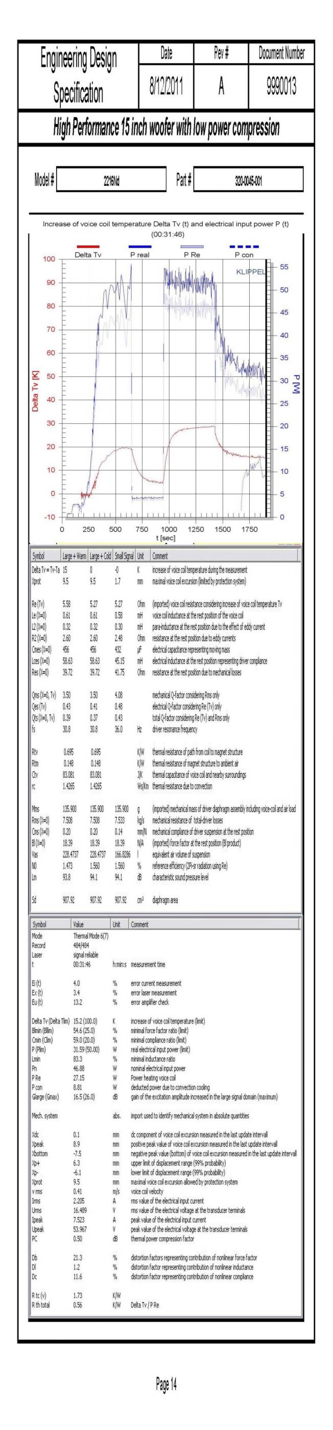

If we apply heat to a thermal mass then it may instantaneously start to rise in temperature, but it will rise at a rate totally determined by its time constant.
This is what I was saying except for a difference in opinion if the initial rise depends ONLY on the thermal capacity or the thermal capacity times the thermal resistance. Either way the rest of my discussion is correct.
I will have to check on the temperature rise because the thermal capacity is in degrees Joules per kelvin which means that the temperature change depends only on the heat injected into the material. Perhaps the "heat" here is the heat difference between the input heat and the output heat (that would bring the thermal resistance into the situation). Either way the instantaneous change in temperature is a function of the thermal capacity which is strongly related to the efficiency. Higher efficiency speakers have dramatically lower instantaneous temperature changes for a given SPL.
The static or long term temperature depends only on the thermal resistance. We both agree with that.
Hi Duke
Mostly right except:
a) The modulation would be linear in the power, but not the signal, so there would still me more modulation at higher SPLs than lower ones.
b) audibility of any of this is just a guess, but it does have the potential to explain what is often called "dynamics". people keep using a woofer as an example, but I don't see a woofer being the main culprit. I see it being the mid/tweeter, drivers acting above about 700 Hz. To me the ubiquitous 1" tweeter just sounds strained - no dynamics. What is that? Its certainly not frequency response.
c) in general that which makes for high efficiency makes for low thermal modulation. It would also tend to lower thermal compression but that is not guaranteed.
Does this help the discussion?? The new 2216 driver used in the JBL M2 monitor uses special voice coil wire with a tcr that helps stave off the effects of thermal compression. Here is a Klippel graph of this driver.
Rob🙂

Thanks Rob,
That is an interesting graph and it illustrates my descriptions of how VC temperature varies. The upper curves appear to be two blasts of noise or music input. The lower curve shows the exponential rise and fall of voice coil temperature in response. There is clearly a time constant associated with temperature change and it has the look of a heavily low pass filtered square wave, much as a slow charging RC filter would show. The time constant could be directly pulled from the graph by looking at the rate of change of temperature. Since the music or noise was on off on, there are several cycles of temperature swing and an upwards drift as the magnet structure slowly warms (at least 2 time constants are involved).
The practical effect of all this is that the DCR of the driver is changing in proportion to VC temp (0.38% / Degree C rise for copper wire). As VCR changes sensitivity drops exactly as if we added a few ohms of parasitic resistance in series with woofer and tweeter. We used to measure the resultant "power compression" curves at JBL (1, 10, and 100 Watts were a popular choice) although they were misleading as the sweep rate had much to do with the compression seen. If power compression looked like too much for advertising purposes, the we just ran the curves a little faster.
Is it audible? Again, it is a slowly varying frequency response error. It requires a steady application of power input (the thermal masses provide an integrating element) and you have to be running the voice coils damn hot to get a few dB of loss. Much as Wayne described, I first noticed the phenomenon when doing pink noise testing on tweeters. If you switch on pink noise you see output SPL jump to a level and then drift slowly downwards a few dB.
Probably a real enough factor in PA applications but I wouldn't lose sleep over it at home.
David
As to the modulation of the music envelope, take another look at the woofer curve. From the initial rise time it looks to me like a time constant in the 10 to 20 second range. It is taking 100s of seconds to approach a stable temperature when the 50 Watt blast is applied.
Anybody that thinks music is being quickly modulated is ignoring the data.
