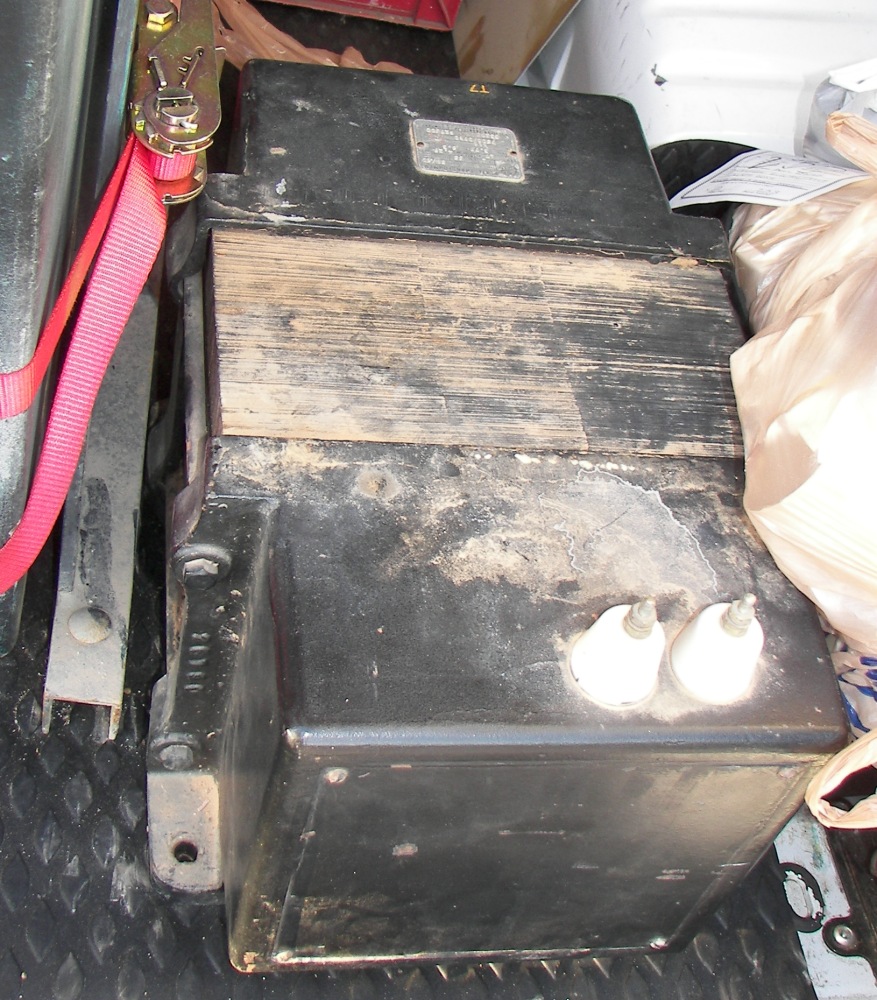

It was received empty, and has been long enough for a 'rusty looking' spot to appear on the core. It's been in a humidity controlled space now to a couple months. I better take it to a transformer shop, tell them what it is, ask them to give it the works. They ought to have the Diala BX or equivalent.
