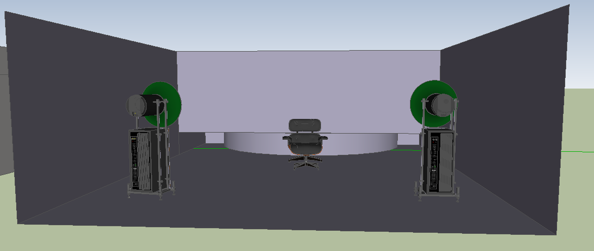

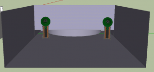

I designed and started to build (3years and no further progress) a bass horn into my loft space.
It is to be 28feet long and nearly 40sq ft mouth feeding into ½pi space (corner mounted)
I can see from his pics that Romy's horn is very much smaller and could never perform down to 20Hz.
It was the phasing issue I was interested in, since his bass drivers are so much further away from his listening position. Mine will be worse if I ever get around to completion.
The distances are actually pretty close to the same. The main front speakers are about the same distance from the listening position as the loft mounted horns. Well, something within about 1/4 wave length at the crossover point.
I will be building my bass horn like the below sketch shows. Then I can try it with the main speakers from the opposite side of the room as in the sketch, so distances are equal or with the main horns in front of the bass horn.
