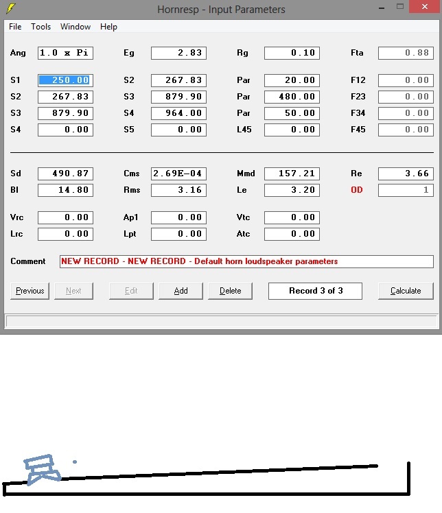

I woke up this morning with a thought that I thought merited some opinions. I had the sudden urge to try modeling a pair of subwoofer horns that are essentially unfolded, with visible drivers at say, the front of the room, firing into a horn that flared along the sides of the walls, with the mouth area exiting toward the rear of the room...or the other way around.
Before I try to model something like this, has anyone tried anything like this? I figure it would be pretty much a FLH but with no rear chamber.

Yup, if there's no rear chamber it's a back loaded horn. If you want a constant expansion rate as shown in your pic you can use the BIB spreadsheet either as a starting point or as a complete design. But end loaded might not work so well, you might want to use the BIB's 20 or 40 percent driver position to smooth the response a bit.
I don't personally like this idea for a number of reasons but it will work if that's what you really want.

Well, what I was hoping for was really just a flashier way to make a horn that isn't a taped horn, so aside from the straight flare, it could also "rollercoaster" a bit, which I think would look awesome. I'm just trying to get a handle on what the acoustic disadvantages might be. The hornresp output looks a little funky, but nothing I couldn't tame with the MiniDSP if I had to.

Really what I envisioned was a "shelf" that ran the length of the room on each side, 13 inches tall, with a driver mounted at the back of the room and a horn mouth at the front.
The part that concerns me is the rear of the driver that's showing would be some 550 cm from where the mouth is and I'm not sure that I'm plugging data into hornresp (or maybe I did?) to see exactly what that's going to do.
well, if the horn mouth fired into the corner (since you have a total cement corner), you could have a small (ish, lol) horn, but the length needs to be 1/4 wavelength of 1/2 octave lower than the mouth cutoff. Just classic rules of thumb.
So, a 30hz horn should be 12' long and have around 14ft2 mouth.
Stick it in a chamber and don't worry about it. Use a plexiglass window if you need to see the driver. Or just make an unfolded BIB with a 40 percent (or more) driver position, that will put the driver fairly close to the mouth. As long as you stay within 1/4 wavelength of the highest frequency the sub will play you have nothing to worry about. At 100 hz that's almost 3 feet, at 80 hz 3.5 feet. If you exceed that by a bit it isn't going to be a disaster.

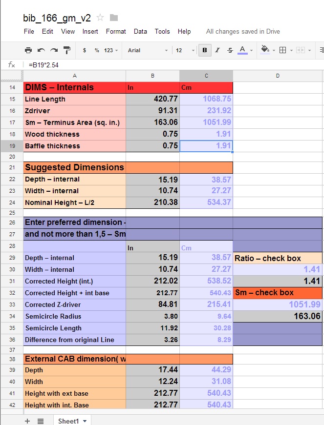

Honestly, I've experimented with LLT vented, T-TQWT, Tapped Horn (which I loved for some source material and despised for others) and most recently, a T-QWP and one of the things I considered was unfolding the T-QWP into a "monolith" because it'd be easy, but I'm really open to anything...
The BIB is giving me something to think about, simply because of the name, and for the frequency I'd try to tune it to, it'd probably be massive.
Edit: Perhaps massive isn't the right word, see attached.

It's actually pretty small if you unfold it and put it on the wall, the mouth is only 163 sq inches so for most of it's length it wouldn't even be big enough to form an effective shelf. But it is long, which is not unexpected. Conical pipe/horns are the longest type of horn there is. If you want to shorten it you need to either change the flare or make the throat larger or both, but if you do that it won't be a BIB anymore.
