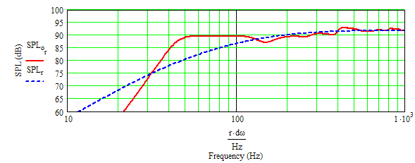

WRT the FE127E, its highish Qts would require a horn flare, ergo lower driver location, so the ROTs won't work here and a MLTL this long for such a small Vas driver poses some problems, but this doesn't look too bad once EQ'd if the published specs are reasonably close:
L = 49.5"
W x D = 7.312" x 4.5"
zdriver = near/at the top
zport = 35.125"
port = 2" dia. x 1.75"
All dims i.d. and stuff as required down to just above the vent (0.25 lbs/ft^3 shown).
GM
