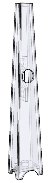

Metronome?
dave
It will if it's ~8 ft square. 😉 You will need one of the high gain BLHs to offset the LF/mid-bass/lower mids loss if not built into a wall. Then again, these little drivers by themselves really should only be critically listened to either up close and/or in a small room when tuned below ~1.6*Fs as they rapidly begin sounding 'congested' due to their low Xmax, so depending on the driver's HF response in these situations they may not need any BSC.
GM

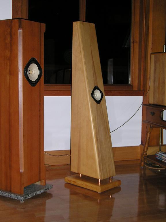

FE127 bipole TQWP
Here is a picture of an interesting project I made a few years ago. They are bipoles. I quite like the sound of them. The new owner seems quite happy with them.
If you are interested I am sure dave could send you the design.

Scott's bipole Voigt pipe did sound quite fine indeed, although Dave might suggest some minor refinement to details.
There were a pair of bipole metronomes with Hemp FR4.5 played at a DIY party last year that sounded spectacular.
