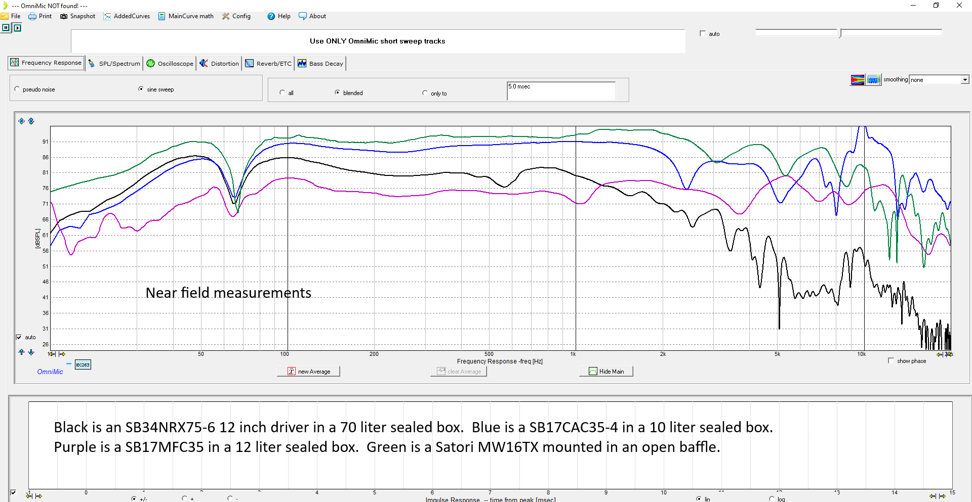

In the first pic you can see the near field responses of 4 different drivers. Black is an SB34NRX75-6 12 inch driver in a 70 liter sealed box. Blue is a SB17CAC35-4 in a 10 liter sealed box. Purple is a SB17MFC35 in a 12 liter sealed box. Green is a Satori MW16TX mounted in an open baffle. All have a pronounced null between 64 Hz and 68 Hz.
There is no reason (that I can think of) for a null to appear like this in a near field measurement. None of the impedance plots show anything going on at 64 Hz, just a typical sealed box driver response. It is just not statistically probable that all four drivers would have some kind of defect at 64 Hz.

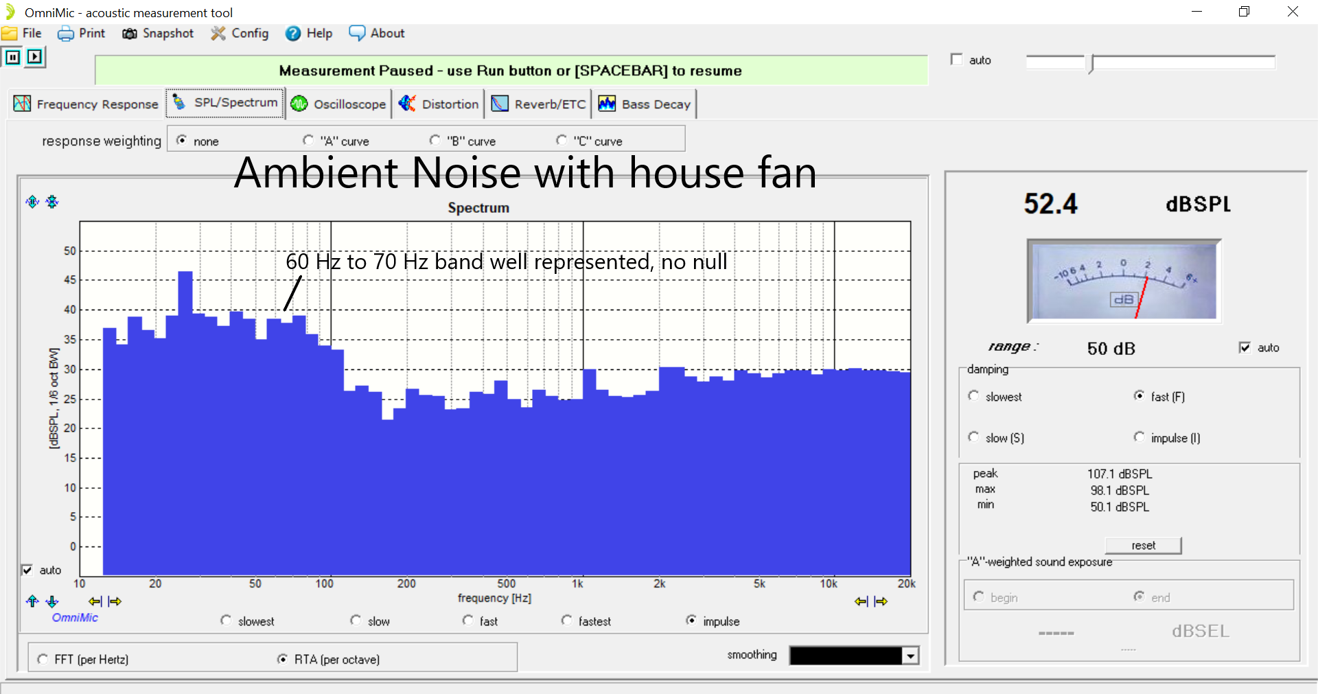

I am also showing an ambient noise reading I took in my basement when I had the house fan running. This same microphone / software has no problem picking up 60-70 Hz in RTA mode.

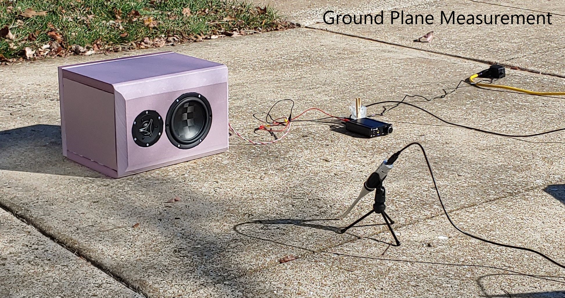

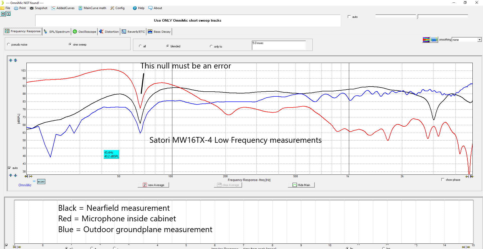

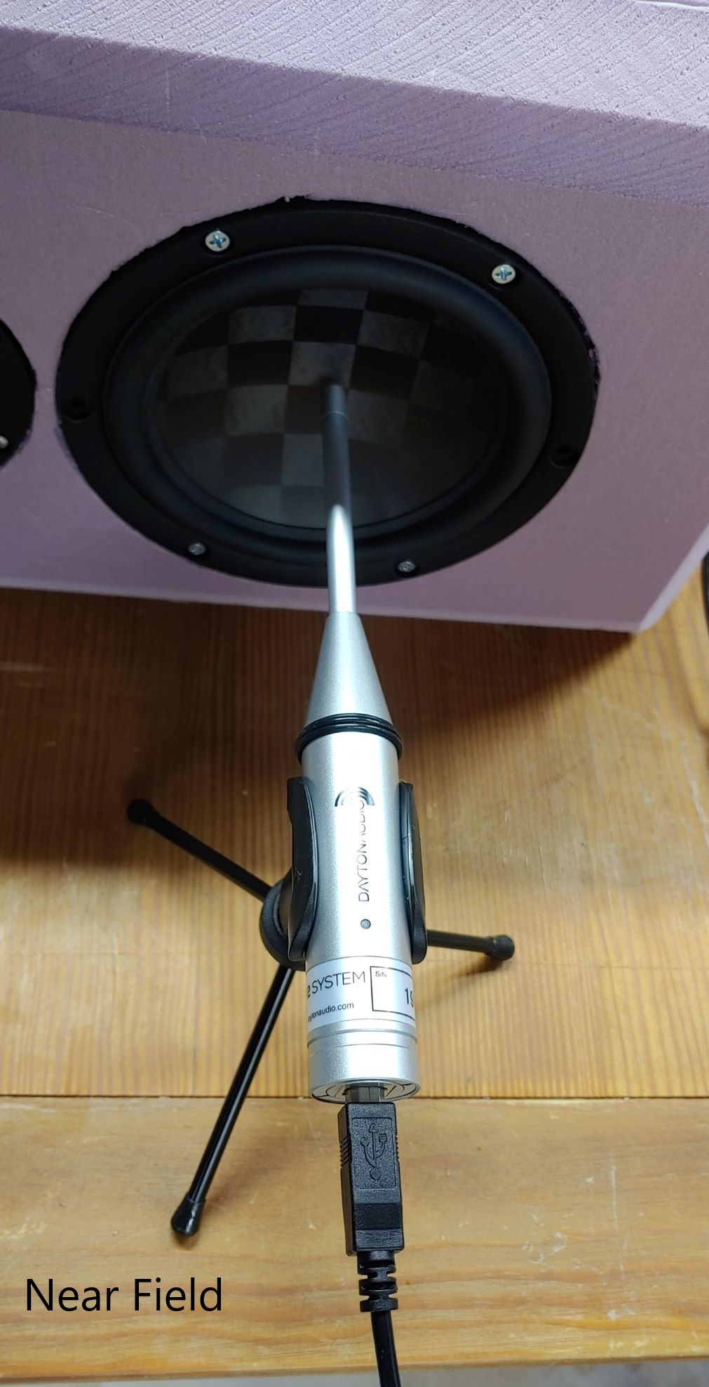

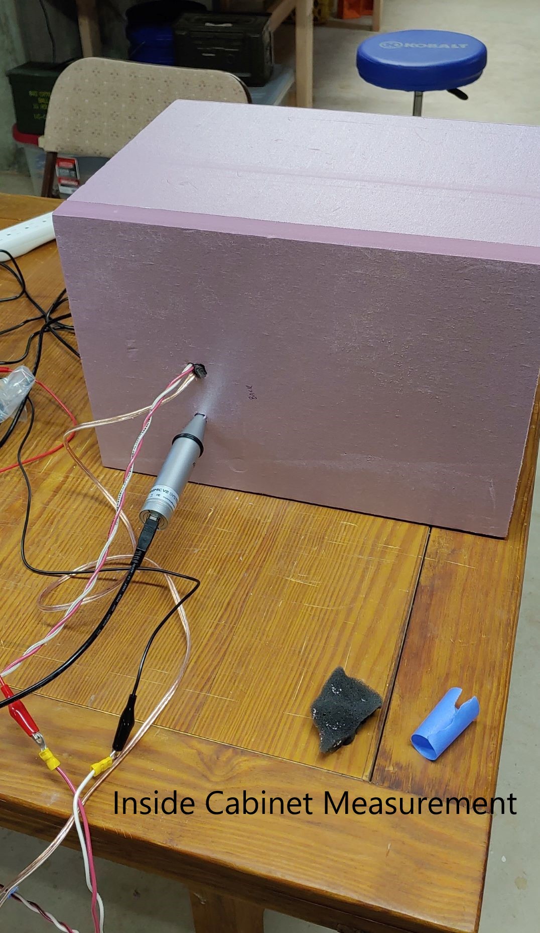

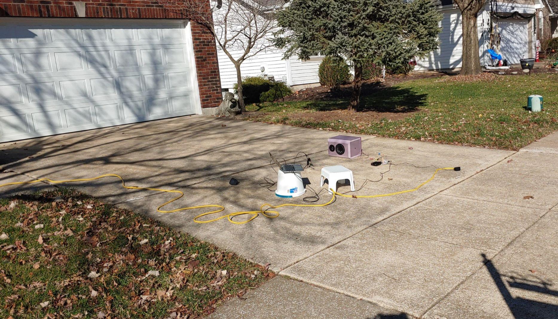

So I decided to take some measurements under conditions where I know that no 64 Hz null should exist. I have the Satori MW16TX mounted in a foam board box, so first I measured the near field response of this driver, and the null was present as expected. Next I cut a small hole in the back of the foam board cabinet and pushed the microphone in. Amazingly the null was still present. I patched up the hole and took the box onto my driveway to conduct a ground plane measurement. I was 14 ft from the nearest wall. Once again, I measured the same null. In the plot, Black is nearfield, Red is taken from inside the box, Blue is outdoor groundplane.
WTF. I am confused. Any ideas would be welcome.

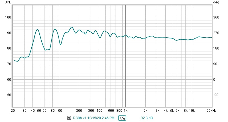

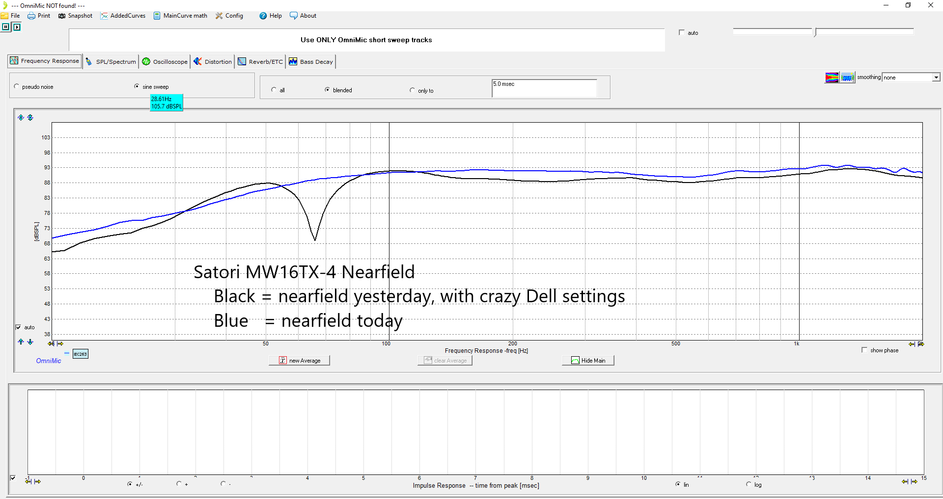

Thanks to everyone for giving me ideas on where to look. I should have mentioned that all my recent measurements were with the laptop on battery power to eliminate the possibility of 60 Hz EMI.
By the time I made the original post, I was 99.99% certain that this "null" was a measurement error, not anything acoustical. I was also 90% sure that it was not a problem with the microphone itself, since I was able to measure broadband noise or pink noise and not measure a null.
I was so focussed on the microphone / software part that I lost sight of how the test signal was generated. Xrk971 reminded me of that, and yes I am using a dell laptop.

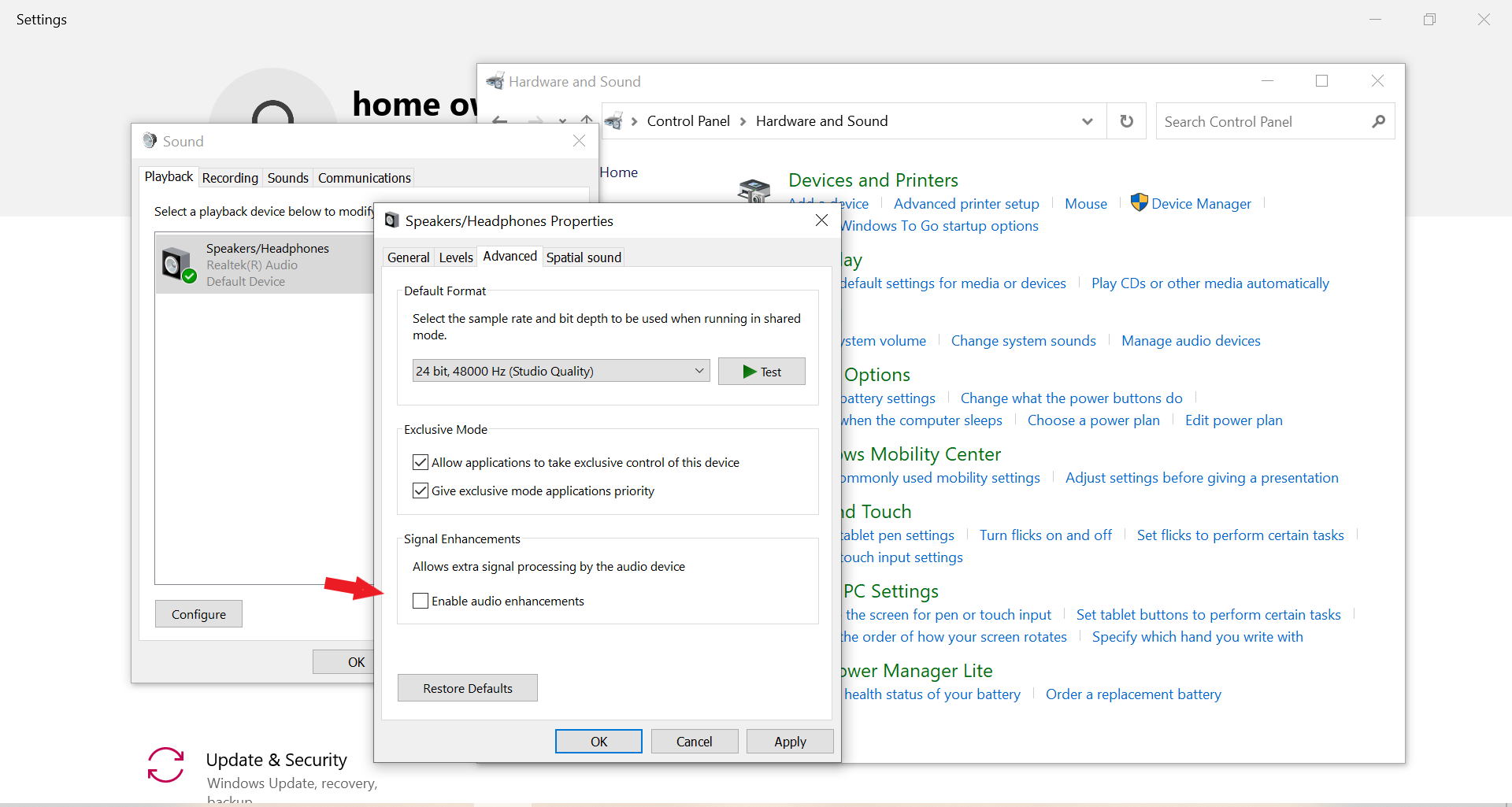

I used my desktop PC (Lenovo) to generate the test signals, and Shazam! the null was gone. Same thing when I used my wife's Acer laptop... no null. ... so now I went search through the Dell control panel to find some kind of audio setting. Unchecking a box called "enable apps to use ambience enhancement" solved the problem... Who at Dell thinks of this crap?
So problem solved. Thanks to everyone for the brainstorming. It was very helpful.

I had the wording slightly wrong on the control panel... "enable audio enhancements".
It would be so much clearer if Dell had labeled this as two options (1) "enhanced bass" (2) "flat frequency response" ... there, clarity and brevity all in one, and it only took me 19 seconds to think of it...
