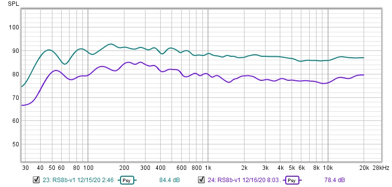

That's what I assume, but it looks a lot like Jim's measurements. I checked my sound settings and the speakers were set to small. There was no crossover setting so it just cutoff at an unknown frequency. I set the speakers to large and here is a before and after measurement. Thanks Jim.

Now you could also change your original post wording to:I had the wording slightly wrong on the control panel... "enable audio enhancements".
"Unexplained low frequency measurement mystery Solved"
That still won't stop people from posting other "mystery explanation" theories, but might alert others to the potential of what normally invisible control panel settings can do, without reading through the eventual denouemont ;^).

Hopefully, by now everyone knows how to configure Windows to not damage audio playback. By default Windows does real time ASRC on all audio playback, not a good thing.
Only using using ASIO, along with keeping Windows from using the ASIO sound device as a system sound device, can prevent the damage from happening.
