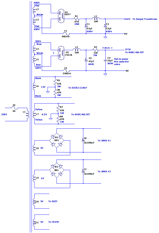

So, there are no potentiometers across the filaments, with the wiper going to the self bias network, right?
Yes, the 300B heaters are indeed DC powered. Even the best performing of the 4 amps noise and distortion-wise, looks similar.
I've attached the power supply schematic again.
The ECC82 and 6H8C heaters are AC powered. Their heater wiring is less than optimum; tighter twists and relocation to the corners of the chassis would be good. But I don't want to rebuild these things. Lugging them around is going to give me a hernia!

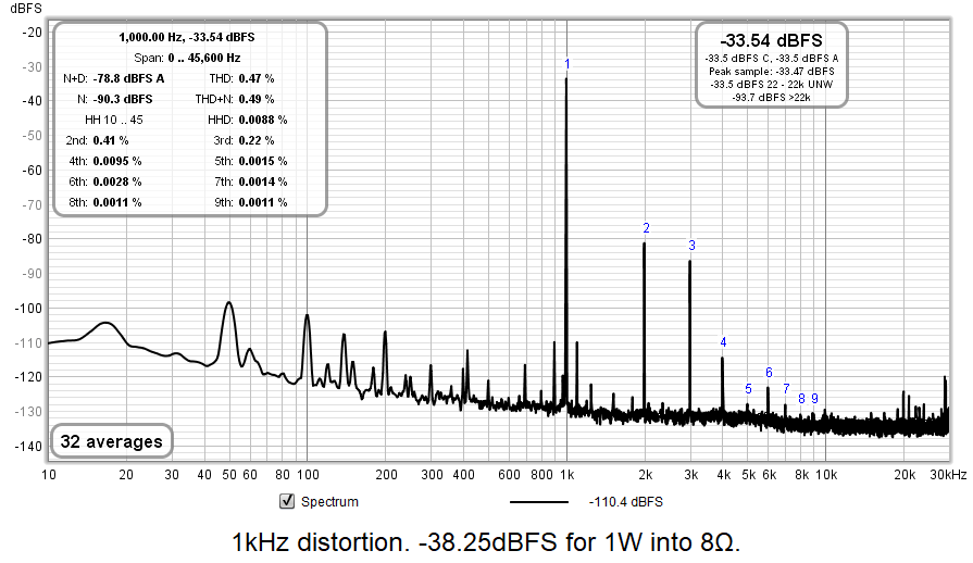

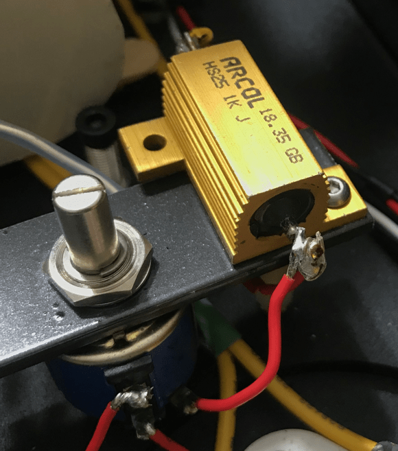

After an exhaustive process of elimination, I have tracked down the cause of the problem to one of the 25W 300B cathode resistors.
As you can see, the original builder didn't mount them properly. There's air underneath it. Despite dissipating only 5W, they get really hot. Not sure how a wire-wound resistor can degrade but it obviously has.
I really need to transfer all 8 of them to the chassis but that will be a lot of work.
And how does this resistos measure? Curious, as the first question in the thread was indeed about the resistors, and you mentioned the currents through the valves were mathched.
So, transfer the (new) resistors to be in contact with the chassis, two bolts and thermal grease?

The currents were indeed equal. It didn't occur to me to measure the problem resistor so I just did. Strangely, it's open circuit! Maybe the voltage applied by my meters isn't enough to get a reading.
I've already started moving the resistors in the first amp. The top plate is 1cm thick so I'll have to drill and tap it. I should really scrape the power coat off too.

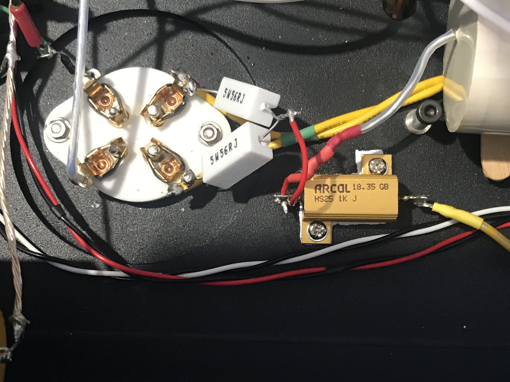

I pulled out the resistors and pots in one of the amps. 4 drilled and tapped holes later, the resistors are now screwed to the chassis with thermal paste.
Now that I can identify the pots, they're Bourns 3540S-91-101L. They're rated at 2W @ 75°C. My calculations suggest that with 70mA through the resistors, the pot centered and 5V across the filament (and the pot), power dissipation in the pot would be close to 2W.

Replacing the pots with 50Ω resistors would certainly simplify the process of attaching the cathode resistors to the chassis.

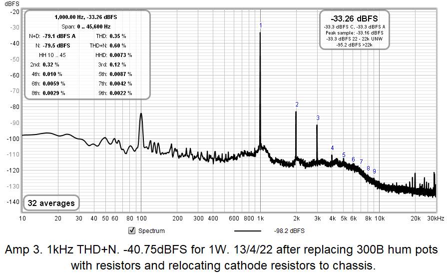

Any reason why moving the cathode resistors to the chassis and replacing the 10-turn pots with discrete resistors should increase the noise by 8dB or so?
Mind-you, I had this happen before so it could be external noise or something to do with my test set-up. I'll repeat the measurements later.

Looks like you may need trimpots after all. A testable theory is that the 100Hz spike is coming from ripple on the filaments' supply. Best course would be better filtering, but a lesser option is to add a 1K Ohm trimpot in parallel to the brick resistors. Ripple doesn't trim out perfectly, so it's always better to just filter it out, but worth a try, and both together are not against the law.
