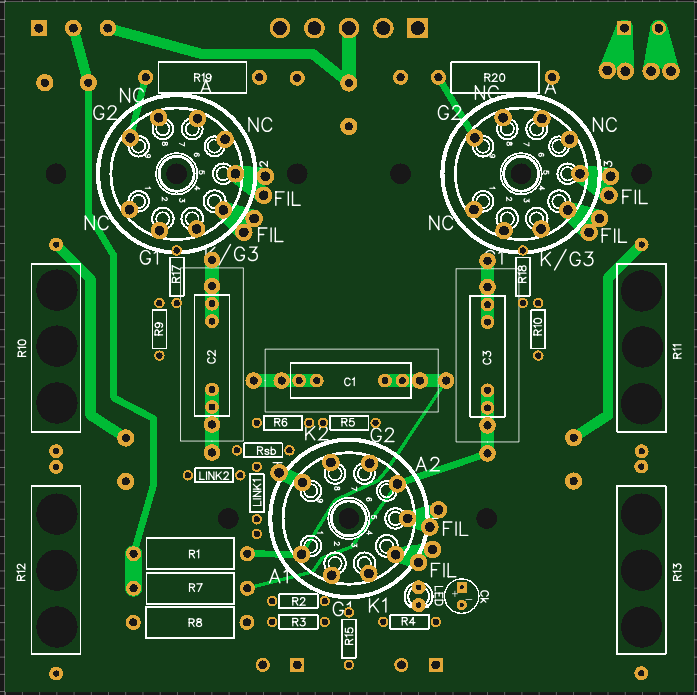

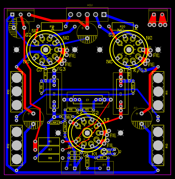

For anybody interested, My version (variation?) of this design uses garter bias on the outout stage, and some GNFB to the cathode of the first tube. I'm working up a design for the PCB that will be universal- primarily intended to be used with EL84/6P14P, EL86/6CW5, and 6P43P-E triode connected outputs. I've incorporated options to wire the outputs as pentode, triode, or UL, and given some flexibility in biasing the input stage, with an unbypassed resistor, resistor/bypass cap, or LED. Sort of an experimenters' playground, spurred on by the availability of affordable 6N1P, 6N2P, 6P14P, and 6P43P-E tubes, and others. I happen to have twenty or so 6P43P-E that I am intending to build up triode connected that these PCB's seem especially handy for 🙂
If interested in checking it out, swing by my thread on the 6N2P/6CW5 build, and suggestions are welcome!
I’m very interested in your effort here, and appreciate your desire for tube and OT connection flexibility. I have a box full of EL86 tubes, mostly good Euro version, that I would like to put to good use.

I'd be interested. I'm building one right now.p2p. But would love to build friends pcb versions of this.. I'm working up a design for the PCB that will be universal- primarily intended to be used with EL84/6P14P, EL86/6CW5, and 6P43P-E triode connected outputs.
I might be ordering PCB prototypes soon, once I build one up I'll post more in my 6n2p/6CW5 thread. I think I'll have six designs to test coming in soon 😱

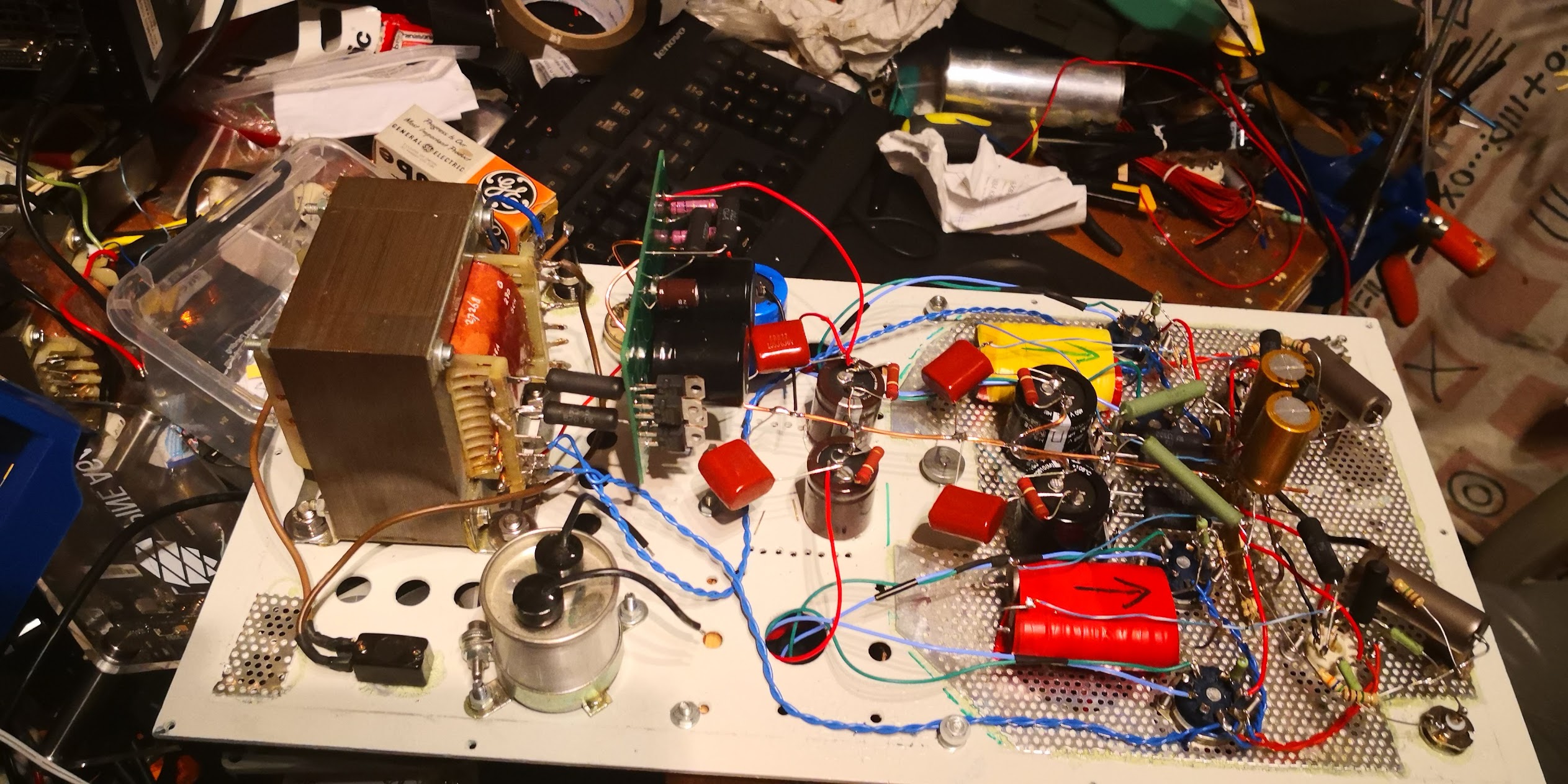

A bit difficult to see, somewhat blurry ... resistor to ground from the RCA ground tab instead of going directly to ground ?
Best regards, Claas
Best regards, Claas
Well done Claas. Should have ground of rca going to ground. And that resistor to rca signal from ground.

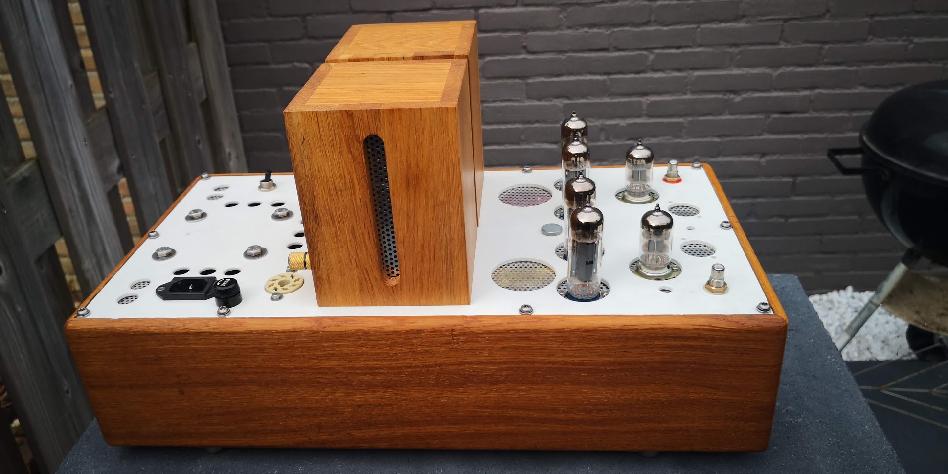

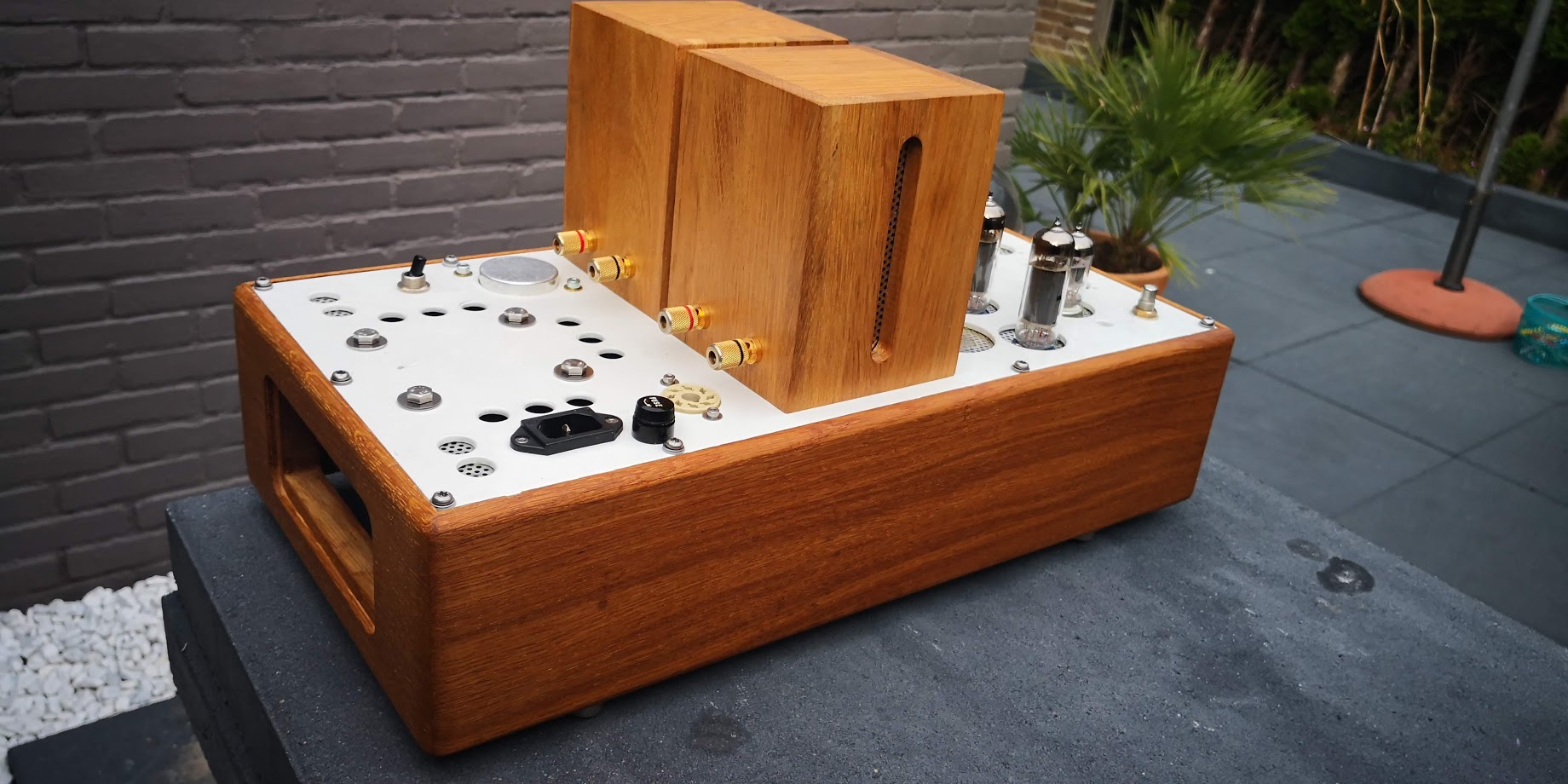

She's finished. And she's a keeper. Replace the first tube cathode resistor with silicon carbide diode. STPSC2H12D did think that was a slight improvement. Still have to try the lm317's in the tail.
Gorgeous!
