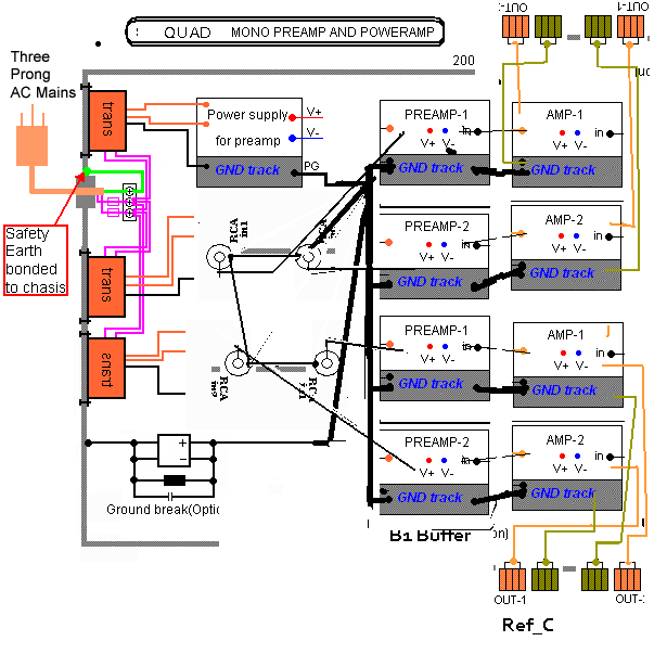

When you say higher level I assume you mean because there are two separate grounding stages for the outputs and the star ground?
Is the diagram correct for a safe and ground loop free design or do I have to move all the output ground points to the star ground too?
Sorry the diagram is so poor I went through a few revisions myself as I was sketching it.

Hi Matt
Since you have mono-blocks each PA will have its own star at its individual PS ie at the output caps common point. Note for most designs this means the speaker return will tie at this star as well, instead of the PA.
Then each PA star will connect to chassis forming another star at the disconnect network.
The preamp should connect to its own power supply and input/out depending on the circuit/PCB layout. Usually this means PRE outs to PA signal gnd/ separate from the PA gnd star. PRE ins should be direct to isolated connectors. Use twisted wires or shielded cable for signals.

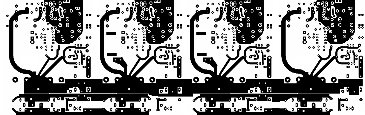

Thanks for the reply, after looking through every stage carefully it looks as if I don't have any choice as the power supply for the regulator effectively grounds all four power amps together anyway.
Should I make a 4 link ground path on the board otherwise they will be grounded down the wires of the regulator?
I also have the same problem with the B1 buffer unless I went to extremes of making totally separate supplies for every part to ground stuff separately.
I am using two large transformers for each channel pair which are centre tapped so this already grounds two boards also.
Can anyone suggest what should be done?

Matt,
Not sure what you are doing, but you might get better answers in B1 threads?
BTW good chip-amp implementations really don't need no stinkin' buffers B1 or others.
In a monoblock there is one channel and one audio ground. Easy. The rules allow the audio ground to be located on the chassis or on the amp PCB or at the speaker return terminal or floating in space between all the main components of the amplifier.
Going to multi-channel does not changes the rules.
Each amplifier must have an audio ground. All the parts of that one channel must be referenced to that audio ground.
The problem is that the implementation forces one to adopt a common Safety Earth and this compromises the audio ground.
I see two choices.
a.) keep a separate audio ground for each channel. This demands a pair of isolated transformer windings for each channel.
b.) share a common audio ground among all the channels.
This can be a master star ground serving the PSU and chassis and the 4 audio grounds, plus 4 audio star grounds serving their own amp
or
it can be a master shared audio ground. This requires all the return routes for all the individual currents to have a wire back to the master shared audio ground.
That makes up 3 alternatives.
A giant star ground for everything
or
A star with 4 star off it
or
4 isolated channels each with their own isolated PSU and transformer windings.
Are there any drawbacks to having one master star ground for all channels as oppose to separate grounds?
At the moment it looks like this is the only possible implementation from looking at the design and your list.
The first problem is I was originally building the old style gain clone so bought 2x25vac x2 transformers, this means to use it with the new design I have to use them as a two lots of centre tapped outputs forcing the grounds of two amps together.
I am using a single super regulator for all four opamps across all channels as the load is tiny, this again however uses a single ground effectively now joining the two pairs of amps together resulting in a single ground. Surely it isn't worth building 4 separate supplies and getting different transformers just for the purpose of separate grounds?
It is noted in the builders thread that a buffer is highly recommended as the amp favors a stable source of constant impedance regardless of the receiver. I also want it to control the gain anyway. The buffer commons all 4 input and output grounds together and is on a separate board.
Should I have the ground strip as I have implemented below or leave the buffer connection to common the channels, or have both?

the buffer is because the volume control cannot drive the cables and receiver.
The buffer is not to help the amplifier!!!!
