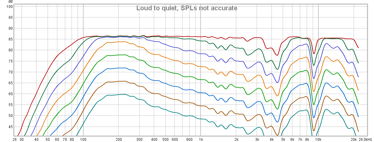

Having done some measurements on this very phenomenon, I couldn't find any evidence to support it.
I set off running sweeps at a moderate in-room level, using a Kef HTS3001SE and a Beyer MC930 microphone (chosen for its low electrical noise and high output) positioned up close.
After each sweep, I reduced the speaker drive level by 6dB. The first sweep might've been around 50dB at my ears. The penultimate sweep was briefly audible as it passed through the sensitive kHz range, and the final sweep was inaudible entirely.
As the graph shows, even though I couldn't hear it, the frequency response was essentially unmodified.

Chris I'm not understanding your graph ? The bass is rolling off higher and higher as the spl drops, and the top trace is flat whereas all the others have roll off in the treble ?
edit: unless the top 3 traces are on axis / off axis measurements and the rest are measured at the same position maybe ?

I'm saying the top two traces clipped the mic input for part of the frequency range. The unclipped sections are fine, though. With the directional mic close-up, there's some boost in the LF as expected.
If the top trace was around 50dBSPL nominal, with 7x 6dB steps down, the bottom trace was at 8dBSPL, which is probably why I couldn't hear it acoustically.
Next time, I'll calibrate the SPLs for 1m distance.
I just wanted to show that you could go from quiet to very quiet and (apart from the input clipping at the highest SPLs putting a ceiling on things) the frequency response stays consistent.

8dB ! That's massively lower than any noise floor I can achieve out here in the Essex sticks. Are you in a studio ?
As an aside, I thought the top (red) trace looked the best measurement which does go to show..... 😀
Rob.
edit: clipping your mic at 50dB doesn't sound right to me at all ? that's 30dB below 'loud talking' according to the charts (from memory? )
