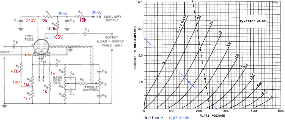

Understanding how to draw load lines
very good info thanks so please can you draw a line here according to this schematic? thank you very much
Here it is.
The left triode gives more then 16mA at 0 volts, way out of the picture.
The resistor(s) left gives, with 15k+1k5=16k5, a slope of 1mA every 16V5.Another way to draw the line :sly:
I placed a dot on the working point.

Thanks Mona you are a star, now do you think the first triode could be set better that that? I mean can this configuration work well or is better change the cathode load resistors?
Very good text thanks
That's what I am talking about, thank you very much this is exactly what I was looking for, I already read all and is very well explained with right balance of math and examples.....thanks again Rayma
Mona's load lines show why this is a difficult example on which to learn. The 12AX7 can be (and often is) abused, and still works well. The "left triode" is working way outside its design purpose, but still stays pretty linear. It's not obvious why the load line is "difficult". For learning purposes, you may want to start with something more pathological. 12AT7 curves are easily available; maybe try drawing those same load lines on a 12AT7 curve set, or a 12AU7. Easy and interesting, at least.

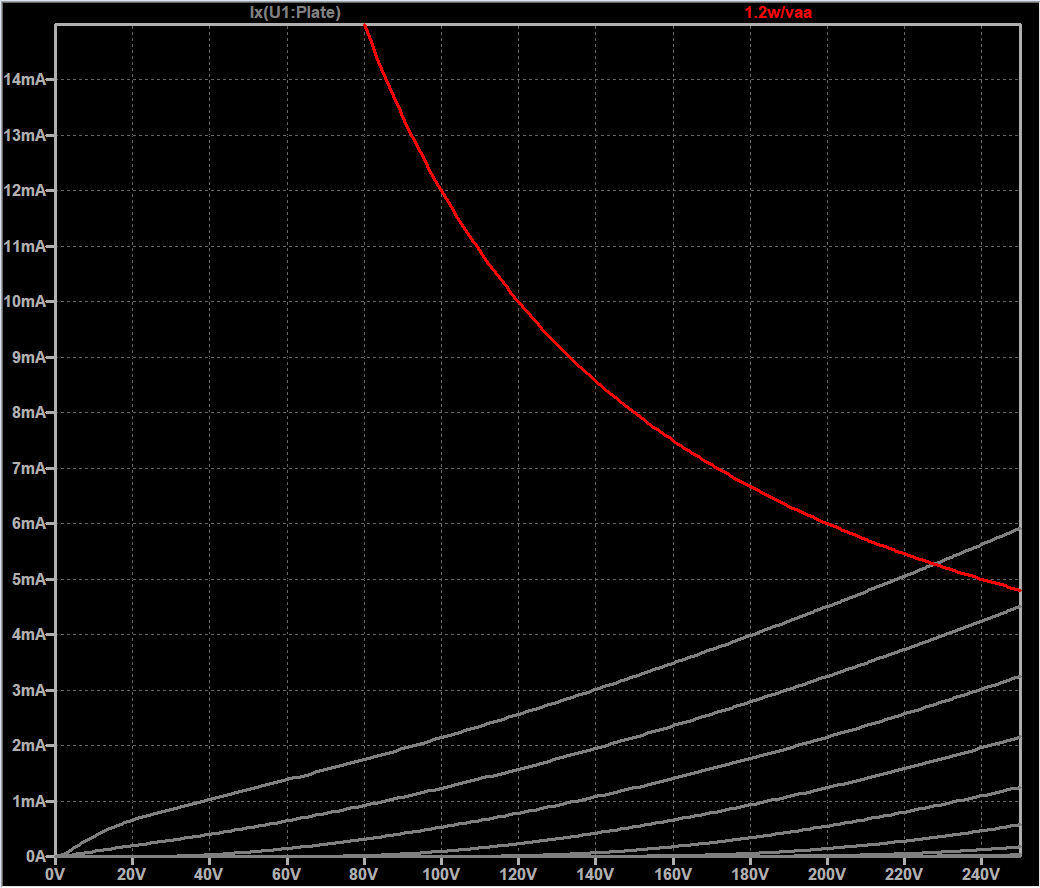

To help decide if it makes sense or I have to sim it (don't blame me abuse the simulator), I made brand new RCA 7025 model based on attachment. For OP or anyone interest in the model:

Thanks for the clarification, however, since #18 came before #22, it wasn't clear what you were trying to convey... 🙂 In any case, there were some errors in the figures shown by RCA - the cathode and the grid voltages were off for the left triode, which were verified by your sim.

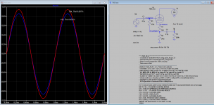

wowww great job Koonw, now things getting clearer with the help of everyone, so that mean when a new circuit is created we must take in consideration theory and practicality also so the good result is a combination of both element, because I thought the RCA circuit was impossible to work under any circumstances but after the comment of Chris #23 and the V(out) scope projection of Koonw #27 show that some tube like the 12ax7 can work quite well even out of their comfort zone.

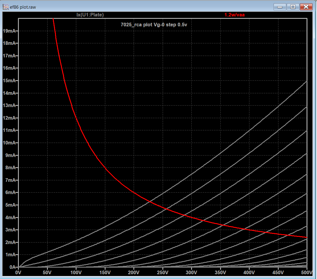

I plotted extended range for 7025 for the convenience of OP and other non spice users so that of 0V of loadline is in full view.
