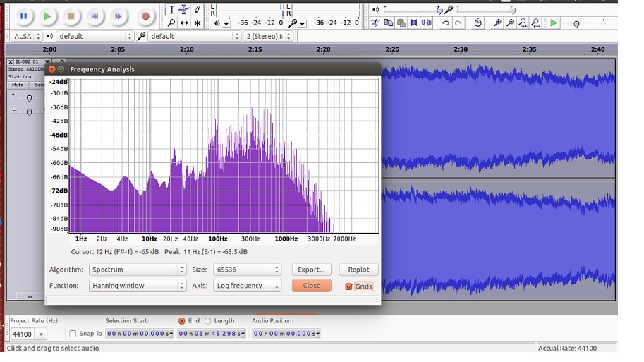

Testing speakers using Audacity
Close to completion of my bass-reflex bookshelf speakers based on the Fostex design, using a 3 inch computer speaker, I am ready to think of testing.
Installed Audacity, and opened a sample FLAC file in the window. Audacity enables playback and analysis of the file in terms of waveform and spectrum as well. The grapphic shows a spectral analysis using a high resolution and a logarithmic scale.
Incidentally, only the first few seconds of the recording were uploaded by the software, due to some limitations.
The plan is to record the output from the speakers and compare it to the waveform of the original. The microphone will introduce inaccuracies into the process, no doubt but perhaps something useful can be learned.
First a pink-noise signal will be run through the speakers and analysed. At least it will depict the limits of speaker response.
