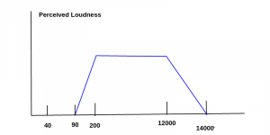

Subjective Loudness and Frequency
Continuing in the line of the title, I decided to test my speakers using the most rudimentary of all tests, the frequency response test.
After some searching I found this excellent software one that has a sliding scale for changing the frequency. Hooking up my PC speaker hacked amplifier to my now open baffle single range Radio Shack 40-1011 6 inch woofer drivers, I ran the tests.
Frequency response fell into two categories. A range of frequencies would play loudly more or less at the same volume over the frequency range After a certain point both the the higher end and the lower end of the scale, the loudness of the tone as I heard it would drop off markedly. This as I understand is called the roll off.
I was not testing the frequency response using a microphone or analyzer. I use my hearing to detect levels of loudness which is subject of course to the Fletcher-Munson curves. Still, nothing like real life testing.
The lack of bass was not too surprising considering the lack of any sort of baffle, however what was surprising was that the speaker was responding to bass as low as 50Hz which I could detect from a low vibration and hum from the speakers. This is encouraging for the future boxing day plans to place an enclosure around the speakers.
200 Hz to 12000 hz audible standard volume
Absolute limit of audibility 91 Hz to 14k
