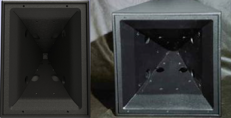

Here's what I don't understand about conical horns? What's wrong with them? They are by nature Constant Directivity, or Constant-Q. Meyer, EV, harman, all have stacks of patents on CD horns and none of them are as simple as a straight sided square, cone or flattened pyramid.
In other words, if they were so good and clearly so simple, why haven't they had use before. Meyer CD designs are even supposed to help with the nonlinearity of air. Many designs narrow near the throat or do lots of other funky things.
I agree it is difficult to understand the relationships and the pros and cons of the various horn and waveguide designs.
For example, the L'Cleach designs show how a big turned back mouth lip smooths response, yet with the typical conical horn there is an abrupt transition out to the world at the end of the mouth with no rounding.
Shooting from the hip now, I seem to recall that Webster's equations for the exponential expansion gave even loading (I so do not want to use the word "constant") to the diaphragm, the others do not. This was seen as an important design goal, so most horn designs for decades followed this idea.

The "typical" Synergy conical horns don't round the mouth transitions as much as many "pretty" designs, but the horn break is not an acoustically abrupt transition. The expanding transition reduces HF diffraction while making the horn "semi-exponential" at the lower frequencies.
If using a single HF driver down much below 1000 Hz is a goal, exponential or similar loading may be needed,(or desirable) but the Synergy concept is to use appropriate drivers and taps in the horn to eliminate the HF driver's excursion limits as a design limitation.
This allows a single source point horn that can cover a much wider bandwidth with constant directivity and no source astigmatism as experienced with "pinched throat" constant directivity designs.

.....conical horns? What's wrong with them?.....
If you want a horn that loads the bass end well for it's size, or if you want a horn that reduces the mouth transition with it's flare, conical seems to have the least in both cases.
A conical horn (especially a more narrow one) with a large roundover does resemble a number of other profiles to some degree or another. The hyperbolic profile resembles a conical horn that has had a mouth roundover (adjustable) integrated in to it.

I have never heard the Synergy, and have only had cursory contact with the Unity horns... but unless there is something very different between the breakovers in the Synergy vs the MantaRay I'd expect a problem. There may well be some very important differences. I don't know.
As far as "pretty" designs, pretty has nothing to do with the measurements. I expect you followed JMMC's thread, so you've see what I and everyone else has?
Also I think Geddes has commented on the effects of a change in flare rate between the drivers throat where it exits to the expansion of the horn causing issues. I'm unclear how or if the Synergy or any conical expansion deal with this potential problem.
