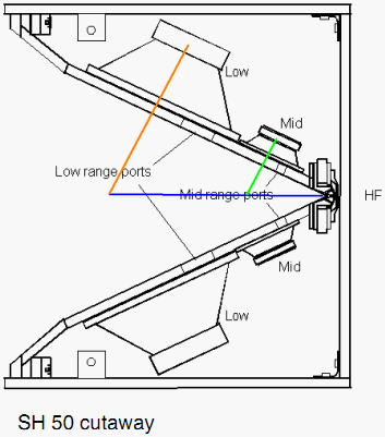

Understanding Danley Synergy ?
Looking at line-array-paper.pdf it states this
Secondly, if the placement of the drivers on the side of the horn is correct, and the crossovers are correct, the apparent source over the entire range will be the apex of the horn! By carefully designing the horn and the crossover, a true phase coherent source is produced. The Synergy Horn™ then has all the elements needed to be a close to ideal loudspeaker with no need for any external processing of any kind. Simply hook up a poweramp channel and you are in business.
In the screenie i've taken from the PDF, i've added coloured lines to depict what i'm "presuming" are the path lengths for each driver. It "appears" that the time alignment between each section, is different. Is electronic delay used in the Xovers to "correct" this, if not, how is time alignment achieved ?
Furthermore, i can see how the horn dimensions would be fine for the Mid/Tops, but for the Bass it seems extremely foreshortened. How does it manage to achieve an f3 of 50Hz ?

Also the OP was asking about the physical distance/offset between the drivers, high, mid, low and how they are maintained in phase, since the woofer (for example) is a good distance in front of the HF driver.
The OP's drawing is based on centers of voice coils, which sometimes works as a crude approximation of difference between acoustic centers, but doesn't indicate the actual acoustic centers even without a horn involved. It's a smart question even if the drawing is wrong, though.
Hey Tom, if I may be so bold, I suggest this is the question the OP needs answered:
Does the device...
1. Physically align the effective acoustic centers of the drivers into a point source right from the get-go? In that case, the crossover can keep them as such, or rotate 360° or whatever, and keep getting great results. The OP might appreciate an explanation of how their drawing should look to accurately reflect the acoustic centers. Or...
2. Physically align the acoustic centers such that while they are not actually equal in path length, it is easy for the crossover to bring them into good phase tracking on axis, and the horn is what manages to keep that working off-axis. In that case, it doesn't matter as much how the OP's drawing is off, only that they are close enough to make it work, which obviously they are. I realize #1 would also rely on the horn in a different extent, but ya know..

Yeah, but the distance between the mid and the compression driver in the Synergy is far more than 1/4 wave at the xover point of the compression driver - no doubt higher than "964Hz", therefore a smaller distance would be required.
The issue isn't so much a good phase relationship between any two drivers around the xover for flat response, as much as it is having them sum properly when looking at an impulse. If they can't do that then they can't "reproduce a square wave". I'm speculating that this may be the key to how the distances were figured out in practice. The xover's phase flip may also play a role in the spacing...

But regardless, take the relationship between the mid and woofer, the question is by exactly what means do the mid and woofer's output sum coherently given their physical offset along the mouth of the conical horn? I'd find it hard to believe that group delay or the delay/phase flips of the xover can account for the differential. The reason I am skeptical is that one does not need or see such an offset when (for example) one stacks a three-way system with individual boxes (permitting physical positioning). So why the difference?
Or stating it the other way, why don't all the drivers enter at or near the throat, as per earlier art?

Dumptruck poses questions;
#1, yes the physical / acoustic spacing MUST be held (that ¼ wl spacing or less) in order for the sources to radiate spatially as one acoustic source. With a larger spacing than about 1/3 wl, then the sources radiate independently, the mutual coupling is gone and what you get, depends on the vector sum of the two sources.
As you move around the speaker, whenever the difference in path length is N X 1/2wl, one has a cancellation notch and null in the polar pattern. In commercial sound while unavoidable using multiple sources, an interference pattern is very bad because the lobes that point out in the wrong directions (not the listening area) excite room sound and the directivity (energy in the right direction compared to energy going everywhere else) directly relates to being able to understand random words etc (and preserving information related to the stereo image in the recording).
#2, in all “normal crossovers” like those with names, once past first order, the summed output has an “all pass” phase response. That is a flat amplitude but phase rotation equal to the number of orders times 90 degrees. This places the upper and lower crossover outputs at two different times (hf first, lf later) and this can be seen looking at the Group delay of any simple crossover. Most crossovers do this and is normal behavior.
For the Synergy horns, part of the design uses the inverse spacing of the low, mid and high sources, conceptually like an FIR filter where passively, the hf is delayed the most, the mids less and lf the least to offset the electrical part.
This will not work with any “named” crossovers even without the magnitude and phase of the individual frequency bands added in. In this case, with all the drivers directly coupled acoustically, like signals through a resistor network, one cannot get away with an error or on gets a whopping big cancellation notch everywhere not just one spot..
This then requires a crossover who’s magnitude and phase is what is required to mate the magnitude and phases of each range and this is never a normal test book shape but one that is adapted to the conditions. How i do that has evolved but is certainly based on careful measurements of the real thing.

I don't understand why you guys think the path lengths look so different. Like I posted earlier, I don't actually know how the relative phase ends up, but the alignment looks pretty close already to me.
The original drawing posted ignores the actual entrances to the horn. The HF is at the back and the VC is right there at the entrance. The MF is a bit forward in the horn, but its VC is also farther out from its entrance. The LF is farther forward in the horn still, but its VC is even farther from its entrances. Makes sense, no?
Indeed i am, Thanks :)
Originally Posted dumptruck
It was
I accept my drawn lines were just an estimate.

One question I have, and it might be a silly one, is how does drilling tiny holes along the length of the horn allow the drivers to radiate properly? I mean, doesn't the hole, which can be thought of as a small pipe, have an impact on the frequency response? Doesn't it act as a bandpass and limit the max and min frequencies that will be passed... kind of a port in a vented enclosure?
Hi
Zero, this might be hard to believe, but that hf driver is already one of the top couple most efficient drivers available at any price. It is the wide dispersion, maintained up high, which forces it down. On a horn which narrowed up high, that driver can deliver over 110dB on axis sensitivity.
Keep in mind, on a CD horn, it is usually the hf drivers sensitivity in the top octave that limits the overall sensitivity.
The holes are another part of the design. You may have noticed that as you drive loudspeakers harder and harder, they get “bright” and eventually harsh sounding. Harmonic distortion starts an octave above the real signal and extends upwards by 2,3,4,5 etc times the input frequency.
While that brightness may not be objectionable, the object here is to be a faithful reproducer and one thing that means the spectral balance should not change with level if possible.
The trapped air volume under the cone and the small holes, form an acoustical 2nd order low pass filter, like an electrical filter but in air. The object being that the harmonic distortion the drivers invariably produce, will be attenuated and not enter the horn. The effect does limit the bandwidth and that is the object of it. The idea is you DO NOT want sound the driver produces on it’s own (not part of the input signal) which is always above the electrical crossover and the short obstruction does not affect the horns radiation resistance.
