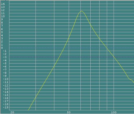

As others have suggested, a 6th order bandpass "could" achieve that one note boom ! For eg, with just one driver in 2 cu ft, see my screenie. 1.5 cu ft = back box 0.5 cu ft = front box. Both tuned to 58Hz.
