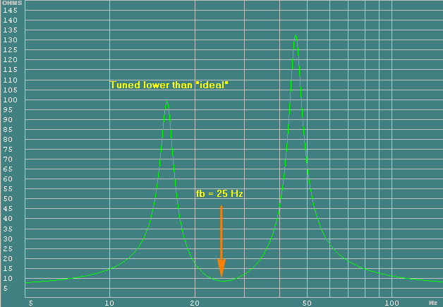

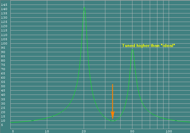

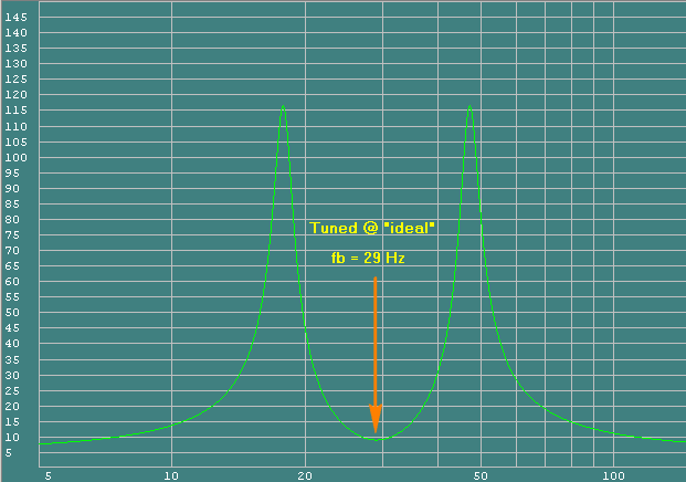

Something important to understand is exactly what the impedance curve means. A ported box has two resonances (not one!), but has one tuning frequency. As you may know, a resonance is when the stiffness and mass are equal in magnitude, yet sum to zero. You have the stiffness of the driver, given as Cms (compliance = 1/stiffness), the moving mass of the driver, the stiffness of the air in the box, and then the mass of air in the port. Think of the port as a large barrel of air that moves as a solid unit. That solid unit is modeled as a mass. This summing to zero business happens twice in a ported box, hence you get two peaks:
Fhigh: This is the higher frequency peak above the tuning frequency (your right peak). This is the stiffness of the driver's suspension and the stiffness of the air in the enclosure balancing the moving mass of the driver. This is pretty similar to the single peak in a sealed enclosure as the port is not really coming to party yet.
Flow: This is the frequency peak below the tuning frequency. This guy is the stiffness of the driver's suspension balancing out the moving mass of the driver and the mass of air in the port. The larger the port, the more mass there is. It's for this reason that not all tunings are created equal: port area does matter along with tuning.
The low point in between, as you already know, is the tuning frequency of the enclosure. While the distance between the peaks depends on the chosen drivers, the point where the minimum occurs is a function only of the box/port combination. It matters not what's driving it.
The peaks are usually at some combination of heights. When the first peak (higher frequency) is equal in magnitude to the lower peak, you get the indication that the box tuning is identical to the Fs of your woofer. When the first peak is lower in magnitude, this means the box tuning is higher than the woofer Fs. When the opposite, that is, the lowest frequency peak is the smallest, the box is tuned below woofer Fs.
When you're at a resonance (NOTE: not at the tuning frequency), all that's in play are the resistive losses in the system. High Qms drivers (low resistive losses) will give you large impedance peaks for this reason. What you're noticing, that is when you extend the port, is that you're adding more and more mass for the woofers to drive. That SPL keeps getting higher and higher as you reach the point where the suspension can no longer fully keep up with its own mass and the port mass. Once the port mass becomes too great, the efficiency falls. You're able to do this iteratively because you have 3 woofers in a small enclosure, and it takes a large amount of port mass to cancel out the high box stiffness with the driver's own stiffness. In other words: your box is incredibly stiff, so you need a lot of port mass to create that second resonance.
To put this another way, by continually extending that port, you're optimizing the system to the tuning frequency that you want. After a certain point, the driver suspension can no longer continue to keep up with the mass of air moving out of the port, and the drivers start to lose control over it. Your efficiency starts to fall at this point.
Ported boxes are fascinating things. I recommend a book, Bullock on Boxes, which gives great insight into ported enclosures. The original Richard Small and Neville Thiele vented box papers are still required reading for every loudspeaker enthusiast, in my mind.
Hopefully this helps some. 🙂

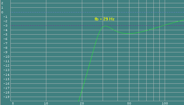

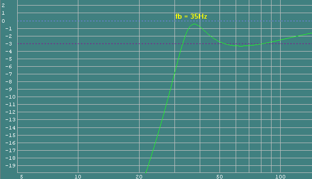

A picture is worth a thousand words, & here's 6 ! They are all with the same driver in the same box, just tuned to different fb's.
