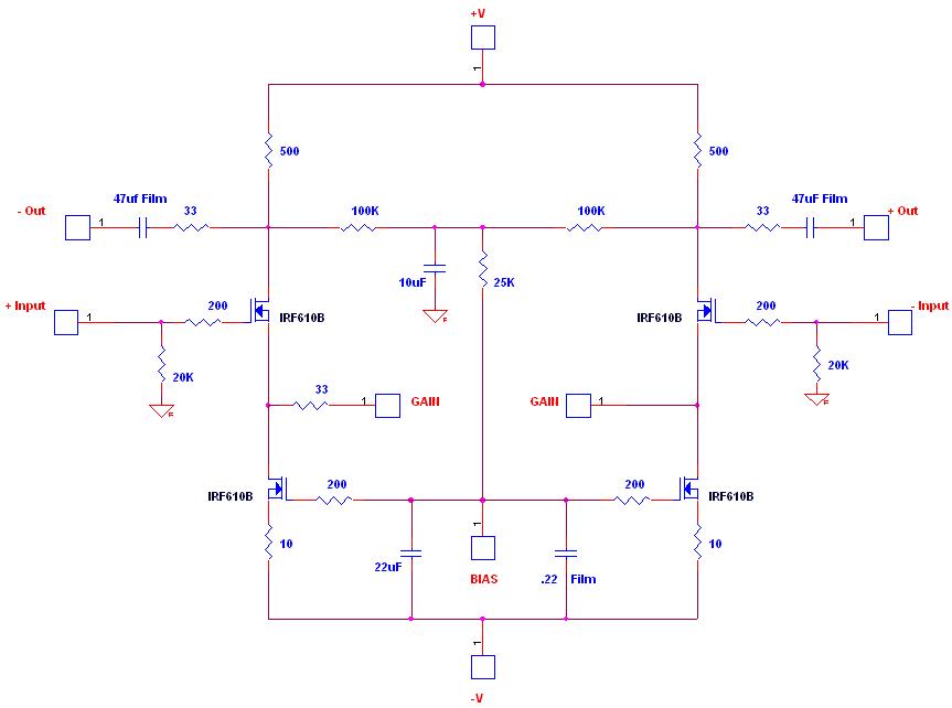

sbear, I've been looking at that design lately... My proto looses the Q15 Q18 current sources in favor of 500 ohm Rs. And, my Q17 Q20 current sources are simpler with voltage ref from the drains of the gain transistors ala the ZenV7 fig 1. It's looking pretty good so far...
Let me see If I can answer a few of those Qs... Q15 & 18 are loads for the gain transistors along with being current sources. As the gain transistors are doing their thing, effectively changinig resistance with the audio signal, the Drain Voltage of Q15 & 18 floats around to maintain the same current through these guy's. The floating around will be the output signal...

Well, my observations from Pspice with my similar preamp show something similar... If I maintain output level, the simulated THD changes very little. I can vary the Gain pot between the sources, and maintain output level by manipulating the input level and distortion changes very little. If I raise the output level 2X with the gain cotrol, the simulated THD will probably double. If I raise the output level 2X by increasing input level, the sim'ed THD will increase maybe 30-40%. These numbers are close to what Pspice said, at about 3V and 6V output, with .35 and .7V input. And the pot at 40 and 110 ohms. But it's my variation, not exactly a 1.7. And of coarse the sim'ed THD numbers were all between 0.00047% and 0.0011% @1000Hz:smash: :smash: :smash:
I suppose I should accompany this with a thousand more words...
Well, Missing in that pic are the +80 Volt and -20 Volt rail. A Bias pot to set the 100mA per side Iq.. Assorted bypass and bulk caps.. And the R we speak of,,, probebly a 1K here... Oh yes, and FeedBack..😀 😀 😀
Well, probably very similar to the 1.7???
