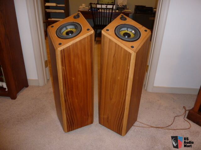

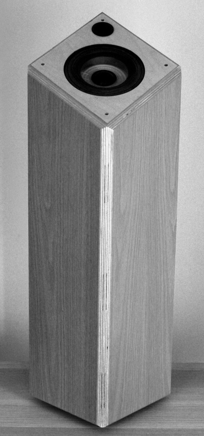

At this point, I'm thinking of assembling a tweeter + mid on top baffle angled as in the Larsen 4 (or maybe the 6) + a side firing 8" or 10" woofer on the inside panel, near floor/wall intersection. The 4 presents less of a challenge for my woodworking skills.
I would probably position the mid driver to clear the flange around the top of the tower -- if only to reduce diffraction effects. Thick felt or similar around the sides/back of the drivers might also be useful.
A triangular cross-section tower might make the construction simpler. The top baffle would then tilt away from the inside panel of the tower without discontinuities. (Just thought of it so no drawings...)
With these Larsen designs, the mid/treble directivity is reduced nearly to just 1/8 sphere, focusing most of the total acoustic energy toward the central area between L & R speakers. I suspect the steep upward angle is to compensate at least partly for the low height of the tower. Height, including the top driver assembly, is just 73.5cm or 29". Of course, there's also the benefit of reduced floor bounce effects.
With only one tweeter angled this way, I expect the measured on-axis FR has to have an upward till to compensate for higher freq. beaming.
The ceiling is also brought into play more prominently as a late reflection boundary. It probably explains part of the spatial performance the reviewers all refer to. My studio has a ceiling of "50% absorbent" tiles + 12" of fiberglass insulation. IE, considerably more absorbent than in most rooms. I wonder how that will affect the overall sound.

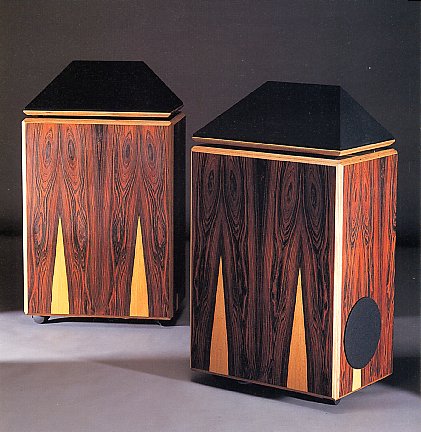

There is a US made loudspeaker that does similar things, the company name eludes me
shahinian acoustics
http://www.shahinianacoustics.com/
thanx @djn
dave
Thanks Dave.shahinian acoustics
Interesting but weird, and very dated looking web site. The designs look like they haven't been changed for years, too. The smaller models look similar to the Larsens, and the Compass & Starter models are similar to what I described in my last post in a rectangular tower. I'd be leery of the bigger ones. I am not seeking to make an omni.
Compass -- no mention of placement, though the web site shows them far from walls. If that's the way they're meant to be placed, not what I'm looking for here.

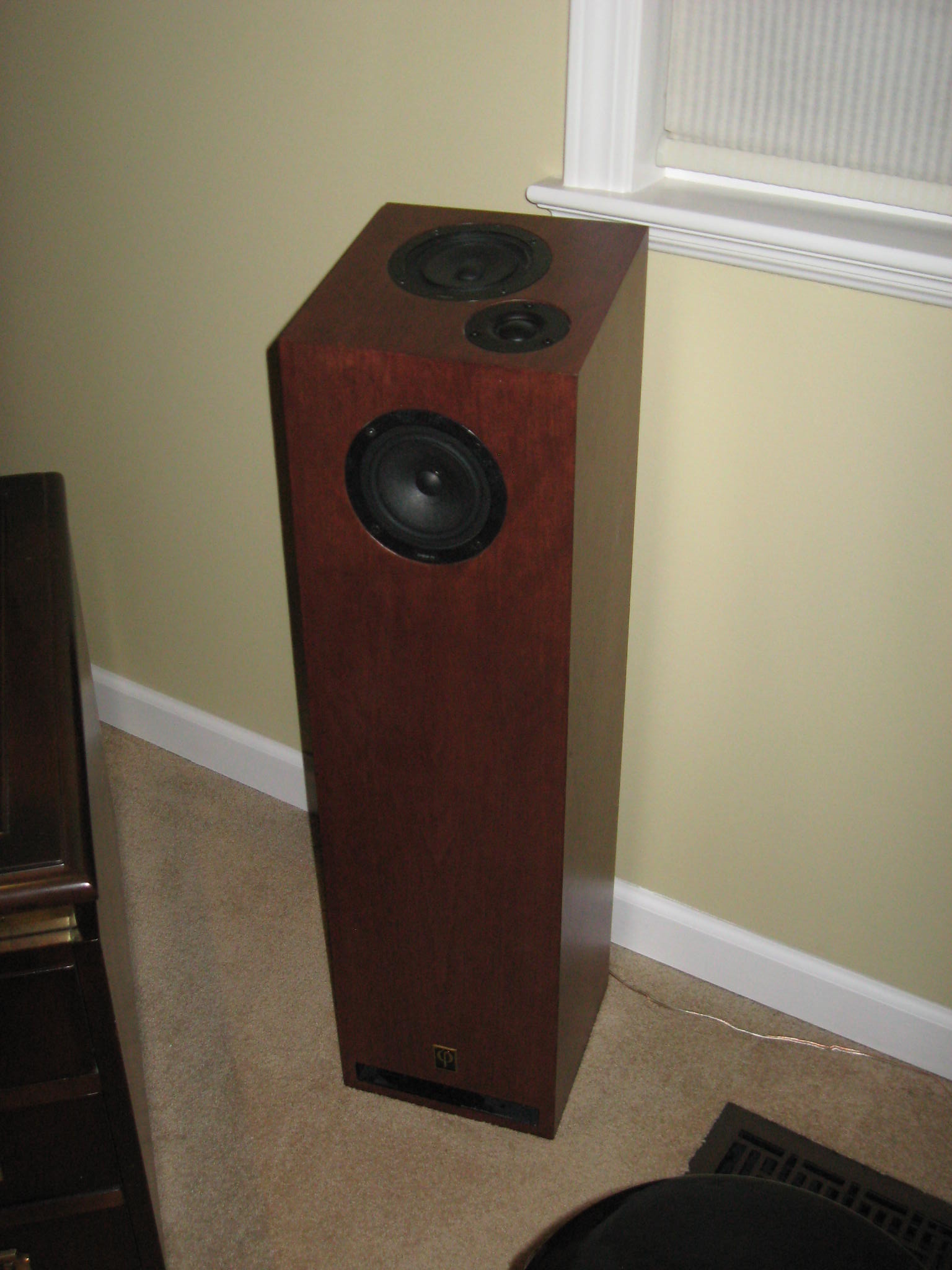

Stigs OA-52 sounded very spacious in his last listening room (very high ceiling) driven by ML amps and and a Bremen Licience No1 D/A - I heard it numerous times and it all sounded really good.
I also owned a pair of OA-52 for more many many years. Stig Carlsson was a somewhat mysterious man but it was always very interesting to visit his apartment where he also did the development of the OA--5x series. Strange 4-way prototypes loomed behind curtains ;-)
Not me. An omni would radiate in 360 deg if placed out in the room - like a Walsh. Only one Carlsson do that and it would be the OA-14 as I see it.Which is the class i would put the Larsons into.

Since no one here seems have have any significant hands-on experience with the Larsens, I've decided to forge ahead on my own.
I studied the idea of a triangular cross section tower for a while --
This idea has been set aside, because the end result will be too much like a corner speaker. I don't intend for it to be in a corner or address questions about why the sharp 45 corner edge is sticking out into the room.
Instead, I will copy the look of the Shahinian Acoustics Compass (I posted a pic above) and make the lowest corner of the diamond-shaped top baffle the inside corner of each mirror-image pair. It took a little puzzling to figure out how to cut the 4 side panels to make a 45 degree angle across the top starting with a corner. I realized that it's actually a 22.5 degree cut across the top end of each side panel. Haven't drawn it yet but I'm pretty sure this works. (LMK if you think this won't work!) (Just in case, will try with carboard first.)
Max height at the top will be 36~40", with the tweeter centered a few inches below, which seems about right. If an 10" square cross-section tower is used, the widest portion of the top baffle will be 14.14" -- more than enough for any mid driver. It might be better to go smaller -- perhaps 8", though this might make the enclosure volume too small if I'm going to make it a 3-way with anything bigger than 7". Assuming at least 5/8" thick panels, a 36~40" tall 8" square tower = 25~28 liters or about a cubit foot. This should be enough for the right 7-8" woofer. But then some space is needed for the mid driver. I haven't thought much beyond the 6.5" Seas driver I used in the last project. Hmmm.
It might mean just staying with a 2-way for this implementation. Go for something more ambitious next time. The close-wall reinforcement should make its bass better than in the pentagon LXmini tower anyway.
One question is whether the panel that rises up beyond the drivers in the Larsen 8 and 9 is absorbent or reflective? I refer to the portion of those speakers that go up against the front wall. My hunch is that it is partly or mostly absorbent to reduce diffractive reflections off that wall...?
Any suggestions or thoughts?
