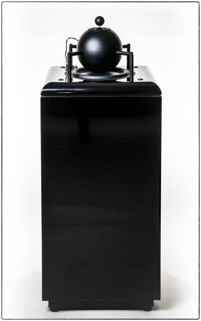

A few of you know that I have a strong interest in developing a modest cost speaker system that sounds good placed against the wall. Coming from successfully cloned Linkwitz LX521 & also original spec Linkwitz Orions, this might be a tall order, as full-bandwidth dipole imaging is difficult to replicate. I started a thread/project to combine quarter sphere (pi) bass with dipole mid/highs a while ago. That effort morphed after an acceptance of defeat, into an examination of the Linkwitz LXmini -- which I made a variant of using different drivers & construction. The resulting pentagon tower is actually a good sounding inexpensive speaker (not including the cost of 4-ch amp and 2x4 HD) but still needs the 3-4' distance from the front wall to achieve ideal performance.
I'm still trying to figure out how to get the consistent bass response of a near-wall floor stander with excellent imaging.
Yesterday, I came across the Larsen speakers.
This is a loudspeaker line that comes from the Ortho Acoustic concepts of Stig Carlsson & John Larsen. Larsen's about page provides a summary.
The Larsen 4, 6, 8 & 9 are all smallish floor-standing mirror-image pairs designed for close-wall placement. Each features a mid/treble panel atop the tower that's angled up and inward. It looks like 45 degree in both planes. The large 8 & 9 models feature an additional side firing woofer close to the intersection of floor and wall, like the NHT 2.9 I once owned & inspired me. This config is certain to increase the perceived bass output in most rooms.

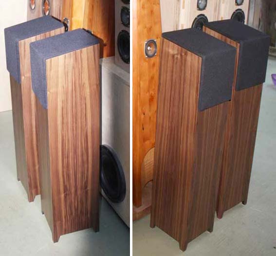

Pretty good. Right up against a wall they need more damping in the line or you have excessive bass. Many have been done with angled tops to further tune the room response.
The castle was specifically to be placed closer or even against a wall, the original has drivers front 7 back like the original EPI microTower.

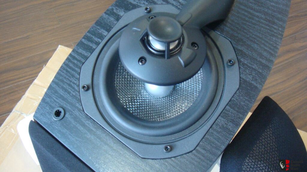

The angled midbass means more HF reflections. The 2 upward tweeters give sufficient energy off the ceiling and wall to give sufficient HF energy. The wave-guidish thing over the 3rd tweeter is different, there is an explanation of how it is supposed to work in the Stereophile review.

The microTower is an idea to leverage off of. You can angle the top, there is a a section in the planset.

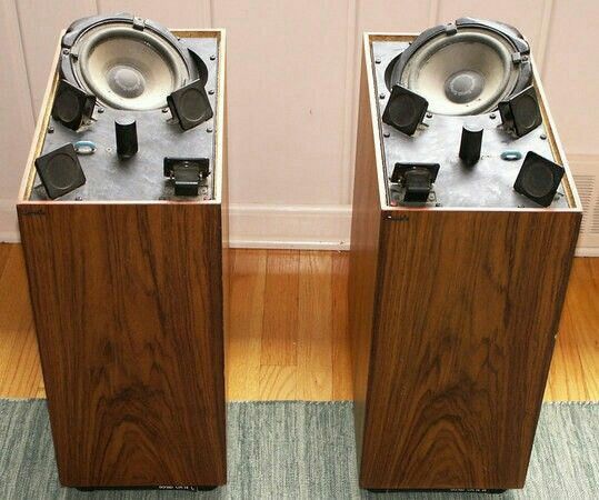

I think one secret of Larsen and Sonab speakers is they act efficiently due to reinforcement by two walls, i.e. floor and back wall.

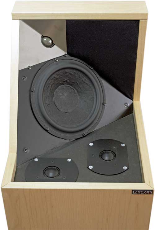

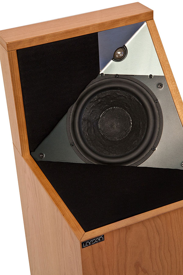

The most puzzling part of the current Larsen 8 & 9 designs is the metal plate that divides the primary dome tweeter in half. It's not clear whether the hidden half is exposed to the back... or blocked with damping material? If the former, that energy would bounce off the back and side walls. All this, presumably, ends up in a linear power response curve in room.
I have Peerless 10" SLS drivers that could serve as woofers. 6.5" aluminum Seas drivers, also used in my pentagon tower Lxmini copies, would be suitable for the mid. For the primary tweeter, I'm considering a Wavecore waveguide 30mm that could be crossed quite low (maybe 1.5khz) with somewhat narrow directivity, or if wide dispersion is important here, any of several 25mm domes on hand. These mostly have to cross 2khz or higher, though the FR of the Seas 6.5" droops >1.5khz. Compromises. As for the other up firing tweeters, I guess I would have to try them, but would prefer to avoid them if possible. Instinctive bias, possibly unwarranted.
So reasonably suitable drivers are on hand to try a Larsen-ish clone.
Still want to hear from at least one user of the current Larsen models.

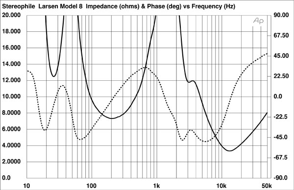

https://www.stereophile.com/content/larsen-hifi-8-loudspeaker-measurements
Fastened to the upper corner of the angled baffle is a stainless-steel plate, made with a round opening just large enough for half of the tweeter's dome to show through, and folded at an angle of about 135°. It seems that this plate both prevents waves propagated by half of the dome from reaching the listener and reflects at least some of the output of the unoccluded half; according to the Larsen HiFi website, this arrangement helps the Larsen 8 to reproduce upper octaves "with more body" and contributes to "a more linear frequency response."
Really ugly impedance curve.

I saw that mention about the metal tweeter divider in TAS review; still not that clear. I'd love to meet Larsen and/or his engineers for a detailed discussion!
Seems to be an acoustic lense. Similar to the Karlsson design with big drivers you get better dispersion. The "main" tweeter gets better dispersion. The other ones are for more reflections from the walls due to being pointed to other directions.

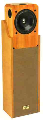

Mr Pfleiderer who made his Pfleid loudspeakers has put indirect reflecting tweeters on top and sides of his FRS loudspeakers.
First one is a bookshelf design the other a floorstander, all with indirect reflecting tweeters (loudspeaker history, long out of production)
The plate acts like a waveguide to shape the high frequency radiation pattern as does the felt/foam. My guess (and it is only a guess) is that the present form was adopted because after splitting with SSC as their manufacturer (if I understand the situation correctly) the new Larsen design would have to be clearly different to the OA52. I doubt there is an opening at the back because these speakers are meant to be placed against a wall which would block it.
The Larsen speaker stereophile reviewed has what look like addressable engineering issues. The response from the manufacturer and the marketing material do not seem to be that of an engineer or at least not an acoustical one. Carlsson on the other hand did appear to reason like an engineer and the OA52 for example does not seem to have similar issues even using drivers from the 80s. It is a speaker I would like to hear but I have some doubts about the degree of spaciousness it may be able to provide which is my primary objective (others likely have different objectives as do I in the main system). The stereo imaging is likely noticeably better than the Sonab's from the 70s which I suspect may have been been a significant factor in the design. There's always trade-offs when it comes to the physics and engineering (not necessarily reflected in the marketing and myth building!) which is part of the fun.
