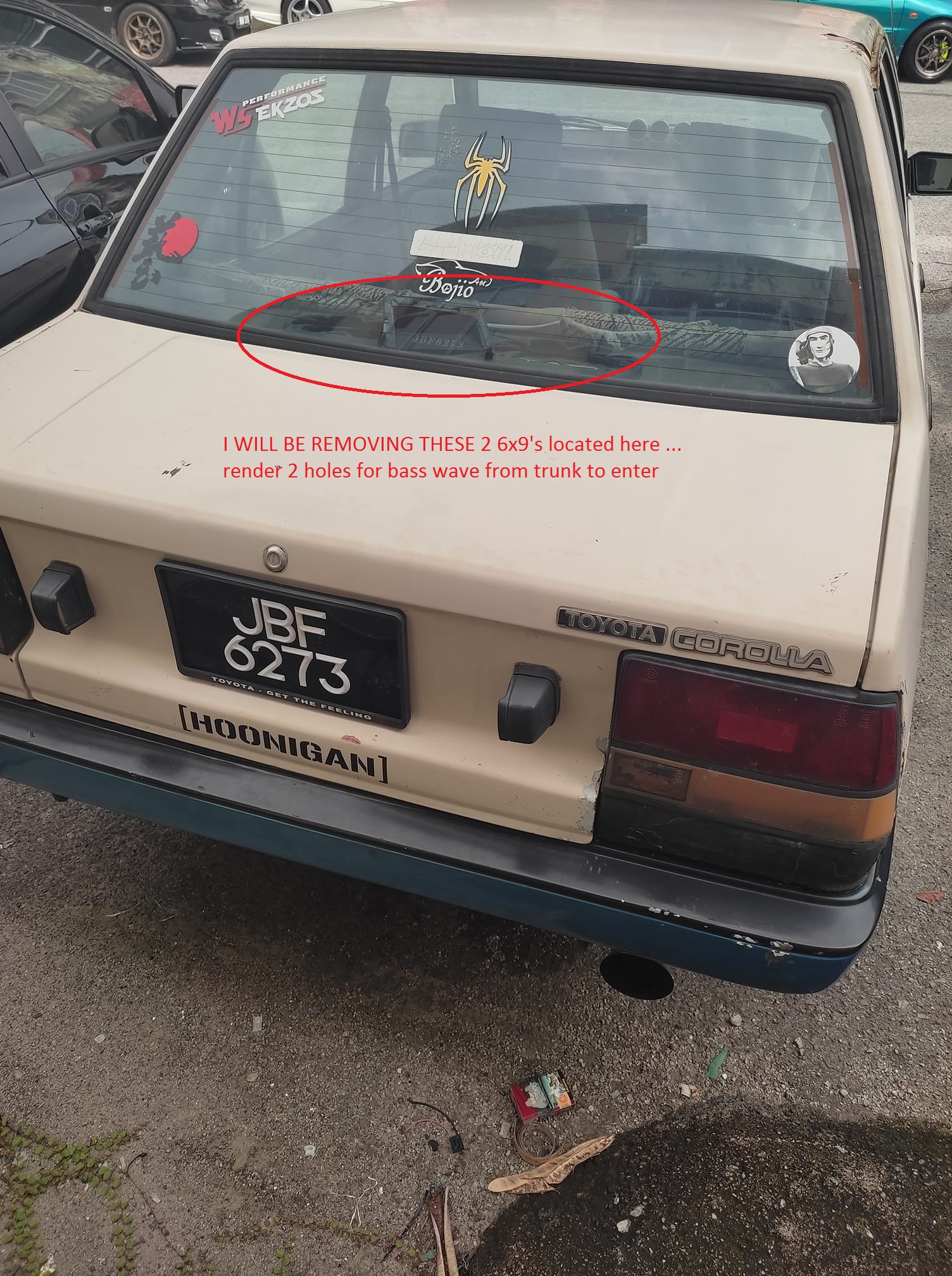

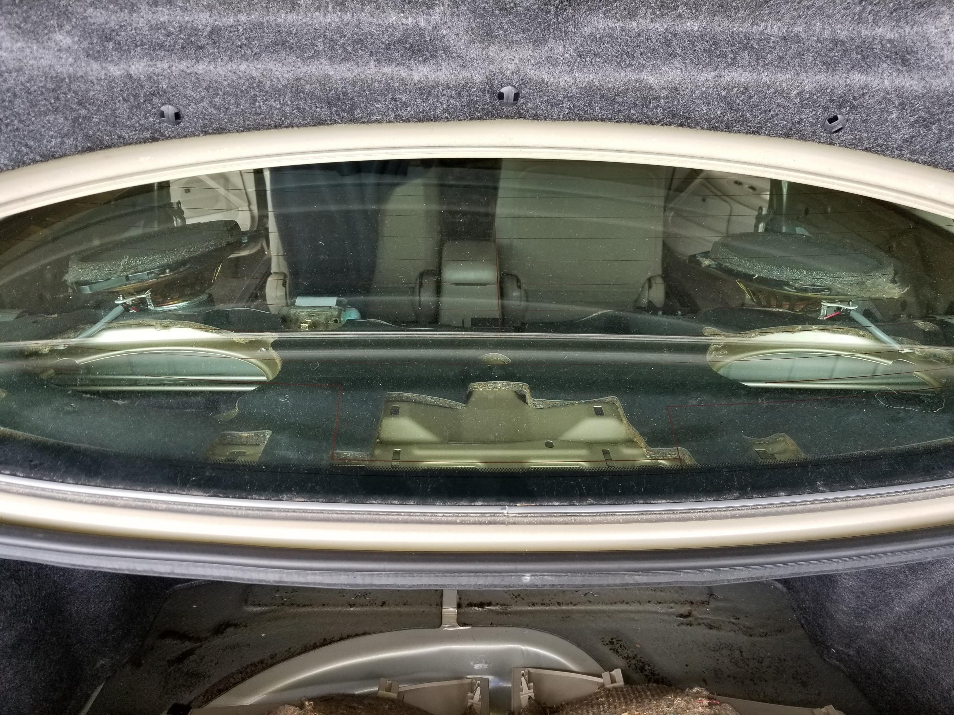

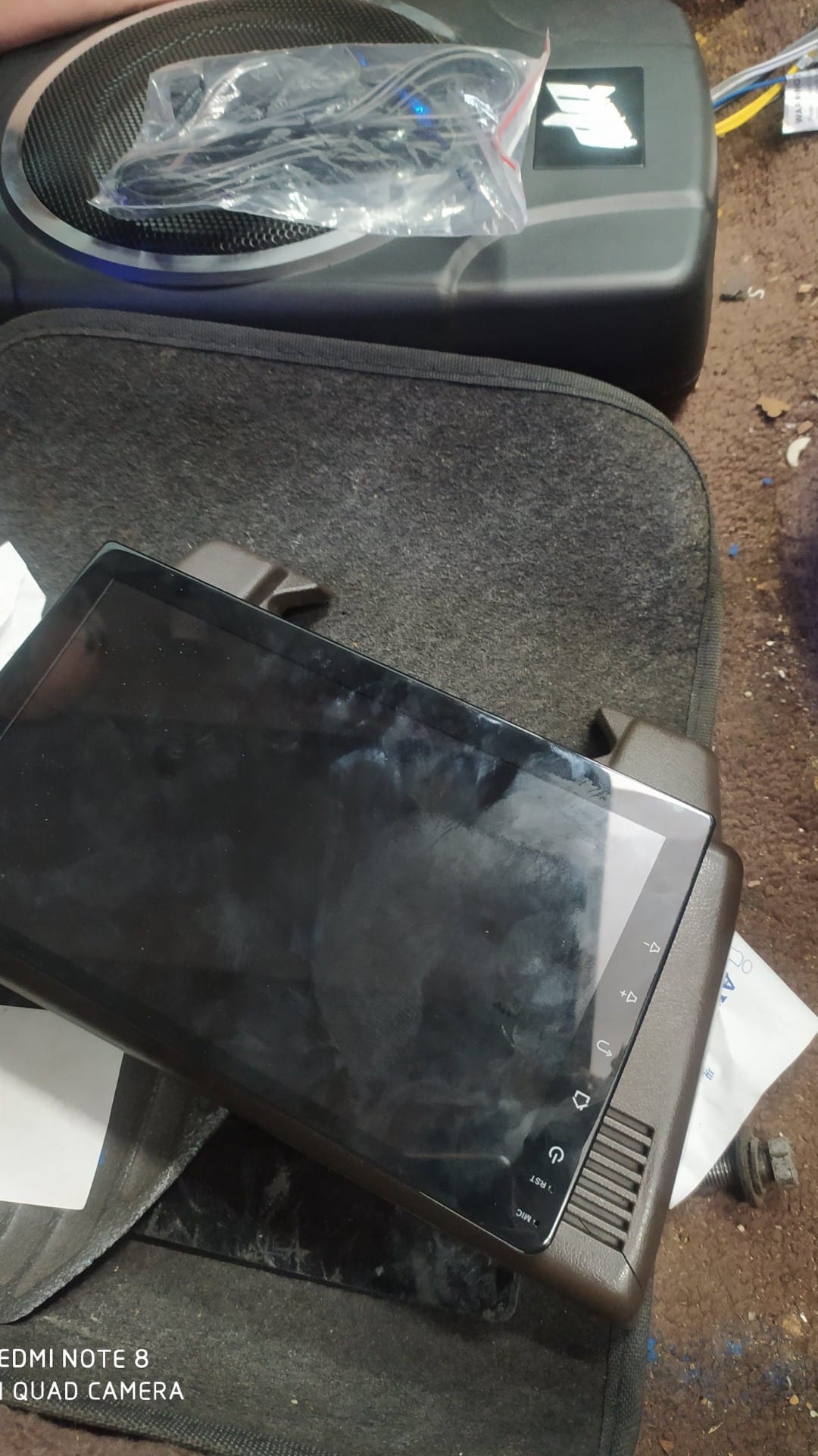

Recently an alternator failure overcharging blown my dynaquest underseat subwoofer render it out of service ... now i am looking for a replacement ... i have 2 choice now ... a replacement unit for the underseat unit or a rear trunk mount conventional subwoofer unit? if i am going for the rear trunk unit i will remove the 2 units of 6x9's to let the bass enter the cabin easily ... and if is trunk mounted unit i will go for double 10's ... but a question here if i am going to remove the 6x9's (shown in picture and FYI those speakers were not working/BLOWN and no point keeping it on the rear tray) to let the bass in what else alternative can be done for the rear channel speakers? my previous car projects doesnt deliver promising bass with any speaker on the rear tray blocking the bass waves into the cabin. The rear trunk of this old car is isnt very big
or another option here is after i removed the 6x9's ... i will PORT the box into the cabin which is the listening area while another port fires into the trunk ... will that work too?
if i am going for the underseat replacement same unit and model it will be just a plug and play job but the bass level doesnt meet my satisfaction.

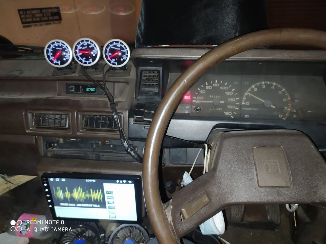

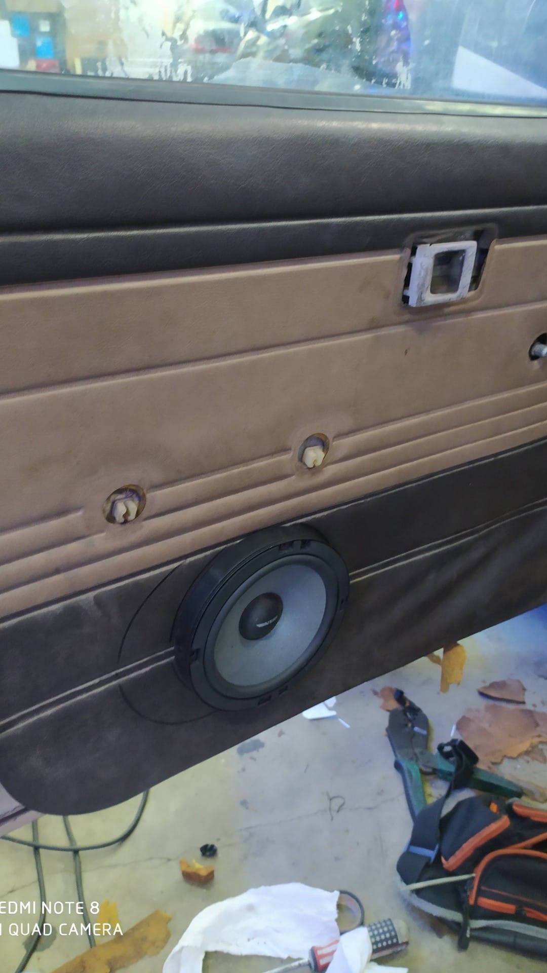

current setup = 6inch component door mounted speaker tweeter dashboard mounted and underseat subwoofer + Android multimedia player

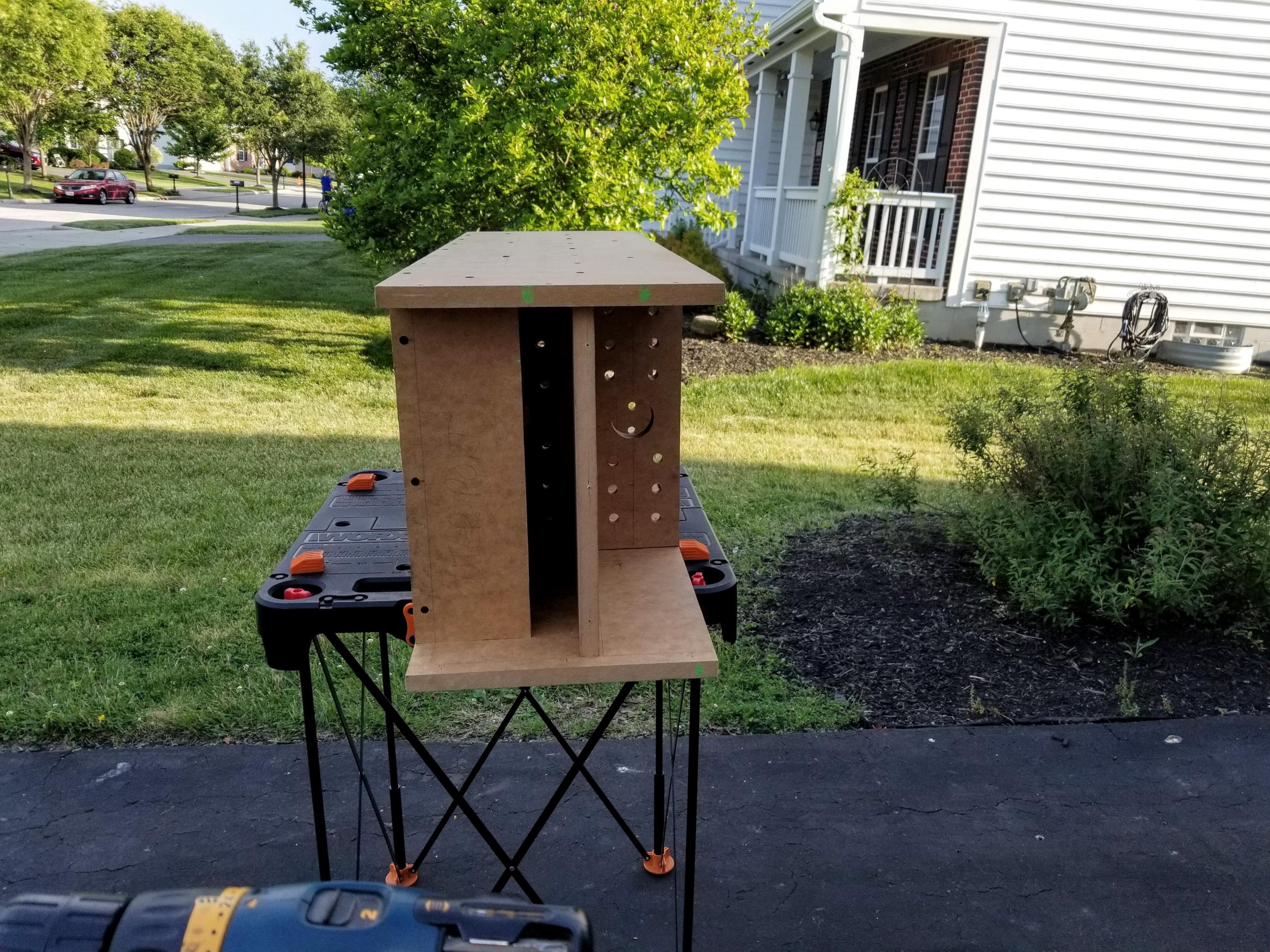

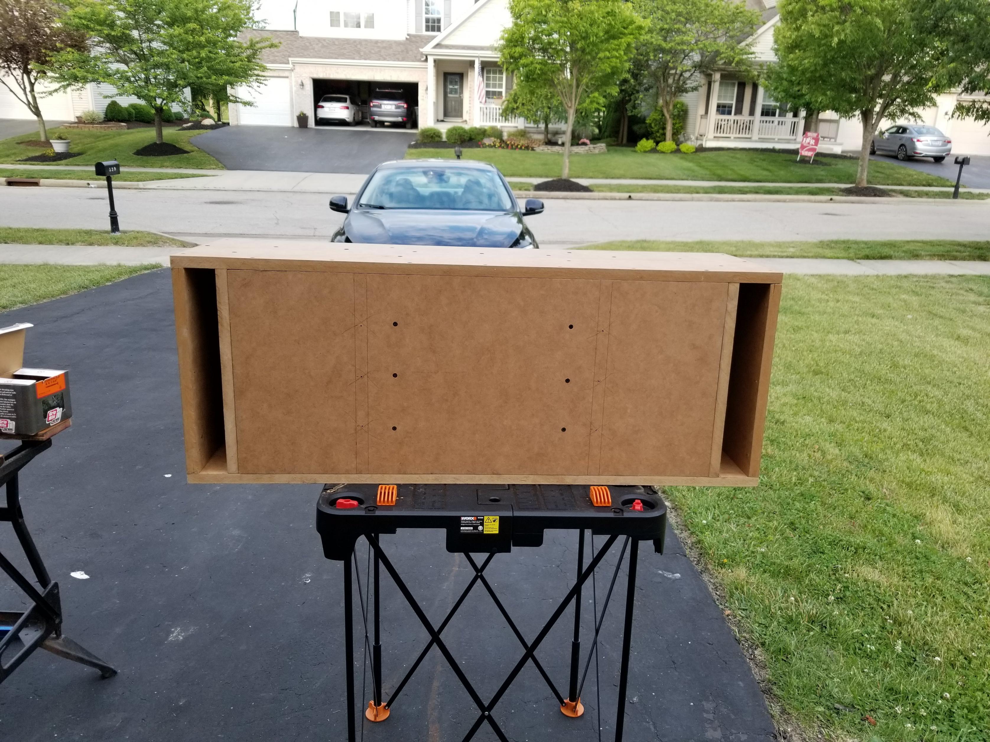

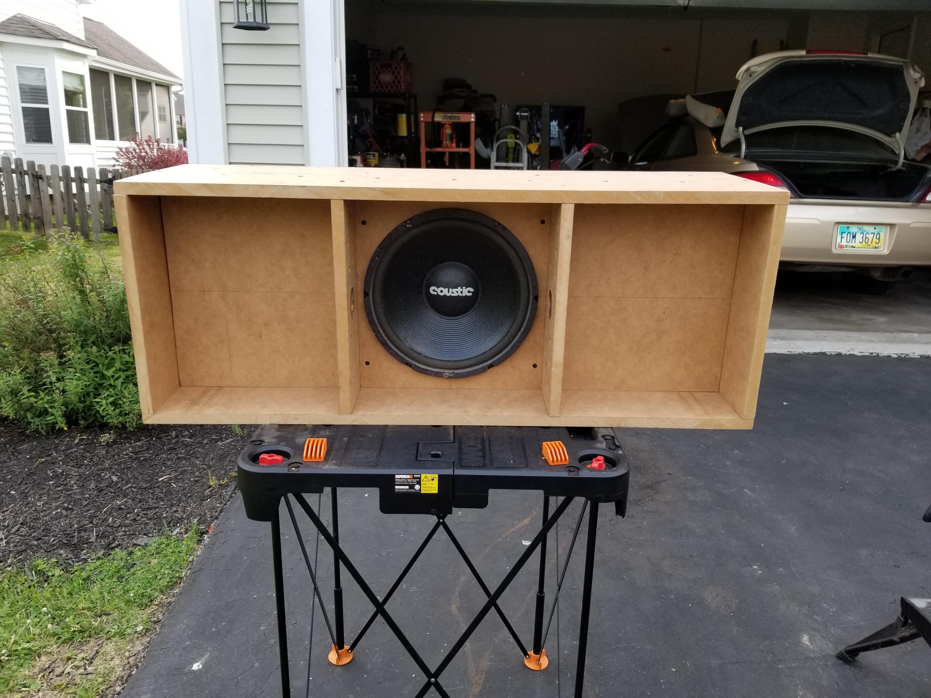

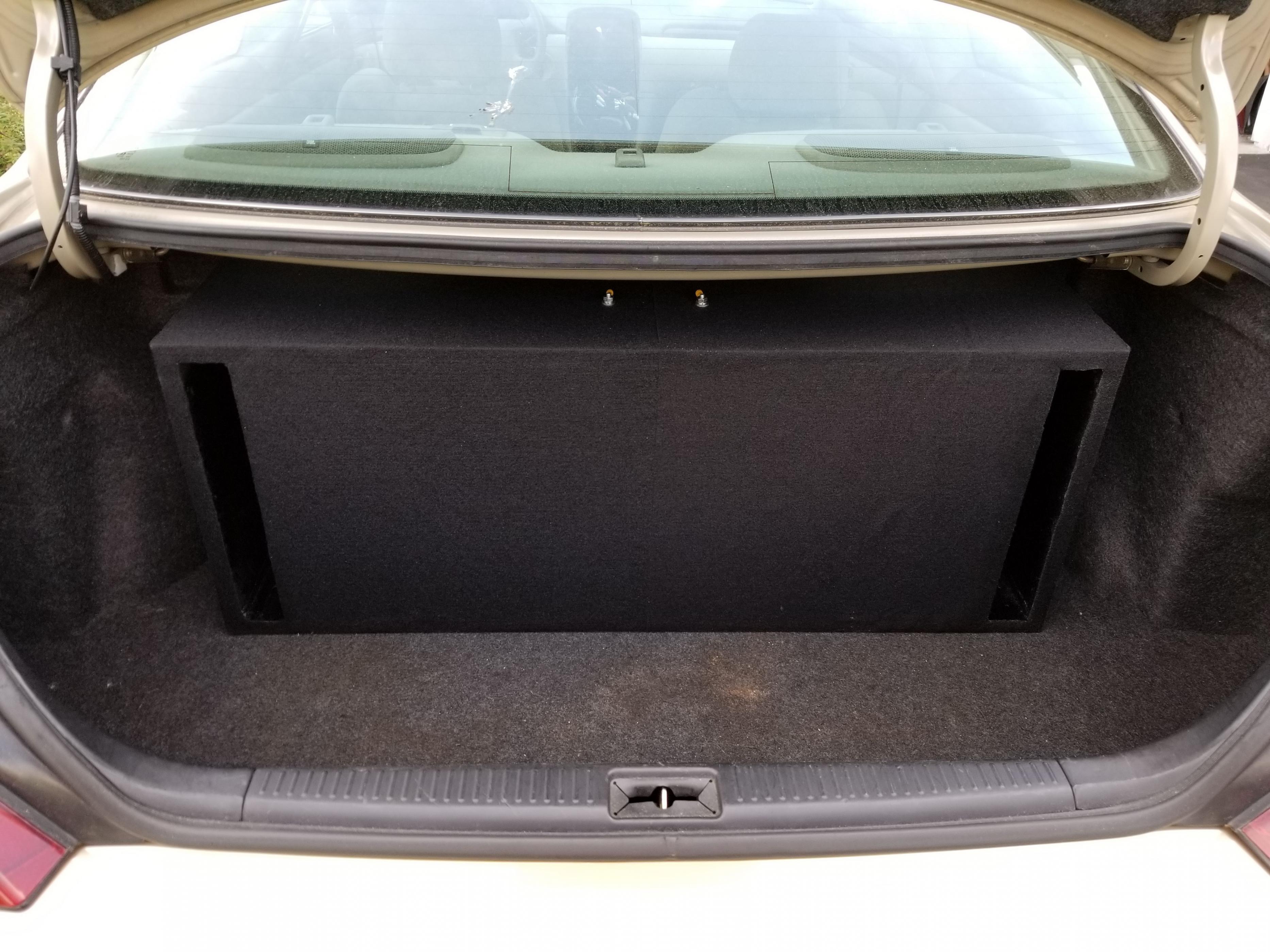

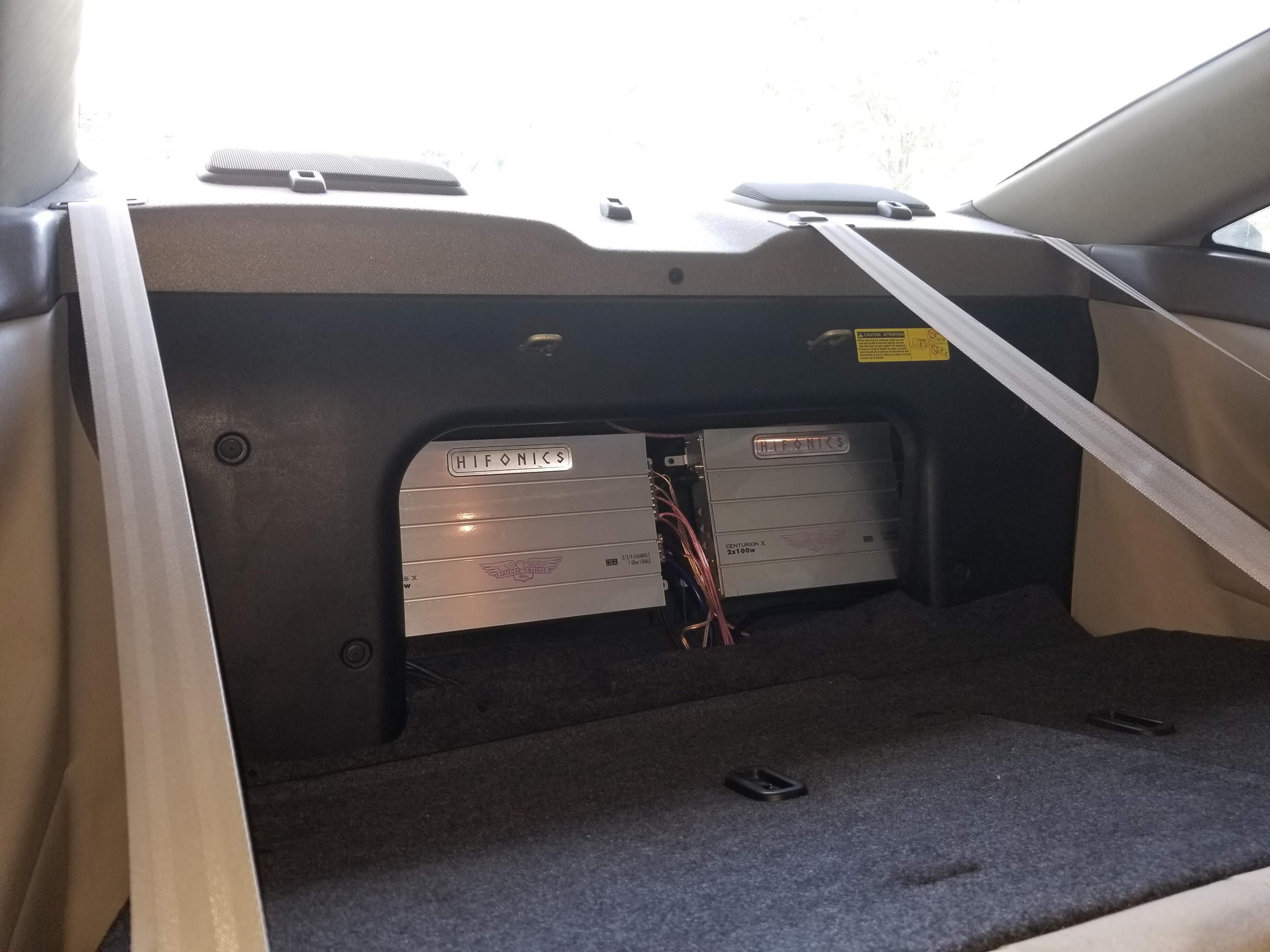

I removed the factory 6x9's and let the bass vent thru the openings.
Porting the enclosure thru the 6x9 openings will work too.
You need to calculate the box size / tuning, based on the Thiele Small parameters of the woofer. Counterfeit woofers usually do not come with a data sheet with those parameters. You could measure them yourself, it is part of the loudspeaker building experience. 😀
your subwoofers were upwards firing facing the hole into the cabin?
No. I'm letting the bass vent through the rear deck so I don't have to fold the seats down.
It's a BP4 enclosure firing towards the bumper.
I thought about venting the enclosure thru the 6x9 openings, but I didn't want to deal with the complication of installing an enclosure with external ports into the trunk.
