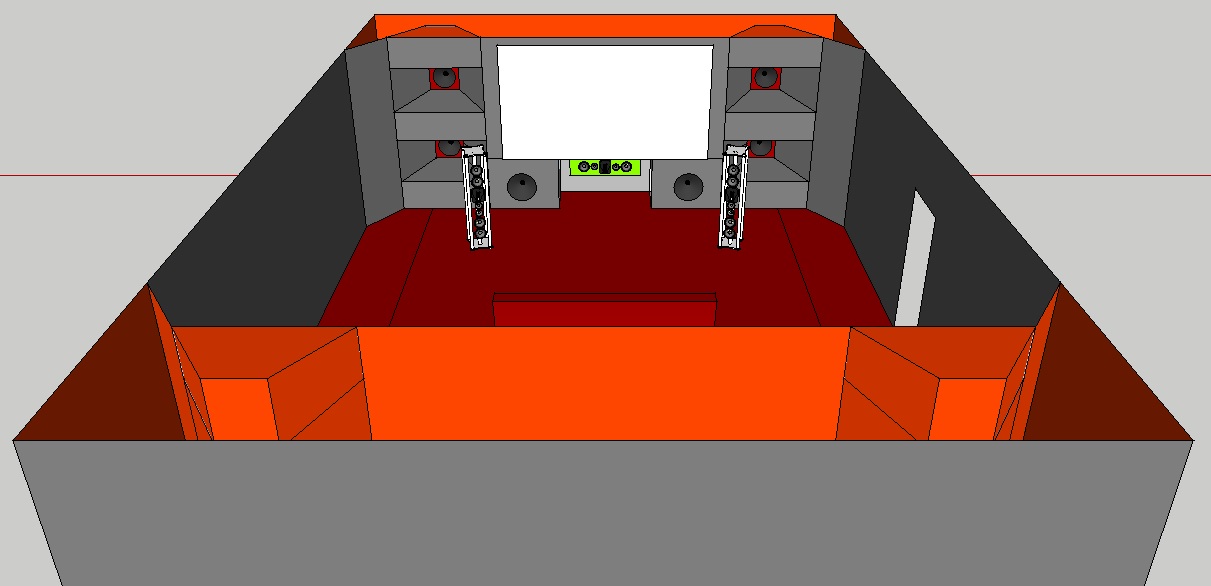

You need to separate front and back sub arrays to different back spaces with DBA, because back array is driven with inverted phase. With same back space to all drivers you wont get any output from sub, because of acoustic cancellation.
I guess DBA theory is based to rectangular room, so no one cant predict how it works in that shaped room. Probably still better than some other system.
Keeping the back space separate shouldn't be a major problem.
I have reworked the room a bit to restore a more rectangular shape and get the size down a bit. Current rendition is 12 meters long by 8 meters wide.
It means having to use a combination of back space and some under slab space to cut 2 meters off the width.

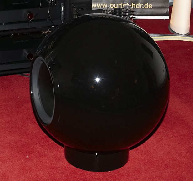

I use 15" LMS15 in a small EQed CB (global shaped, monolithically cast concrete, see pic) driven by 1500W@4Ohms class-D modules and it seems this power is just sufficient. The 18" requires more, something like the afore mentioned Powersoft 3.4kW module.
500W is what I would try with a 12" driver.
All that of course with the idea of home cinema in mind. For home hifi I´d accept less powerful amps.

The concrete casing, the sperical shape and the momentum-cancellation are so effective that one can´t sense any vibration of the casing by touching.
Probabely the ´quietest´ commercial Subwoofer.
