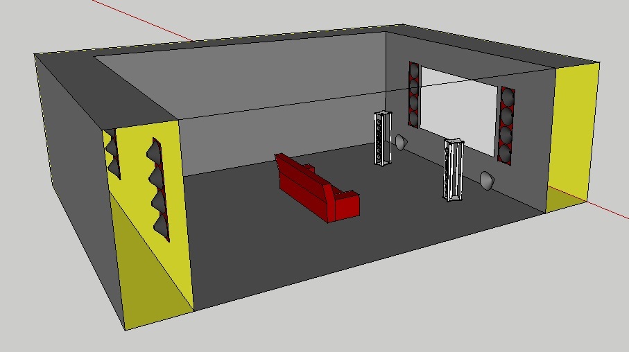

I was originally going to mount my TC Sounds Pro 5100s in a couple of H baffles, but why not make some use of the wide wall for baffles, and run 4 TH boxes along the bottom front?
Just thinking I don't really need to limit myself to either IB or TH, why not both...
If you're going to build such an extreme build then you might consider to use twice as many drivers and slot mount them where one is reversed. This would reduce driver significantly distortion and cancel mechanical forces. Your house will thank you when playing lots of LFE content 😉
There is a thread about this, also some information on Linkwitzlab since he uses the technique himself a lot.
If you go this route you could compensate by using smaller less fancy drivers since the strain on each driver is reduced.
Yes that runs along the same lines as the dipole woofer Dipole Woofer. I was quite interested in this design a while ago, but now that I have a bit more freedom a couple of PPSLs along the front might be quite nice.
like that,but since you have the space behind ,why not simply ib.Just added in some main speakers to get a better idea of where to place the subs, and find a good location for the 4th channel in the mains (TC Sounds Pro 5100s).
Yeah that's the plan, If I did TH for the sub frequencies, and IB for the lower bass frequencies, both can exist in the same cavity space without causing problems.

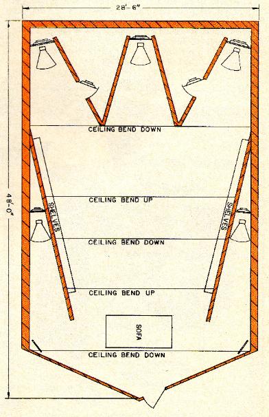

What a great project, one more vote for IB from me. I would recommend multiple IB subs based on the work discussed here: http://www.diyaudio.com/forums/subwoofers/134568-multiple-small-subs-geddes-approach.html , and (if necessary) additional sealed filler subs.
On the other hand, I like your initial horn ideas, take a look at this system: Dick Burwen's Sound System

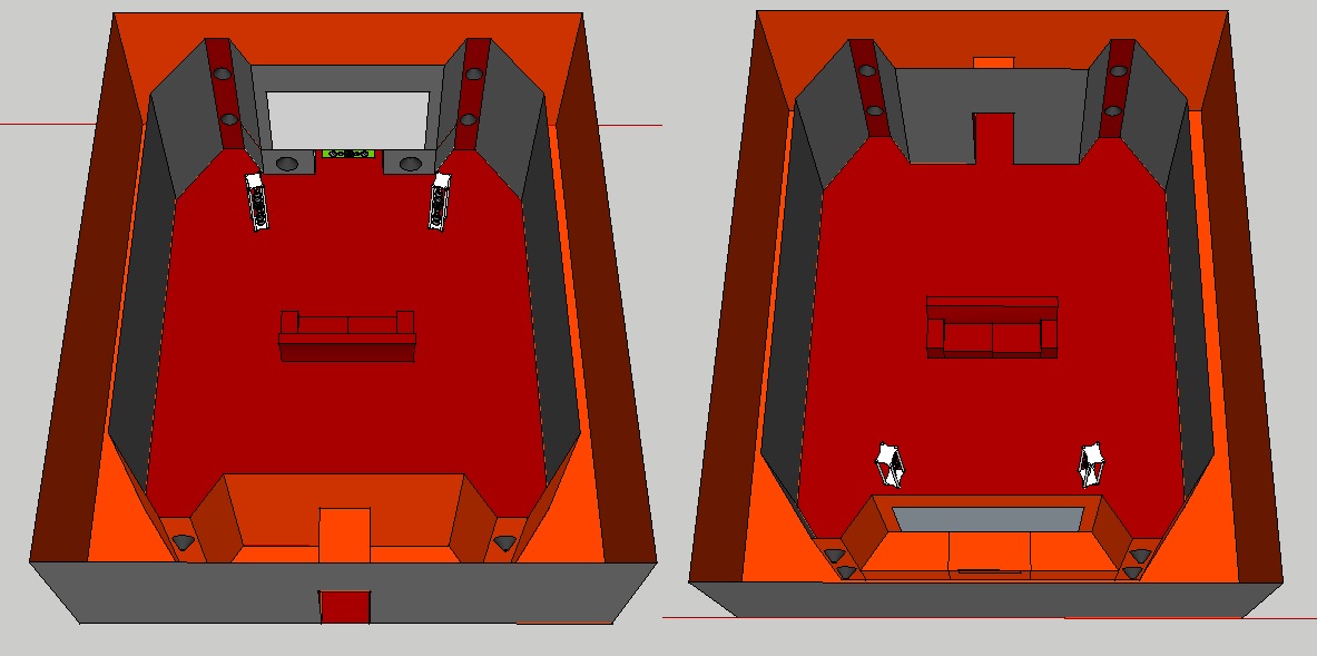

Currently I think I am trying to serve too many masters… Some really good suggestions have been put forward, but there is no way to implement everything. For example bjorno’s suggestion of a symmetrical double bass array, is polar to tb46’s suggestion of following the Geddes approach with random placement.
So it does make an intelligent decision very difficult as they all seems to have their own merits. So this is what I am going to do. I need to think about the room as a complete solution… i.e. what solution works well with OB mains? So here is how playing out
In the mains I have the dipole tweeters, with dipole mids and dipole mid woofers. I was going to put the 18” TC Sounds Pro 5100’s in a H baffle, but now I am very heavily leaning towards placing them flush in the front wall behind the mains to give the maximum baffle area and create an IB out of them. They would be run as low as possible as per the Geddes approach of both mains and SW down low together.
For the subs I am leaning towards quantity over quality, as in I will be looking to use more locations, over using dearer drivers like the TC Sounds drivers in smaller quantities. This leave me with one final decision and that is the cabinet type for the subs. Both TH and PPSL look like good candidates for the sub role, as neither will interfere with the IB woofers, if they don’t transmitted sound waves into the IB rear cavity, and have a better chance of playing lower than IB subs.
I do like the PPSL over the TH for the 2nd order cancellation, and being able to make use of both sides of the drivers. If that seems like a workable solution I would like to move onto driver recommendations for the subs.
I have also been thinking about switching the room around the other way (bigger width than length) to fit in the DBA and still retain screen size, but from what I can see that is acoustically less desirable.

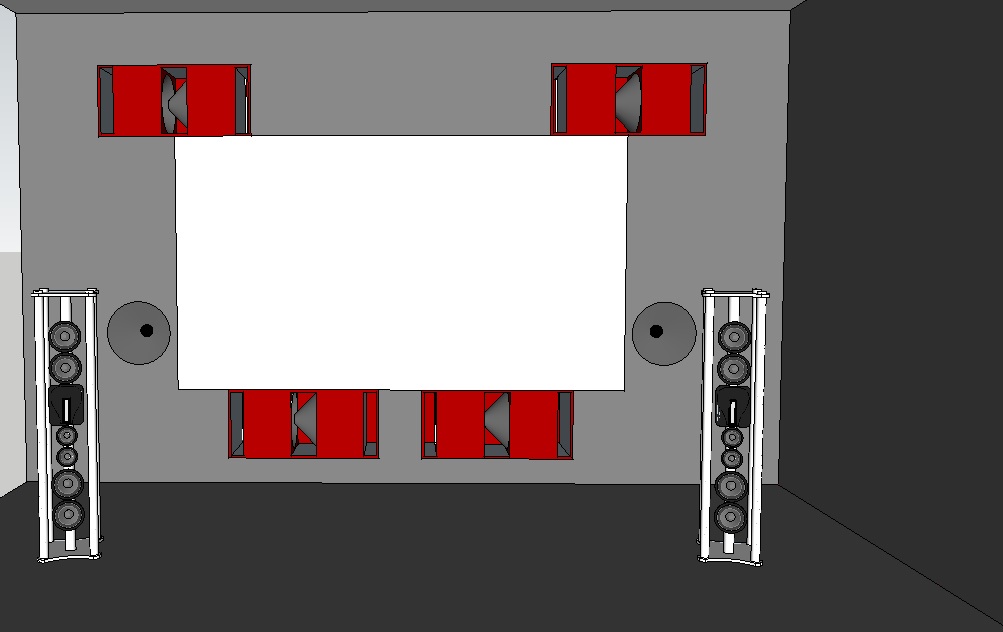

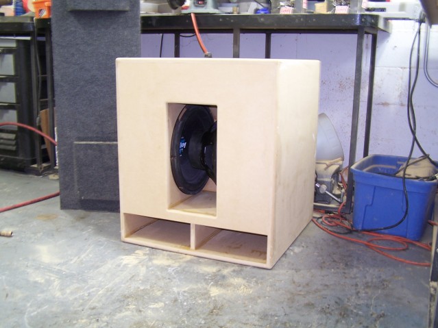

If you want to build a tapped horn but want 2nd dist and vibration cancellation why not just build a pushpull tapped horn? =)
Or if you don't need the vibration cancellation then you can get away with simply having two drivers and inverting one like Danley Sounds do in this tapped horn sub. Theirs is more overkill though with even more drivers =)
To be perfectly honest OllBoll I really don't know which would be the better option, as my only attempts to build a sub have resulted in failure.
I have a couple of CF 12" Jaycar Response drivers I could try either design. I also have a couple of the Vifa 10" hard paper cone drivers from another failed build.
Wouldn't look to use either in the final build, but might be ok to get a working concept happening.

Why not? As per Geddes the quality of the drivers aren't that important as compared to simply having more so you could have both... use the higher quality drivers as main subs and your leftover drivers as filler sub(s) to fix the response. The strain on the filler subs is much less compared to the main subs so driver quality won't matter as much.
You have a point and beside they are just sitting in the shed unused at the moment. Think I am going to attempt a PPSL if I can work out how to model it. I think the very nature of the design of the PPSL lends itself better to 2nd order cancelation than the TH. Just seems easier on the eye as well.

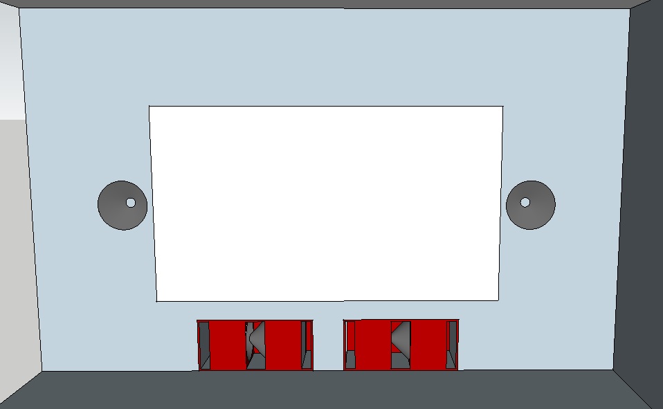

I don’t have the confidence that I will ever get Hornresp to work properly, so I am going to play it a safe and build a cavity all the way around the room and use matching slot loaded double bass arrays on the side walls.
I would prefer to put them in the front and rear walls but that compromises screen size by way too much.
With further reading I discovered that a line array is preferable to a manifold due to the outlet size. If I was to use 16 IB drivers in a DBA arrangement I wonder if the bass might be overkill...
IB should produce less volume, as should the DBA, and maybe driven mildly they might be ok.
