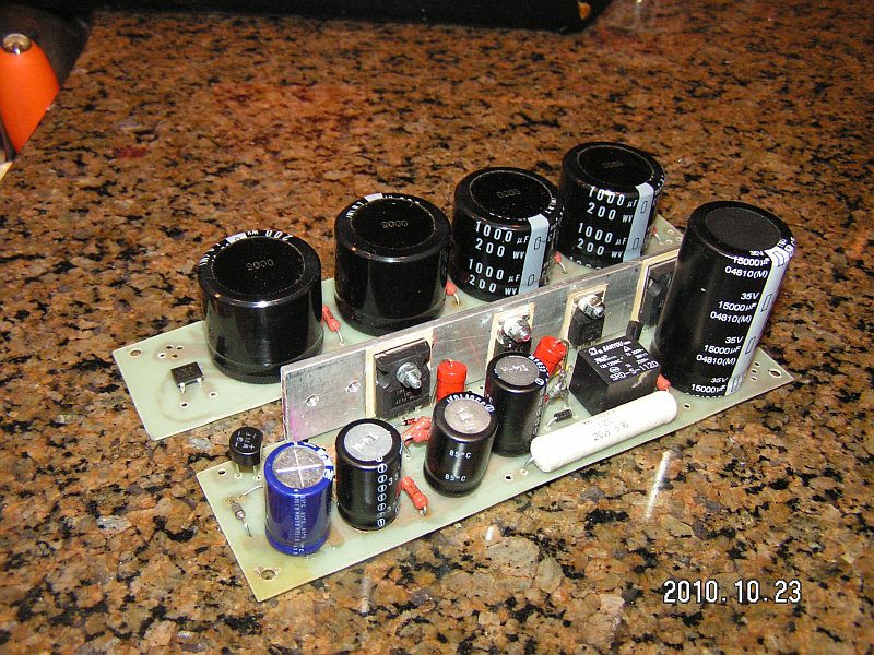

Thanks guys. I really appreciate all of the help. BTW when regulator tubes were used as screen regulators they were not generally buffered were they?
Regulator tubes have current limit around 40 mA. If screen grids draw higher peaks when your output tube saturates you will get nasty distortions (sharp peaks of screen grid voltage: VR tubes have negative resistance when switch on/off) instead of saturation that sometimes is forgivable.
In my first Pyramid amp I used SG-4S tube and IRF740 source follower to avoid such a problem.
Here are PS PCBs for my Pyramid-VII-M prototype:
