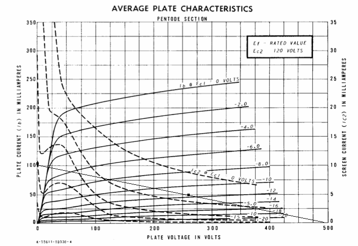

Using these 6LR8 curves (same as 6LU8):
Ignore the load line on that graph as it is from another project. I used the methods described here to check out a couple of bias points with 8K a-a load.
loadmatch4-pp-beamtetrodes
I ran the numbers at a bias point of 300Vp and just under 50mA Ip. I came up with about 19W full power with about 7W being class A. I ran some other points as well and it appeared that around 25W was possible at 350V.
The interesting thing is that, if I am understanding the method correctly, the idle current does not really seem to effect the maximum output power as the class AB power calculation uses only the class B load line which is determined only by the load impedance (1/4 Zp-p) and the maximum plate voltage. The non-intuitive result seems to be that running the tube "hotter" (at the same plate voltage) does not increase power output but only moves the class A load line up and down which will effect the total amount of class A power available before transitioning into class B. Presumably this would also effect the smoothness of the transition in some way but I am unclear on exactly how.
So by the looks of it I can play plate voltage against idle current to trade total power for greater "undistorted" power or trade "undistorted" power for tube life. Sort of like a "Low bass, high efficiency and small size... pick any two" type situation.
Does it sound like I am using the method correctly? Am I interpreting the results right?
Seems like I would be wise to use fixed bias so I can diddle with it to get the best combination for my situation.

You pretty much HAVE to use fixed bias, as the increase in current with drive in AB would increase cathode bias, shifting the operating point...

How do you know hard you can push a given tube? You must test. In most cases the 20% number mentioned is a given, since that is about the derating factor for sweep tubes. This is concerning plate dissipation only. The screen grid voltage rating is a wild card with sweep tubes. Some tubes will go unstable when the rating is mildly abused and some others of the same type number may be violated by a hundred volts or more.
In a class A amp the tube dissipation is worst case at idle and goes down as the output power goes up. You set the bias as a trade off between tube life and distortion, damping factor and harmonic make up. The bias current has only a minor effect on power output. Due to its effect on damping factor higher tube current can clean up sloppy bass. This is why I craank the KT88's in my Simple SE to 100 mA!
In an AB or B amp the maximum dissipation is never at idle and may or may not be at maximum power output. This depends on the tubes and the load impedance. It can be measured. It is not advisable to exceed the rated dissipation at idle, since things will only get hotter as the volume gets cranked.
"So it can take advantage of averaging and the crest factor to handle above rated power on peaks."

The bias current in a class A amp has almost no effect on power output, maybe 5%. I have seen some AB amps where cranking the current raises the power a bit more, maybe 20%, and some where raising the current actually reduces the power output. I suspect it has something to do with the load impedance, and the ability of the driver to push the grid positive. Remember if you turn up the current you reduced the negative grid voltage, now you have less room for drive voltage without going into AB2 territory. If your driver can't cope, you lose overall.
Increasing the bias current will allow the output tubes to remain in class A longer, but use up the dissipation headroom in the tubes. It also tends to reduce the higher order harmonics.

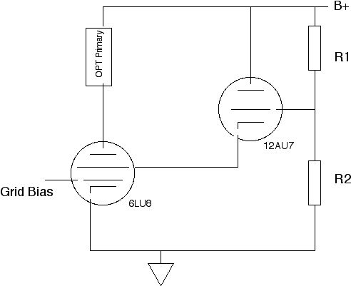

Ah, thanks. I did find a couple of mentions and they seem to be in the same territory as I was exploring but at lower B+. Idle currents around 25mA with grid voltages around 16 to 18. Looks like we have a starting point.
Since I was planning on using voltage divider screen supply I could make it adjustable with a pot on the upper side of the divider so that I could easily experiment with different screen voltages. My logic in using the voltage divider is that I can get somewhat more stable screen voltage than a single dropping resistor would provide but without the complexity of a regulated supply for both screen and plate. The screen voltage should vary proportionally (or close to it) with variations in B+.
You will be dissipating several watts here - it will require a rather robust pot.
A voltage divider screen supply would have significant "sag" under load - often considered desirable in a guitar amplifier, but probably not appropriate in your intended application.
Since I was planning on using voltage divider screen supply.......You will be dissipating several watts here - it will require a rather robust pot.
Add a Mosfet follower and a capacitor to your voltage divider and you have a stiff but non regulated screen supply. Add a zener doide or a gas tube string (0B2 type) and you have a regulated screen supply. Granted it is not an active feedback regulated supply but for a screen regulator it works great.

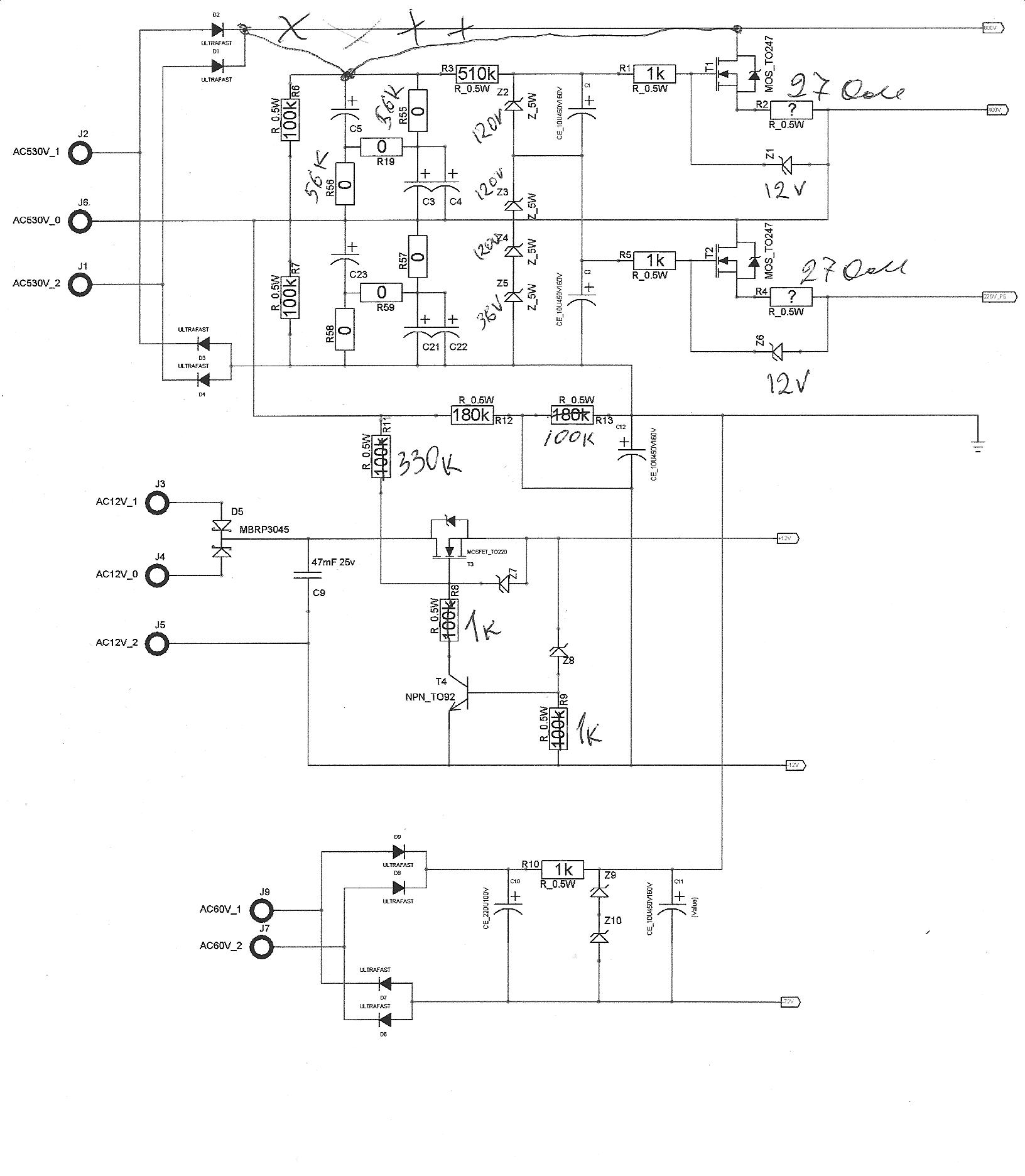

Look at the schematic for Petes red board (link in first post):
http://www.diyaudio.com/forums/tubes-valves/151206-posted-new-p-p-power-amp-design.html
The G2 regulator is in the first page of the schematics. R21 is there to lower the dissipation in the mosfet to allow a smaller heat sink. It can be eliminated. The active device (Q2) can be a mosfet, tube (6AS7 is a good choice) or even a properly rated BJT. D6 prevents blowing the fet on turn off. D5, D7 and D8 are the zener string. They can be replaced by a string of gas tubes but the value of R33 should be lowered to provide about 10 mA to the tubes. C22 provides filtering 1 to 10 uF is good. C21 keeps things stable. I used a 10 uF because thats what I had. You can use a pot (1 meg) across the zener string with the wiper connected to R46 to make the voltage adjustable. Don't use a BJT if you use a pot (base current).
Voltage divider will sag more than a simple dropping resistor? If the idle current through the resistor string is several times that of the current drawn by the screen it should be pretty stable shouldn't it? No doubt I would burn some extra watts but I thought that this was not an unusual practice back in the day. Am I wrong on that?
If I regulate the screen don't I have to regulate B+ too?
WRT the SF are you suggesting that a low current reverence divider be hooked to the gate of the FET and then the screen fed off of the source of the FET? Is there a load resistor on the source or just connected straight to the screen. Where would the cap be, just bypassing the bottom resistor in the divider as in a normal divider? Maybe a picture?

If the idle current through the resistor string is several times that of the current drawn by the screen it should be pretty stable shouldn't it?.......this was not an unusual practice back in the day.
Using a voltage divider is OK and was indeed standard practice on low current tubes, or in circuits that ran at fairly low levels in class A. A power pentode in a high power application can have wide swings in screen current. The current will change instantaneously with plate voltage, and it will change slowly. As the overall power level is increased the average screen current will go up. You can put a large bypass cap on the screen, but the screen voltage will still drop as the average power level is increased. This may limit the maximum power output under steady state conditions. It can be made to work with music, but power output measurements can be problematic.
Usually not. In a pentode the plate current is dependent on the bias voltage (G1) and the screen voltage (G2). The plate voltage has a small effect on plate current. So if you regulate the screen, you should regulate the bias supply, and vice versa. Yes, I know of several amps where the screen is regulated and the other supplies are not. Petes red board is one example.
Only Q1, R33, and a resistor in place of D5, D7, and D8. No other parts That will usually work, but it may oscillate. A load resistor from source to ground (R42) helps avoid oscillation if the screen current approaches zero. Set it for 5 mA or so on a big sweep tube.
A capacitor can be placed across R42 (C21). This is usually a good idea. The screen stopper goes between this cap and the screen of the tube. Multiple tubes can run off of one fet. Each gets its own stopper.
There is an issue putting a cap on the gate of the fet (C22). When the power is shut off the gate capacitor will need a path to discharge. Since all of the resistors are high valued, it will try to discharge through the gate of the fet, blowing the mosfet. D6 is added to keep the gate breakdown voltage from being exceeded. Some mosfets have the zener diode inside the fet. D6 may not be needed on these fets.
R6 is a gate stopper. It may not be needed if only resistors are connected to the gate (voltage divider). If any other parts are present, add the stopper.
R21 is probably not needed unless a lot of voltage is being dropped at a high current. This circuit was dropping nearly 200 volts and feeding 4 sweep tubes.
Start with something simple and add whatever is needed for your particular application.

If you're going to do that, then make a proper active decoupler with either a MOSFET or BJT. A 12AU7 is not a real good choice for this since any triode, and especially one with a rather low u-Factor like a 12AU7, won't isolate the screens from the DC rail very well since triode plate current varies a great deal more than either the collector or drain current with variations in voltage appearing at the plate (collector, drain).
Even better would be active screen voltage regulation.
I also found a Zener string and a source follower more than adequate to regulate screen grid voltages.
On the schematic you see 400V regulator (driver stage), 270V regulator (GU-50 screens), -72V parametric stabilizer (control grid bias). Gu-50 tubes also, like sweep tubes, are very underrated for audio usage: they were rated for linear amplifiers in transmitters where they were providing sinusoidal output.
Since screen grid voltage is regulated, I strongly advise to regulate control grid bias as well.
