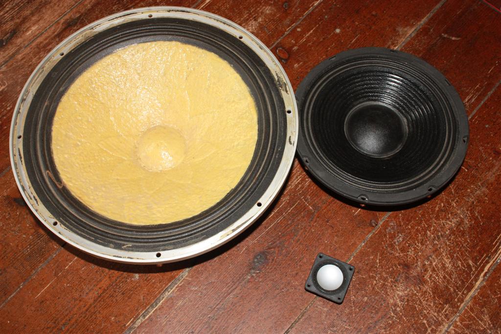

No Cabinet,
drivers lying on the floor ?
Then i must have built lots of ceiling flooders, just for breaking
drivers in ...

No Cabinet,
drivers in ...
