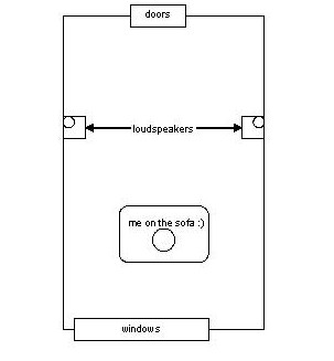

RFZ believer is a person who believes that for high fidelity sound reproduction at home a sort of early Reflection Free listening Zone is needed that is all early reflections <6 ms (other say <10 ms etc.) should be eliminated
flooder in Beveridge placement is a stereo setup that I have proposed in this thread:
http://www.diyaudio.com/forums/multi-way/121385-loudspeakers-room-system.html
it is very short up-firing speaker with no reflectors above, similar to some old Swedish Carlsson/Sonab speakers, placed in a room in a way recommended by late Harold Beveridge for His electrostatic speakers
ps.
it only needs killing/diffusing of the very first reflection off the adjacent wall
absorbed/diffusor can be placed just on the wall next to the flooder or can even be integrated as part of it's enclosure
in a small room of 3.5 x 5 m proportions the setup may look basically like this:
yes, and a flooder in Beveridge placement does it, it only needs killing/diffusing of the very first reflection off the adjacent wall

If by "flooder" you mean essentially non-directional, then boundary mounting will make that first boundary disappear.
great! then no absorber is needed at all because I thought that there will be necessary to absorb exactly the reflection off this boundary next to speaker, at least such was suggestion I got from Dr Geddes
you are forcing a low direct to reflected ratio. This may not be a good thing.
yes, this is it and yes perhaps, it may not be good, but I really like what I can hear (and it is not only me - ask tinitus for example)
Also, if you must damp the opposite wall then you don't have an optimum dispersion speaker, do you?
misunderstanding - I assumed that it will be necessary to absorb the very early reflections/diffractions from the wall next to te flooder, not the opposite wall

Regarding the Beveredge approach, Yes, to the extent that the speaker is smoothly integrated into the wall the first boundary disappears. The opposite of how a PZM microphone works. But how do you make the leap that this is ideal? If the first reflection disappears, then great, but you have a system that is primarily aiming its energy at the opposite wall. Why is that good?
firstly, neither Beveridge nor flooder are primarily aiming their energy at the opposite wall - the horizontal polar patern is perfectly uniform - 180° precisely speaking
secondly, it is good because it gets rid of the floor and ceiling reflection for good (in case of a true line source as in Beveridge) and enables us to have the earliest of the early lateral reflections arrive >8 ms even in a room as narrow as 3.5 m
in a bit larger room it is easy to have delays >10 ms to satisfy even the requirements of Dr Geddes et consortes
it is an advantage over typical stereo where we have very early vertical reflections and even 6 ms of delay is difficult to obtain for lateral reflection (in case of vertical reflections quite impossible to obtain), isn't it?
in case of a flooder the lateral reflections are delayed by the same amount as in Beveridge and first-order floor reflection is eliminated as the speaker is as much integrated into the wall as into the floor - being very short and up-firing
and the ceiling reflection is just as lateral reflections ie. delayed by 8 ms or more (depending on the height of the room and of the listener's seat)
this is why I think it is good from RFZ-fans perspective, wouldn't You agree?
