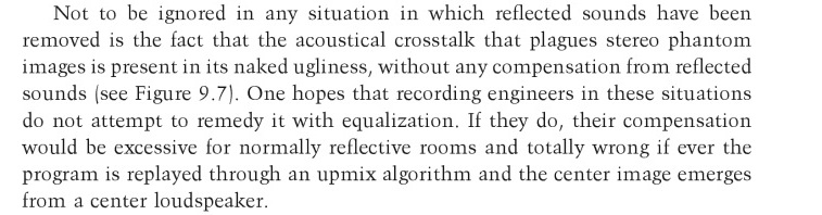

I don't see any connection between your quote from Toole and your post. Can you explain?
In the discussion with graaf different estimations of usefulness/harmfulness of early reflections showed up.
Graaf posted that Toole citation in #153, so i just re-cited it to bring back into mind, that according to
Toole without reflections there is
"...acoustical crosstalk* that plagues stereo phantom images is present in its naked ugliness..."
* Own supplement: acoustical crosstalk and interspeaker interference
___
To me the question arose, whether smoothing interference patterns (by also early reflections) might be
a major reason for some listeners to prefer wide dispersion speakers, as the enjoyable listening zone might
be considerably widened, even if the zone of "proper imageing" will not be widened to same extent.
Preference for wide dispersion speakers would then as a consequence (at least partially) originate in a
shortcoming of the stereophonic system itself
and not (solely) in (postulated) advantages in speaker/listening
room interaction.
If smoothing of interspeaker interference patterns can be achieved in a different way (not just using early
reflections introduced through wide dispersion), then also estimation of usefullness and enjoyability of more narrow
radiating speakers might change considerably even for that share of listeners preferring (conventional phase coherent)
wide dispersion speakers.
