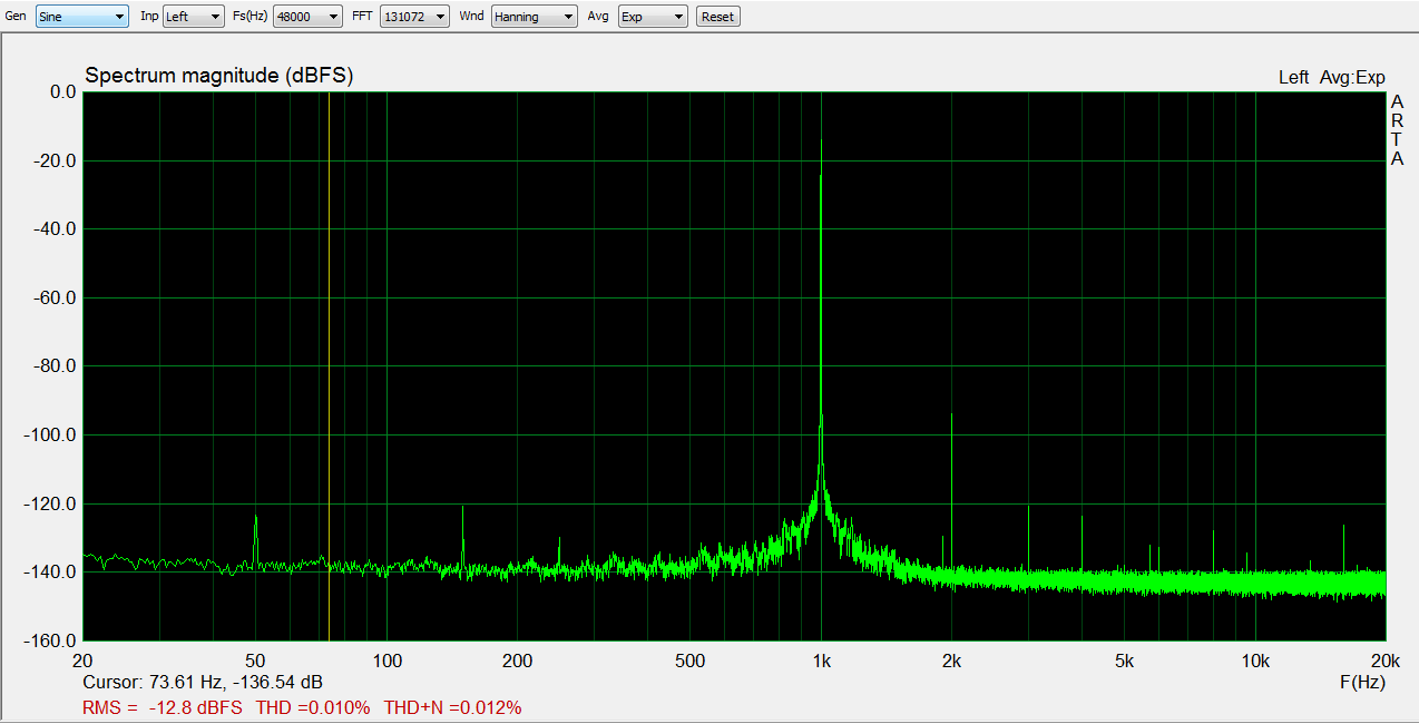

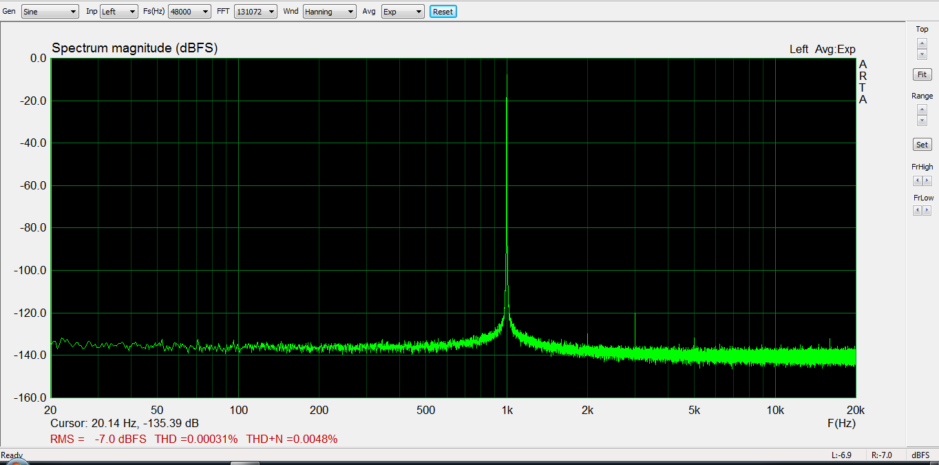

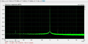

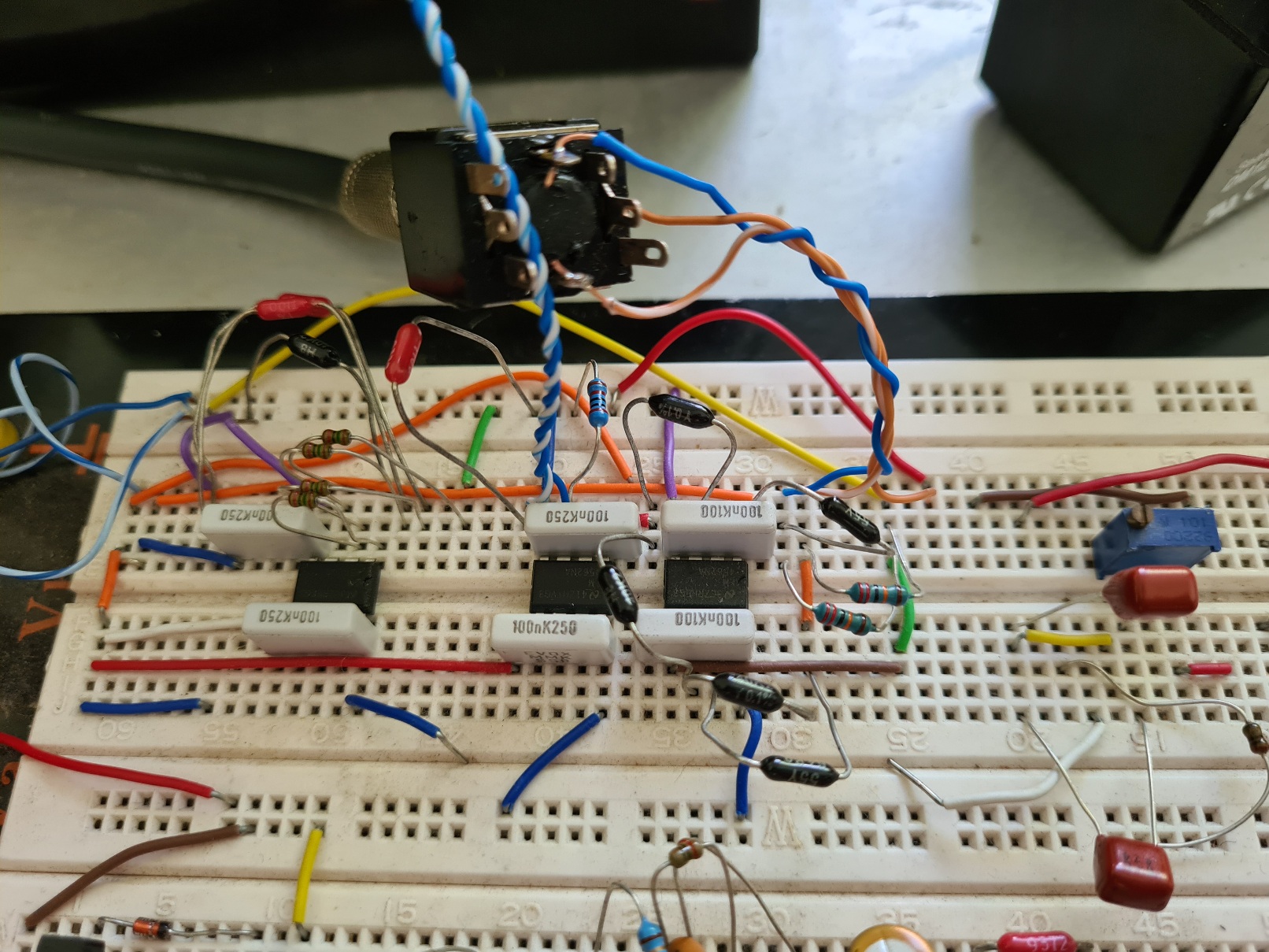

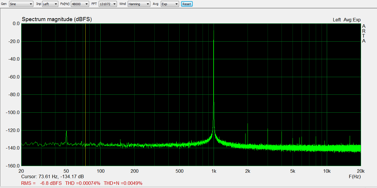

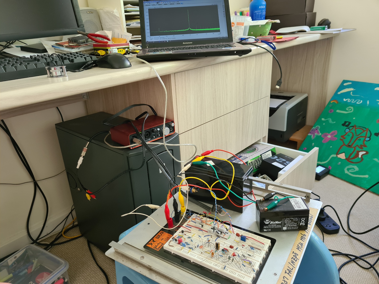

I've hooked up the circuit and done some tests. Note this is not as I posted earlier this is with 40.2K resistors, apparently my worry about needing to use lowest value resistors for good noise floor was unfounded. Appart from 40.2K instead of 1.3K resistors pretty much the same.
Attachments show the focusrite in balanced loopback, then in SE loopback, then with the circuit in between to convert SE to balanced for input. I'll edit and upload the photos to show the mess that is the breadboard. Proper layout with attention to earthing should result in distortion performance improvement, and placed in a metal box should remove the 50Hz pickup.
edit: also note that one of my 12V batteries is not happy and so the negative rail was around -8.4V instead of -12V so that certainly won't be helping things either 😉 the opamp further to the left is for the balanced to SE which I was not using. I just took tip and ring from the output to the input of the converter.
Tony.
