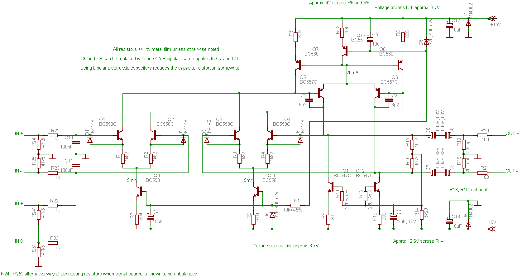

Sorry guys/gals, just realize Rod´s site has been linked to already.
Strange there is no simple&cheap PCB out there for this.
All pretty expensive.
This is one is too much but would be nice for testing etc.:
BTSB Buffer - SE/Bal to SE/Bal Buffer GB
This one, unfortunately, is not a rectangle PCB. Otherwise it would be cheap to send the design for production (gerber files provided):
https://www.ti.com/tool/TIDA-01359
I might take Rod´s circuit (P87B) and make a simple PCB for it but will do some more searching (need a proper adapter for bridging amps)
