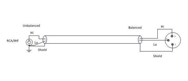

Q-How about not using di box in connecting laptop to audio mixer what about using mini jack to two trs? Is it possible?
Poster1- Sure no problem, but use a minijack to 2xTS cable as shown in the video.
My post
Little confusion...he does not want to use DI box. It should not be done as you will get noise as the unbalanced signal grounds one of the pins of the balanced input.
Gajanan Phadte
Poster1- This is correct, however as long as the cable run is under 15m you will generally not have noise issues.
Is poster 1 correct..
Gajanan Phadte
