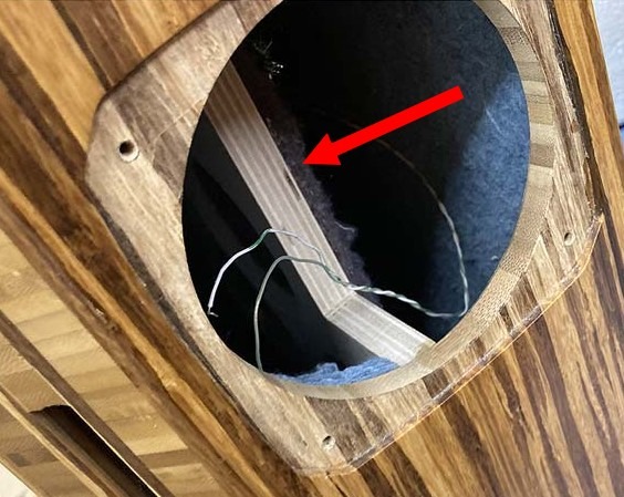

I didn't put much effort into thinking about how to cut the brace, mostly because I used 18mm baltic birch for my construction so I figured a cabinet this small didn't really need bracing. How in the world do you cut the brace for these speakers?
I can make the two angle cuts without any trouble, but I'm at a complete loss to understand how to make the inner cut that actually braces the back of the speaker magnet. Any insights here?

Take a bandsaw when you have. Or just cut the brace with the tablesaw and glue it back together afterwards.Bummer about the badges...

Carefully, indeed. 😉 The only thing I could come up with was to cut and reassemble, but I thought that would be considered cheating…. I have a scroll saw, but I figured there was no way that I’d cut a straight line through 18mm dense wood with it. Thus, I opted for a smaller rectangular brace between the driver and the rear panel. This made life more simple for me.
Pretty much.
Probably several ways to approach it, but for me it was a case of installing a spare driver frame in the recessed mounting hole, and setting a sliding bevel square on the back of the magnet to measure the required set back, then transfer that measurement to the corresponding edge of the driver brace.
Cutting was generally by band saw, leaving the layout lines visible, then fine tuned with hard backed sanding block. When haps showed up on dry fitment testing, I’d shim with strips of veneer edge tape or thin PSA glazing tape, etc.
After a few dozen, it becomes almost muscle memory. In the cases of larger or multi-driver designs, fitting and cutting all the holes in the driver braces could take almost as long as the rough glue up of the enclosure carcass.

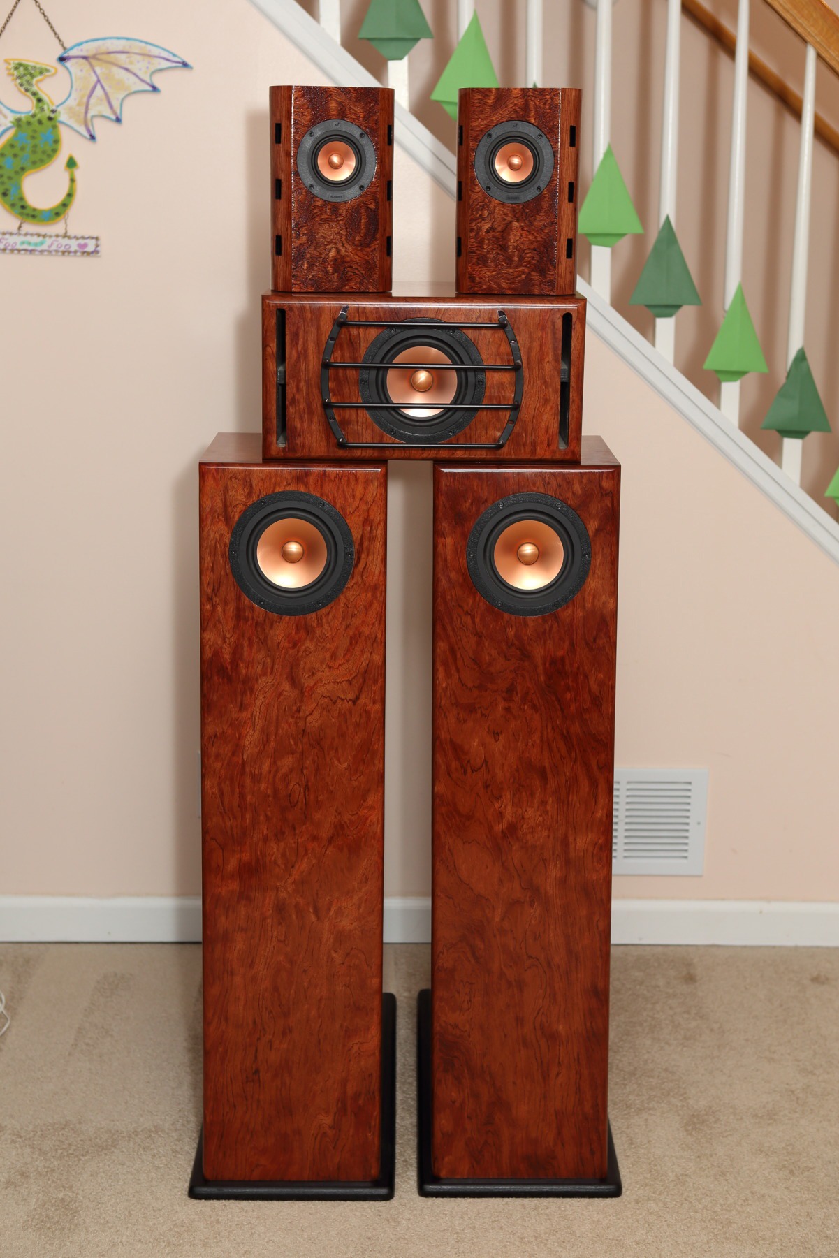

I meant to post a family portrait a while ago, so here are some images...

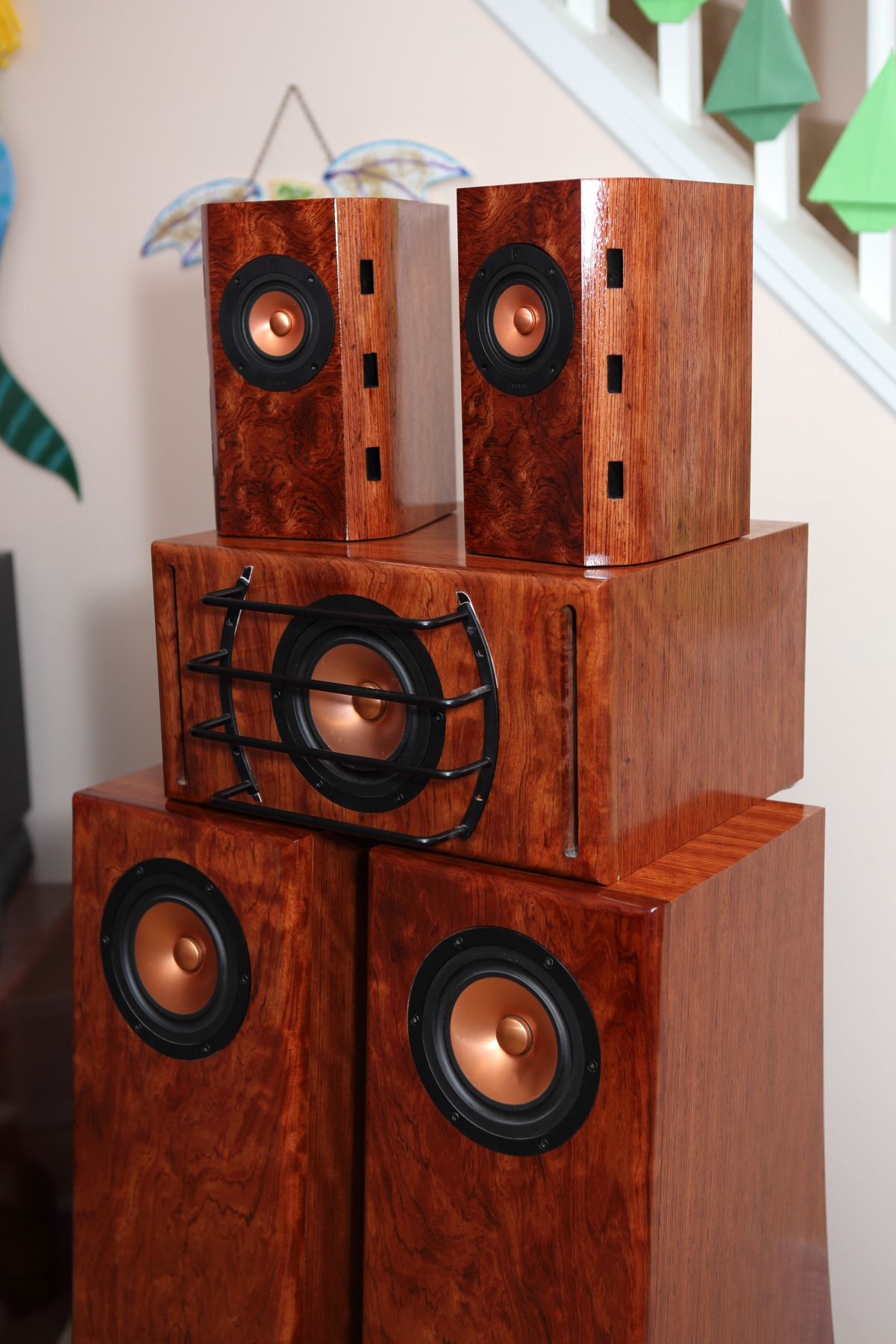

And a closer view of the cabinets and drivers:

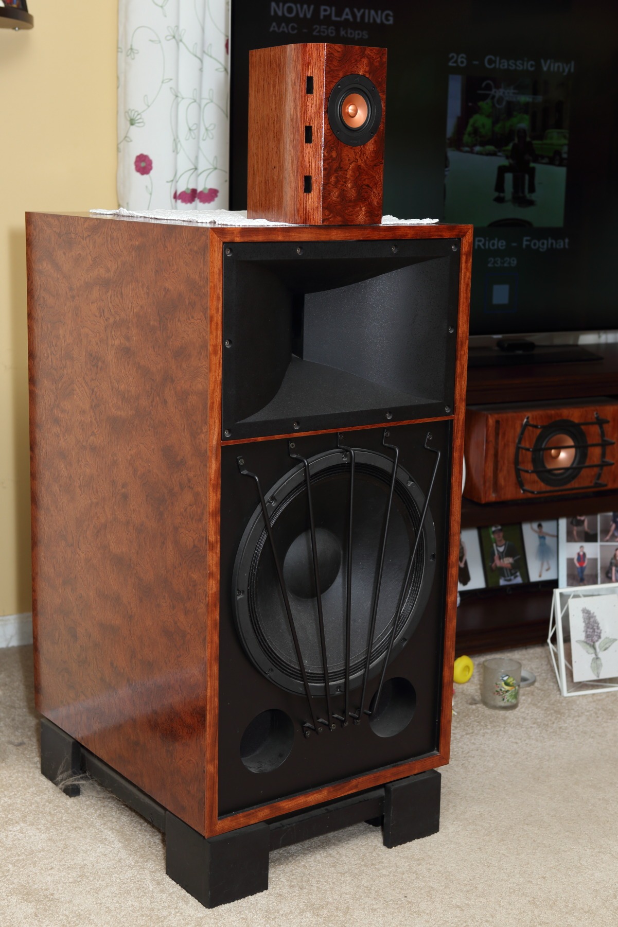

And finally an interesting contrast between by smallest speaker and my heaviest speaker set (about 165 lbs each). This is the uMarKen-SET sitting atop my Calpamos build (Tony Gee design). I'm really liking these little guys, though the larger ones produce a bit more bass...
