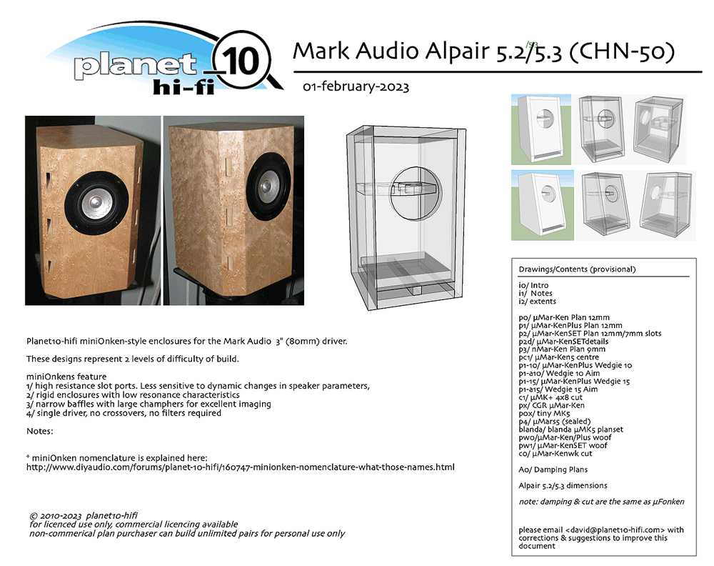

I'm curious to learn a little about the uMar-KenSET speaker design that's been shown here. I'm looking for a relatively small speaker that will be used with my computer. Playback chain will be Focusrite Scarlett 2i4 DAC ---> ACA ---> nice small speakers that will flank the monitor on my desktop and be pushed up against the wall behind the desk.
The uMar-KenSET looks like an interesting speaker that seems to fit my criteria. Will this design perform well in this context? I figure it probably won't generate much bass (maybe wall and desktop boundaries will help a little?), but I need something that is pretty accurate on the top end for click and pop editing on vinyl rips. Open to other ideas, of ocurse, but I'd like to keep driver cost under about $100 each and keep the footprint small.
The slanty-front baffle design also looks like it might be worthwhile, given the nearfield listening.

Should work great, even with the bass performance limitations. I've been using Dave's miniOnken style speakers on my desktop for years. Mostly the larger 4" variants, but the smaller MA drivers like the now OOP A6p also work really well.Will this design perform well in this context?
jeff
It is its official target.
An early box that lead to the µ-size miniOnken trapezoids.
Add woofers and they give up little to a much bigger system.
dave

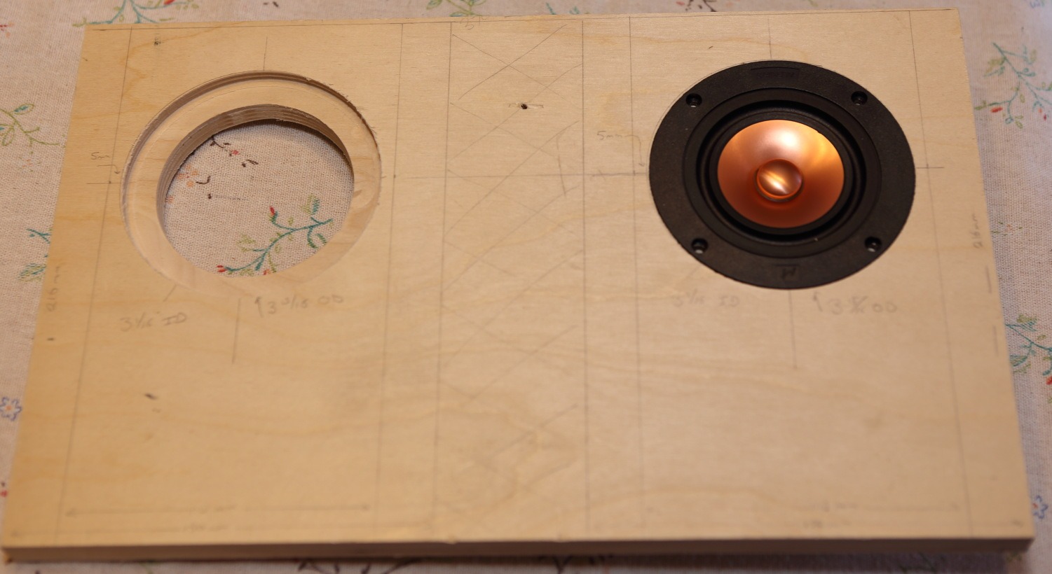

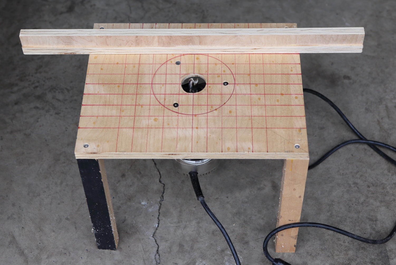

Things are progressing along and I have to say that in addition to these being my smallest ever speaker construction project, it's also been the most challenging in terms of angle cuts and precision. Whichever one of you guys came up with this design (Dave, Chris, ??) may have some masochistic tendencies
I altered the plans just a little to fit the mix of 18mm Baltic Birch and 12mm ply that I already had on hand from previous projects. It was also a good excuse to spend a few minutes building a makeshift router table. I've been contemplating buying one for a long time, and I just decided to cut some wood to make one.

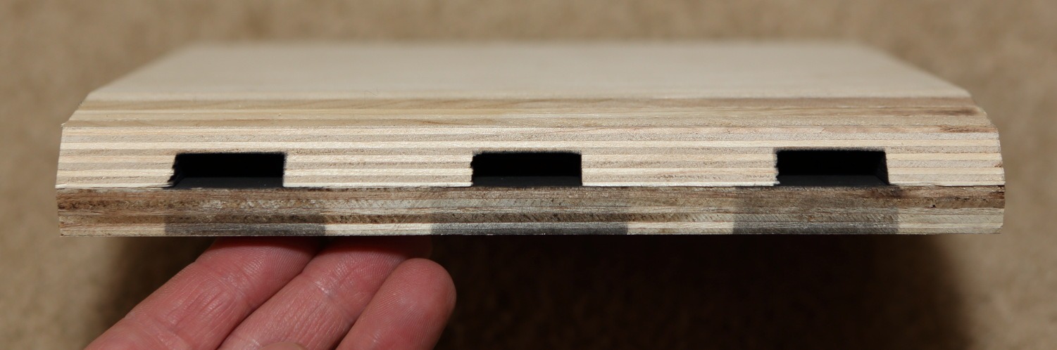

So, after this little side project, I cut the outer side panels from 18mm birch and then routed the vents into them. I thought this would be easier than trying to cut down four strips of "spacer" wood to make the vents. It seems that wood glue works more like wood lube until it finally grabs, so I figured this approach would keep things from slipping around while I clamped it together.
After plowing the vents into the side panels, I cut the front edges at a 35 degree angle and then adjusted the saw to make the 10 degree side cut. I masked off and painted both sides of each vent, then glued them together. The sides are a few mm longer than indicated in the plan to account for the added thickness of the front and rear baffles that are also made from 18mm birch.

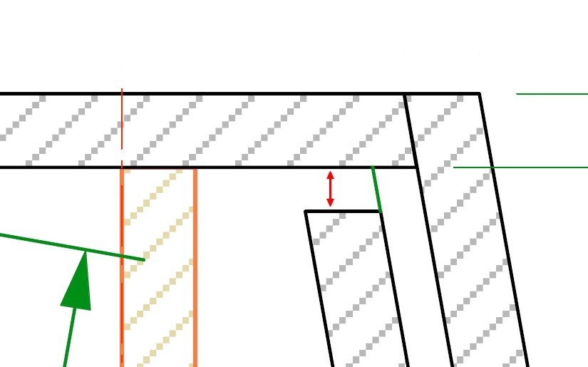

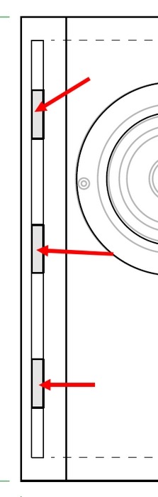

The front panel also needed some adjustment to make the vents work properly for the thicker wood. After routing and test-fitting the driver holes, I cut the 45 degree angle and then plowed out 6mm from the side edges of the back of the baffle, restoring them to the 12mm thickness shown in the plan. This allowed the vents to line up the way they are shown in the plan set. I neglected to make a close-up image of the front baffle profile, but you can see some of it in the lower image below.

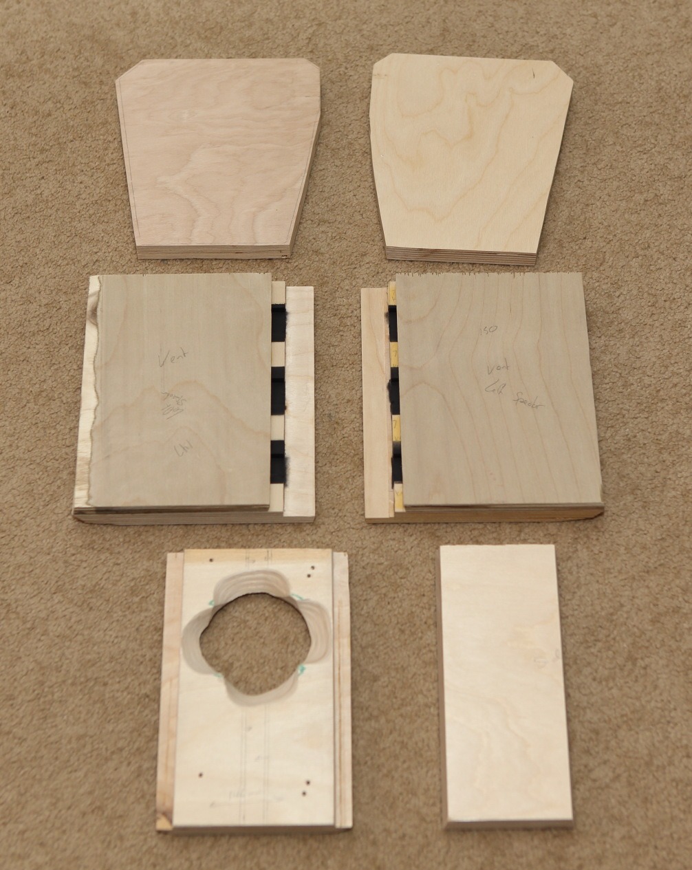

So far, the four sides of the boxes are glued up. I dry clamped (no glue) the top and bottom panels along with some wax paper to make sure I maintained proper panel alignment while the straps held the rest of the panels in place while the glue dried.
I'll add some additional images as work progresses. I have just enough quartersawn Bubinga veneer left over from my FHXL build to make these look nice as well. The hard work is done (needed lots of test cuts along the way), though there is still plenty of work to do...
