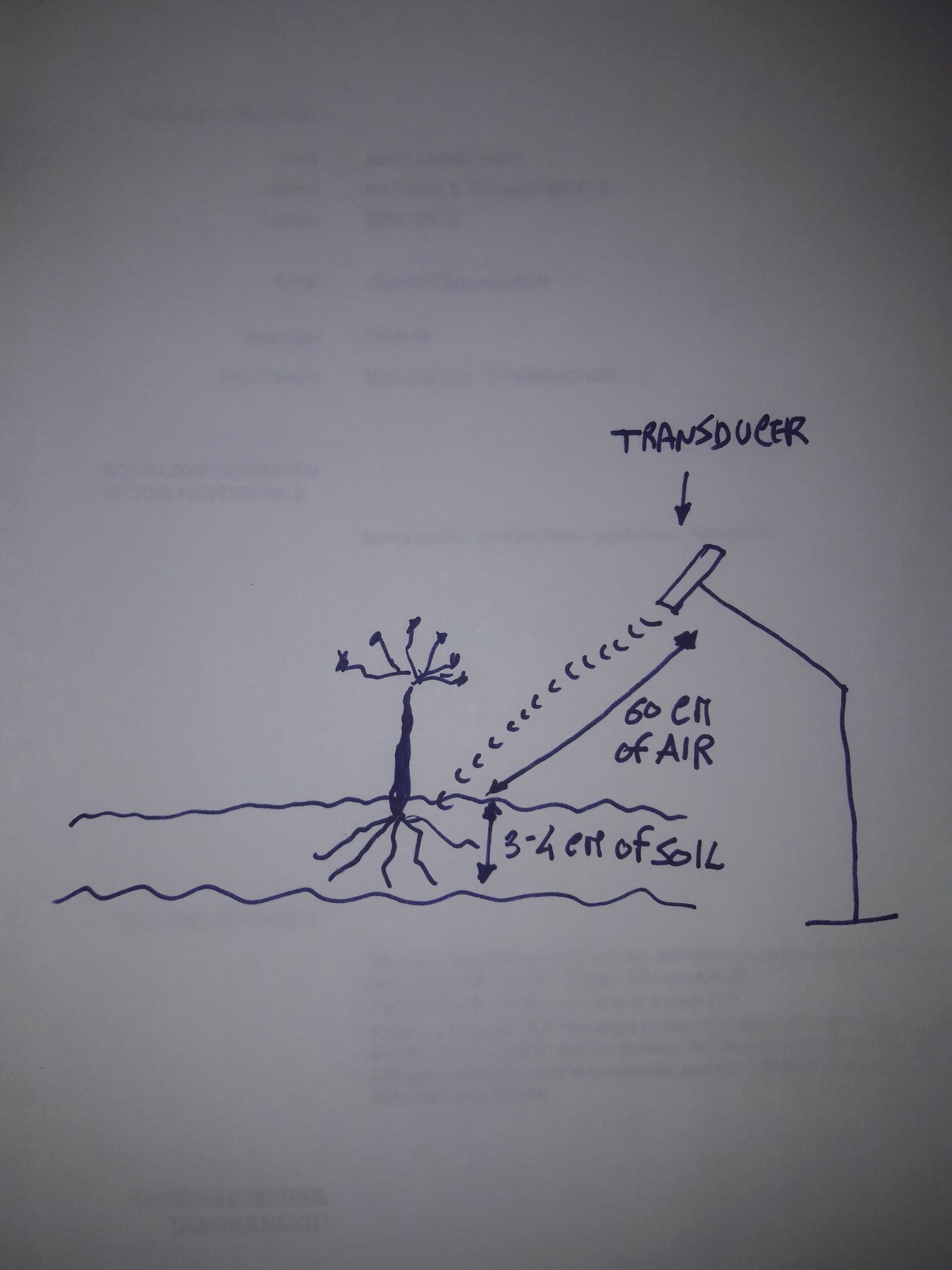

hi Andrew then considering the powers I think a 100 watt transducer could be fine, I could always move it away from the surface in case it was too powerful,It seems like a parabolic reflector is a good starting point. It also seems like there's a need to determine some particular level of required acoustic power at some range. After you know that it would be easier to determine how hard it will be to get. ?
@Galu it is research that I have been carrying out for some time, I have attended various conferences and meetings on this topic, which is why I am talking about it with you, there are numerous articles about the help that ultrasound gives to the defense and growth of plants. So are there solutions with parabola or phase coupling?
sorry, maybe I'm wrong about the concept of the difference between speed and pressure, I ask for your clarification. however for the concept of the parabolic reflector which is a feasible solution, what can I do?
I certainly didn't understand what you meant by "phase coupling", even after reading your Wikipedia extract.
Even if armed with the full technical specifications of your ultrasonic transducer, I can't imagine how a parabolic reflector would overcome your air-soil acoustic impedance mismatch problem.

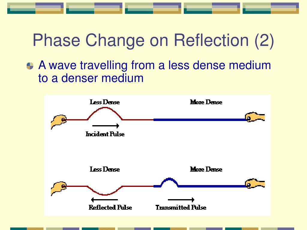

The phase change is located where the change in impedance occurs. Altering phase at the source changes nothing.phase coupling?
Similar to this:
Yes. There's nothing you can really do from the souce that affects a location based phenomenon.

@AllenB so the question of the phase was my personal thought, reading what wikipedia said but not sure if it was the right path. instead the question of the parabolic reflector is more considered, in this way by pointing the transducer on the reflector, the reflector reflects the focused wave on the ground in the form of a plane wave, so as to have less attenuation, tell me if it's ok
so the question of the phase was my personal thought, reading what wikipedia said but not sure if it was the right path. instead the question of the parabolic reflector is more considered, in this way by pointing the transducer on the reflector, the reflector reflects the focused wave on the ground in the form of a plane wave, so as to have less attenuation, tell me if it's okI certainly didn't understand what you meant by "phase coupling", even after reading your Wikipedia extract.

@AllenB yes the phase question was just my idea, however for the reflector that generates a plane wave, that is a more feasible idea. the plane wave having no points of incidence is not affected by the attenuation effect, if I find the original text that my friend sent me I will send it to you, wait
@AllenB this is the test of my friend:
"Do not place a clear reflector around the plant, because that will block the wind and the rain.
You have one point source of ultrasound, and I believe you want to make a cylinder of sound that will enclose the plant with an isotropic level of sound, that penetrates the surface of the soil from above, to about 30 mm depth.
A radiating wave, from a point source, can be converted to a parallel beam by a parabolic reflector. That is the same principal as a satellite receiver dish.
A dish reflector would point downwards from above the plant, with the transducer at the focus, pointing upwards at the dish. The diameter of the dish will keep some rain off the plant, but sunlight and wind will enter from the side.
The reflected wave will arrive at the soil surface as a plane wavefront, so it should penetrate the surface soil evenly. I would not expect the wave to be reflected efficiently from the soil surface, unless it was flat and wet. Energy will be dispersed and lost in an open-structured soil with a rough surface.
The height of the dish above the ground is not critical, it can be raised as the plant grows.
I expect the dish diameter will be about 300 mm, which is 10 wavelengths at 30 kHz ≈ 5° beam sides. The ratio of focal length, to the diameter of the dish, will be determined by the radiation pattern of the ultrasonic transducer selected. The theory is the same as that of microwave dish "illumination".
The transducer specification, and the power level required, have not been specified."
