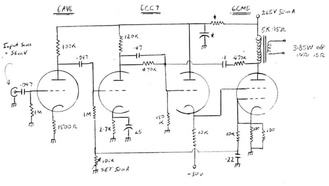

I have found another iteration of this design, but taken to the extreme where there is no drive to the grid at all.
The article is here ...
PL36 SE amp
The author experimented with many different ways to try and get some linear behaviour out of a 6CM5, which is an equivalent of a PL36. The best operating point was to tie the grid to the cathode, set g2 to +25V with the anode at 250, and drive g2, also using a 6CG7 in a very similar screen drive configuration to the circuit at the start of this thread.
The clipping issue mentioned by an earlier poster, due to the anode of the cathode follower being at a similar potential to the out put tube, is solved in this circuit by biasing the cathode of the follower with a negative supply.

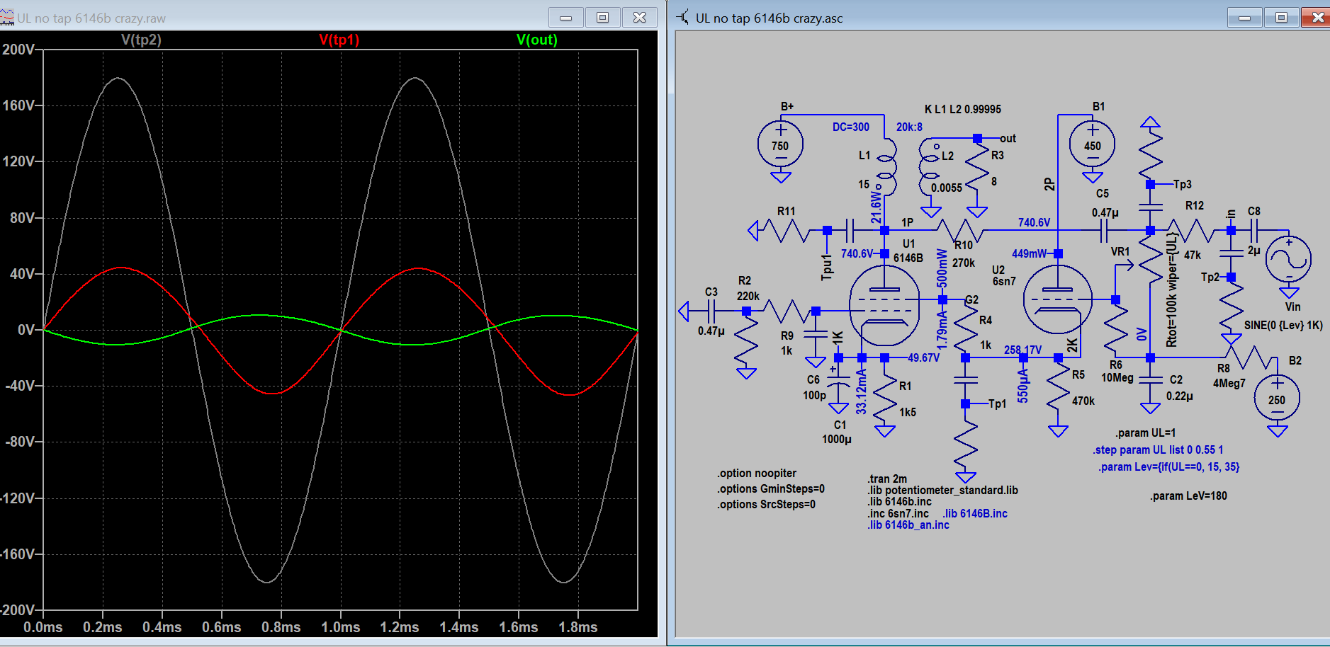

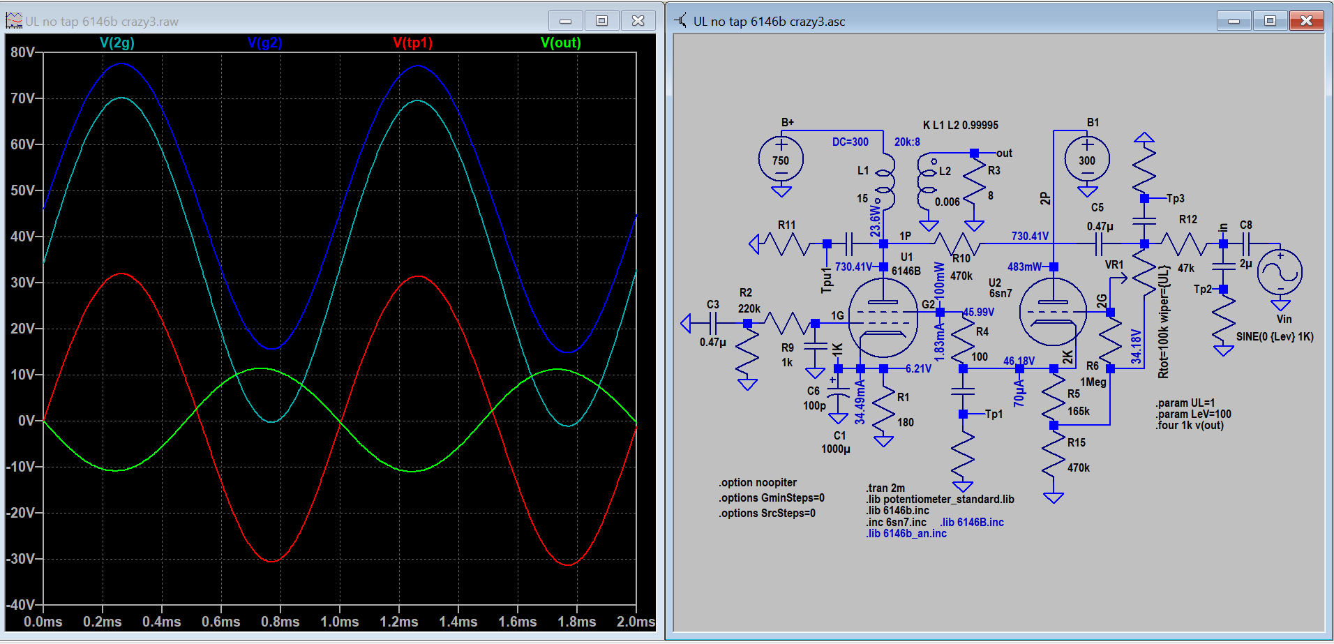

This is my sim of 6146b screen drive for sharing. Input 180v-p, reduced to 45vp screen drive with feedback from plate, that is gain reduction of 4 or 12dbs. Thd 4% @Pout ~8W.

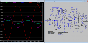

This version is as close as I can get with reference sch in post #7, the distortion is much less with lower G2 and G2 voltage, but no negative supply required and reduced driver plate supply as the driver is self biased to cover the input drive level. Thd 2% @9W Pout, input 100V-p.
