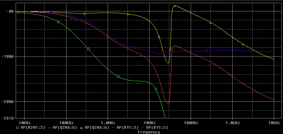

MikeB said:Hi Jan !
I checked your suggestion, i replaced the 1.87 voltage with 3 diodes
in series fed with 15k, (I had no adequate LED-model)
there are only subtile changes.
I checked with different closedloopgains, with gain of 26 results
in acsweep look identical, with gain 1:10 the acsweep gets critical,
but no oscillation yet. I decreased timestep from 10ns to 2ns to
be sure.
Attached is acsweep, blue is output before coil, green left base
of diffamp, red right base of diffamp. Feedback keeps always
below input, so should be safe.
Mike
Looks pretty good to me. But to be sure, you should put couple of ohms in parallell with that output choke. As it is, it start to roll off the output to the 4 ohms load above 350kHz or so. I'm not sure what that does, and I can't think of a good reason (engineering wise) to do it, but it is customary and it may have an influence. Then again, you may be the first to prove that "what everybody does" is just so much BS...😉 . Sheep following and all that.
OTOH, there may be a reason once you get into complex xover networks. Anyone?
Jan Didden

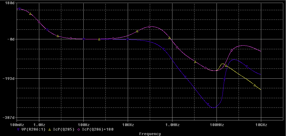

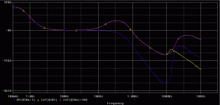

Hi sajti !
This is folded cascode, not cascoded vas, or do you meant the FC ?
I did not observe/hear sharp sound, but you're right, this could be
about taste... (it does sound clean)
About the phaseshifts, i am not sure...
I took the phasehifts at diffampoutput (currents because of FC),
they stay in phase up to 100mhz... Don't know why...
The +180 is because they are inverted/mirrored. (left to right)
Attached the phasehifts...
Mike

Ah, i understand !
Okay, now i will try to find out why this amp does not oscillate,
according to phaseshifts it should oscillate with 3.6mhz, but it
does not, at least not in sims...
Mike

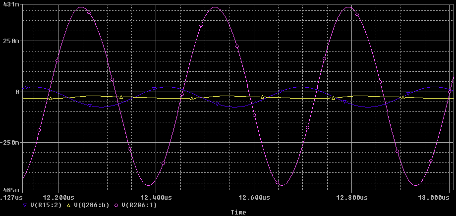

Okay, understood !
I just made sims with inputsignal of 3.6mhz...
The 2 signals are 180° phasehifted, but due to the absence of
the feedbackcap (is it lead or lag ? i swap them always), closedloopgain
was heavily increased at this frequency because of the inputcapacity
of the bjt on feedbackside of diffamp...
Funny way to stabilize an amp, but maybe not state of the art ?
Increasing closedloopgain above openloopgain at resonancefreq.... 😀
At least the choice of caps is not difficult with this amp !
So this amp is "accidently" stable, but as doubledarlington really not fast
with the 180°-freq at 3.6mhz... (but still amplifying at this freq !)
So, no miracle amp at all... Pity... But interesting !
Now i will try with "correct" feedbackcompensation, and check how it sounds then...
I attached a shot of sims at 3.6Mhz. Pink is output, blue is input
(Left side of diffamp-base), yellow is feedbacksignal (Right side of diffamp-base)
Mike

I saw the picture You attached. I see the phase shift between the input, and the feedback signals. But with normal working, the levels must be same. Due the feedback level is much lower, this amplifier has much lower gain than the closed...
sajti

Mike, where do you measure the output, at the load or at the amp side of the choke?
Jan Didden
Hi !
Jan, i measured at the ampside of the outputchoke...
Sajti, yes, the levels should be nearly identical, but at this high freq
the inputcapacitance of the feedbacksidebjt seems to push down
the level. That's what i've meant with increasing closedloopgain.
But even with cap across the 22k it does not oscillate...
In audiofreqband this effect is not visible yet.
Mike

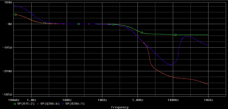

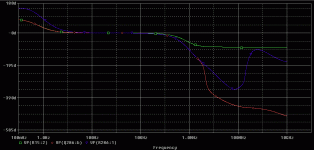

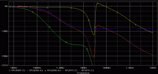

For final confusion...
I sim'd with 33pF across the 22k in feedback, attached are the
resulting phasehifts.
Green is output, red is feedback, blue is input and yellow difference
between phaseshifts of input and feedback.
Now it never reaches 180° ??? This circuit drives me crazy !
Mike
