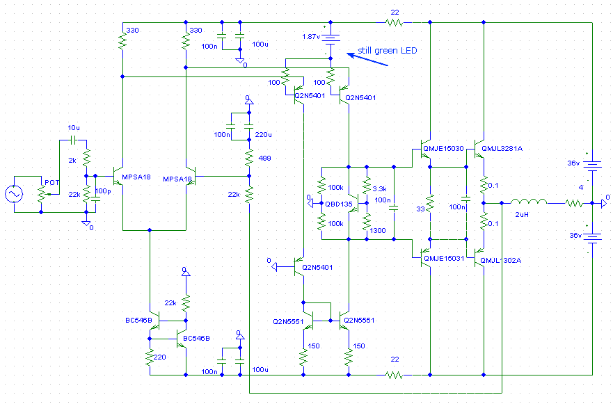

Do you mean the output from the squarewavegenerator ?
Or the signal at diffamp-input, after inputfilter ?
Mike
Mike,
I asked both questions in my earlier post, and you answered "I checked output from squarewavegenerator, rise/fall was barely visible on scope. I will check more details the next days.
How did it go?
I interpret your answer as the slewrate of generator square wave signal to have enough steep flanks.
You mentioned in post #63 the scope timedivision setting was 1uS, is it the smallest timedivision?
If you have 1 volt with such a steep flank from your generator you can't see any angle with 1 uS timedivision you have sufficient slewrate on your squarwave from generator, but the question is still how it looks like at the diff stage trany.
BTW I think you have very stable squarewave from your amplifier, there is not a single sign of ringing, which is not uncommon.
BTW, I checked again your schematic, you have a trim resistor at the input attenuating your generator output signal level!?
Is this e real life setup, and what is the value of it?
Regards Michael
Hi !
I will do more checks the next days, i had not too much time yet...
Michael, the smallest timestep on the scope seems to be 0.05uS per div,
the selector goes down to 0.01, but the last two steps did not show
any change...
I think the generator is far from perfect, but i had to build a generator
in short time, and for 3 bjts it's not bad i think. It's a modified
multivibrator with a gainstage followed.
The trim at input is the volumecontrol, i normally connect the amp
directly to the cd-player.
What i've meant with rise/fall barely visible is that the flanks are
very steep.
In diffamp i can only measure the inputs, the output does not
really contain voltageswing due to the cascoded nature.
But as the scope has 20pF inputcapacitance, these measurements
might not be very accurate.
But i could measure the currents through vas at the lower 150ohms.
Mike
Mike,
Im just laughing when you say your generator is far from perfect BUT you can't see the flanks even with timedivision of 0,05 uS??? 😱 😀
You have a radio transmitter!
btw I checked several scopes we have around where I am at the moment and theres several 20 MHz scopes of diffrent brands and the smallest timedivision is 0,2 uS on all, you must have a quite fast scope there with time division down to 0,01 uS?! 🙂
Well, the question about your attenuator at the input, the resistance will have an impact on the LF filter formed together with the 100 pF and input capacitance of the diff stage.
If the probe is 20 pF I think it won't have too much impact on your meassurements...
If you are going to measure voltage over the Re, it can be a problem if you are going to connect the earth of the probe to the high impedance CCS, be carefull.:att'n:
Edit: One mor thing I made a fast calculation, you have about 2,2 mA through the VAS if I made the calculation right...
Anyhow my guess is that with doubble darlington you have bigger Miller load with MJE 15030/1 for the VAS than with tripple darlington 2n5551/401, which perhaps make the speed diffrence.
Cheers 😉

Hi Mike,
Your amplifier looks good and adaptable.
Presently it is fixedly biased as a low level class-A running into class-B; ie. class-AB.
I have gone through the posts but cannot see your choice for quiescent current.
Mike, it occurs to me that you could make this amplifier run without ever dropping out of class-A so that it will never actually 'crossover' into fully class-B operation.
Remove the cascode and mirror drives from the bias setting BD135, then add two resistors,
one between collector of BD135 and +ve rail,
one between emitter of BD135 and -ve rail.
select correct values to give say 50 to 100mA of steady quiescent flow with zero offset at output.
Reconnect cascode and mirror drives for normal operation.
The fixed resistors should maintain a 'never-off' output stage conduction for both halves, and extended the zero ac current 'conduction' base.
This would be an easy modificaion for checking whether there is indeed any genuine audible improvement or not.
You added 2x 100k resistors to make it sound 'sweeter'. I find this interesting, but wonder what is happening with such high value resistors. Are they introducing 'never-off' conduction at higher amplitudes ?
Cheers ........... Graham.
Hi Mike,
Thinking more about my class-A suggestion.
It might well be necessary to split the central 33ohm resistor between the output bases to acheive this, ie. use two series connected 18 or 22ohm resistors with their junction connected to the central output/NFB line.
This would introduce a compromise situation between no crossover versus pull-down.

Hi Mike,
That compensation circuit is on the circuit in my class-AABB thread. I have yet to investigate temperature compensation. PS. The top half choke should be 22uH and not 150uH.
In your second ( Darlington only ) circuit, the rightmost 2N5401 has degenerative internal feedback due to it having a swinging collector potential.
However the left 2N5401 has a fixed collector voltage and thus no internal feedback.
This may be compensated by a low 'C' of 4.7 to 10pF between the amplifier's output at the live end of the choke and the emitter of the left 2N5401. In parallel with this fit a resistor of probably about 120k in series with a 2.2 to 4.7uF dc blocking capacitor.
This will balance the dynamic characteristics of the inverting cascode transistors, and can further reduce low level harmonic distortion.
Maybe you could try simulating it first.
I've just tried simulating my circuit without the compensation, and the distortion goes from 0.02% at 80Vp-p 10kHz across the virtual loudspeaker, to 0.07%. (160kHz measuring bandwidth)
Simulation of my proposed circuit shows the distortion characteristic to be mostly third, and circa 0.01% when driving the virtual loudspeaker load at about 15Vrms. But third harmonic is what you get as soon as you go push-pull beyond class-A anyway, and this is why I am using a 1A quiescent for better quality at more normal listening levels.

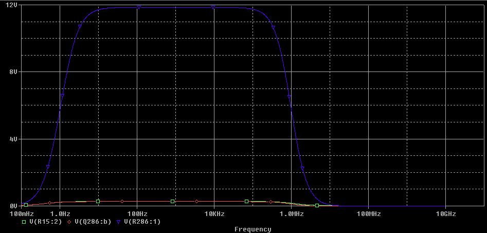

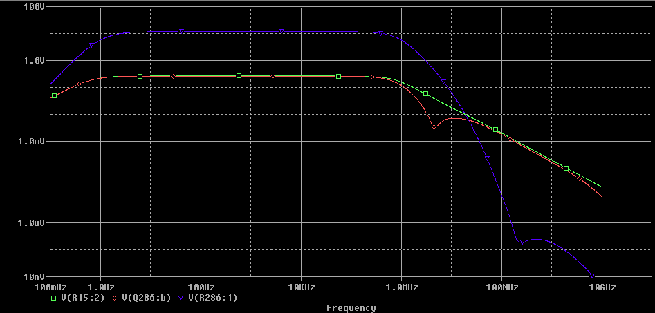

Another point regarding your 'NoCap' testbed relates to amplifier input resistance between the first base and the signal source.
I have for long now prefered low impedance amplifier drive via quality TV downlead coax and BNC connectors or filed out metal RCA phonos.. Your amplifier might well distort a little less if you do away with the 'input filter' which is also effectively in series with the first base as far as nfb loop control is concerned. The forward gain will not change, but the AF nfb response does improve slightly, and when compared to the 2k maybe by 2 to 3dB.
Another thing I prefer, is to use a resistor in the differential tail because its value tends to be so very high when compared to the generated differential emitter impedance. A current source can lead to unusual effects on transients and at high output.
I have just simulated my circuit with a current source in place of the passive biasing resistors; the simulated distortion went up from the 0.02% figure to 0.055% with some seriously undesirable cross-conduction on 10kHz sine, which in your circuit would attempt to raise the bias voltage on a per half cycle basis.
It should be very easy for you to work out the correct value for a fixed resistor and substitute it for listening tests.
