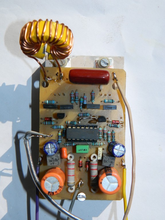

That looked a little TOO amazing until I saw the two screws at the top holding down what appear to be TO-220 semiconductors on a heat sink underneath the board. I see the three leads of each coming up through the board. With a single-sided board it's gotta be simple!

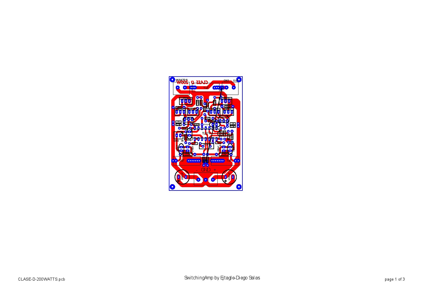

greetings i will post pcb and component layout for this simple amp
components ic TLO74 OUTPUT transistors IRF 540 IRF 9540
2N5401 2N5551 BD139 BD140 SUPPLYtransformeri used is 20 0 20 AC tested till
33 0 33 AC transformer all i can say it comes on first time output transistors
are very cool on 4ohm load amazing bass and clarity pcb size is 8cm by 5cm
for anyone making their first d class amp this amp is a good starting point 200
watts
warm regards
andrew lebon

here is my diy of this amp

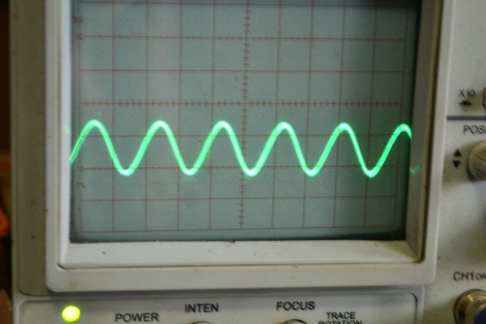

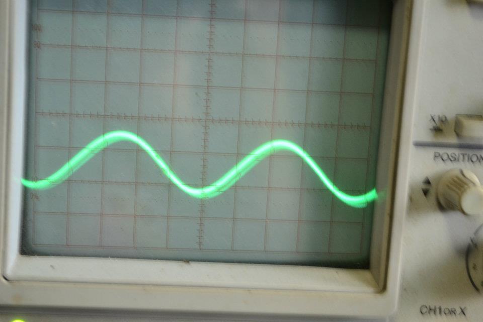

running at 50vdc idle offset 8.5mv inductor 47uh at 100 hz =28.27vac=206 watts 4 ohms load

Irvy, lower you inductor to 30uh then 680nf filter caps. for lower impedance 22uh and 1uf filter caps, the mosfet stable enough and only warming at full power, it will not overheat, do not go more than +/- 50vdc.
