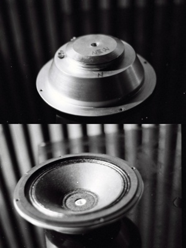

Manipulation and shaping of wavefronts has kept me occupied lately. Although a lot of research in this field has been done since the dawn of audio - just look up the old patents from Bell Labs and Western Electric - the availability of advanced software has taken research to a new level. This shift in technology has brought forth some excellent products: the JBL PT and Image Control waveguides, as well as several compression drivers featuring a complex diaphragm and phase plug design.
The same technological research and development has also major implications for live- and installed sound (PA), where the heavy full-range cabs have been replaced with digitally controlled line-arrays.
What's the effect of this paradigm shift for sound at home, in theatres, clubs and outdoor events?
An interesting perspective from an (educated) audiophile.
And on "traditional vs. high-tech loudspeaker drivers and materials", with a comment from the great John Dunlavy.
The "Funktion One Sound" - provided it's installed properly and managed accordingly - is hard to beat, especially for electronic music. That sound is the sound of "Paper". Tony Andrews prefers the vocal range to be covered by paper cones, even if it means a 10" playing all the way up to 4000Hz, hence the AxHead phase-plug.As noted in the first post, I wasn't trying to make a waveguide with a narrow pattern. I was trying to put the midranges of a Synergy Horn INSIDE the horn, like this: <snip>
How about that Resolution 1 in the picture above? It's a 2-way, over 100dB sensitive and able to hit 130dB, with paper? Yesss!

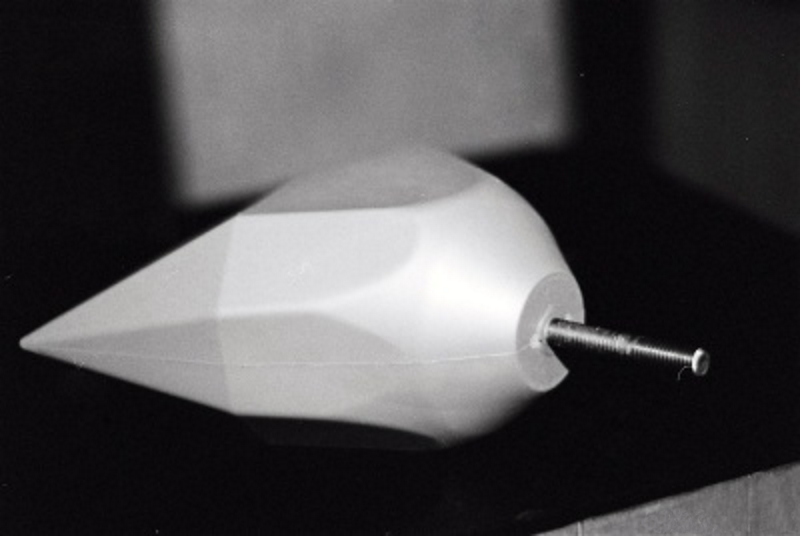

This is what's behind the Axhead:
It’s amazing how great minds can have the same ideas.
Have a look at this patent I stumbled upon yesterday before I read this post. US2016061614 COAXIAL CENTERBODY POINT-SOURCE (CCPS) HORN SPEAKER SYSTEM
