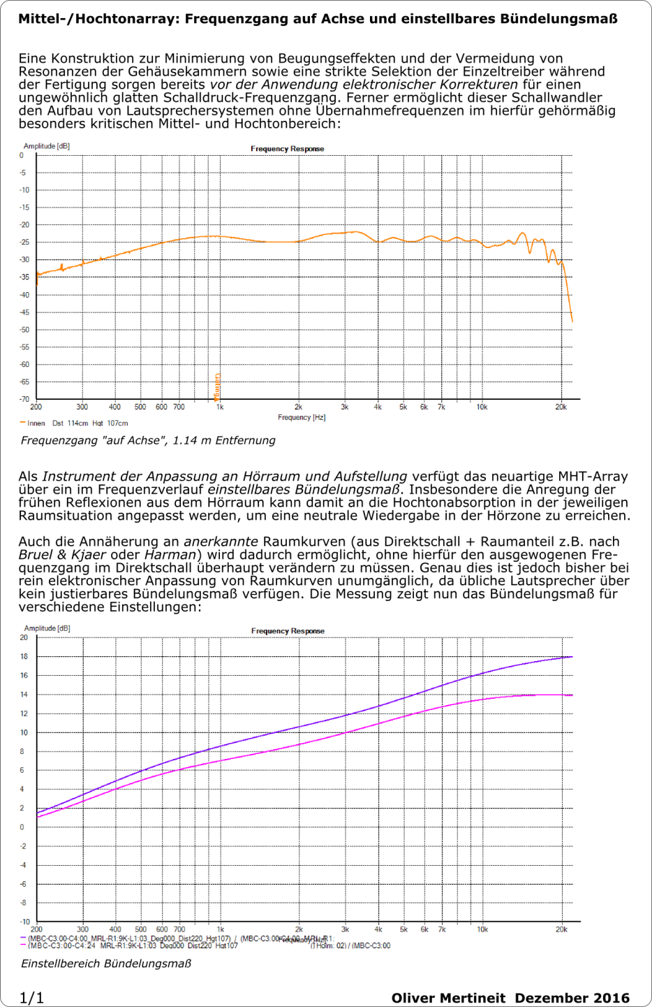

alternative approach to controlled directivity
Hello Patrick,
especially your asymmetrical WG designs seem to work very well regarding the compact dimensions. Nevertheless, frequency response IMO seems not as smooth, as could be obtained using larger waveguides or even direct radiators.
Below is a picture showing
- on axis response (upper diagram)
- directivity index (lower diagram)
of a new mid-/high array designed and built by myself during the last years ...
The model used for those measurments is about 6cm in depth and about 30x40cm in width x height.
Please note, that the directivity index is even adjustable using a kind of "beam steering" approach:
The pink curve of the lower diagram shows a "narrow" configuration while the blue curve shows a "wider" configuration.
The on axis frequency response does not even change markedly when "switching" between radiation patterns. The rise in DI is more due to vertical "narrowing" then narrowing horizontally. On axis response from 0.6Khz to 16Khz is about within +/- 1.5 dB.
There is no electronic "correction" whatsoever to produce that frequency response.
Hello Patrick,
Hello Oliver,
Would you care to share what exactly your alternative approach entails & how it functions?
Eelco
Eelco
Hi Eelco,
let's wait a few years to uncover details ...
This was just to show i am also interested in controlled directivity even in the mid- and high range, and there are alternatives to waveguides, that are even attractive due to "compact" dimensions at least in depth of construction.
Nevertheless you need "more drivers", which undoubtedly is also a cost driving factor ...
Correction, sorry ...
It is the other way round: Pink is "wider" and blue is "narrower" dispersion 😉
(time for editing original post has elapsed)
