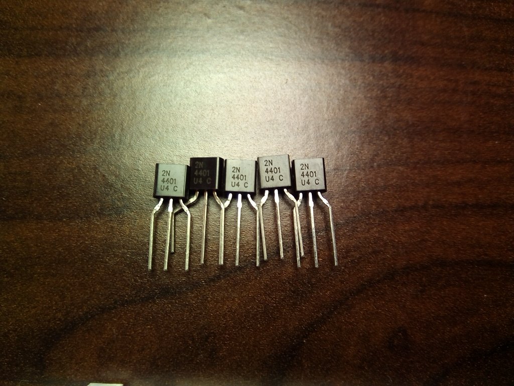

Transistors:

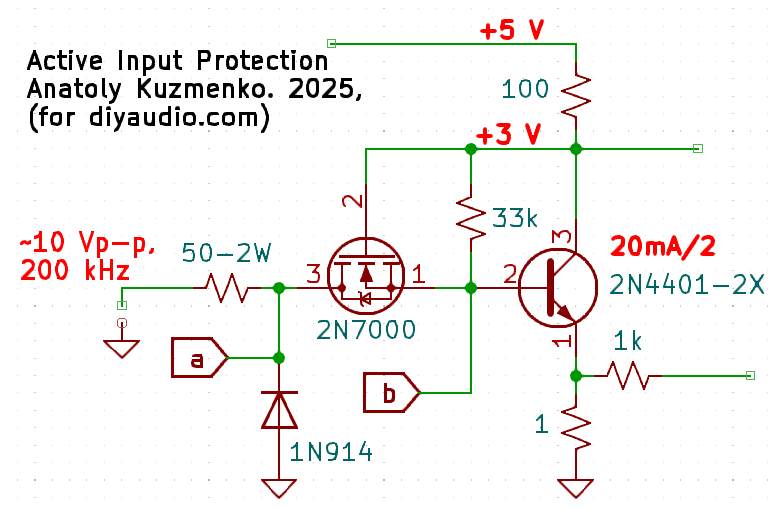

Schematics:
Circuits description:
TTC-004 is a denoiser/ PS ripple suppressor.
2N7000 is active input protection - saves BJT during input conection/ disconnection
overstress.

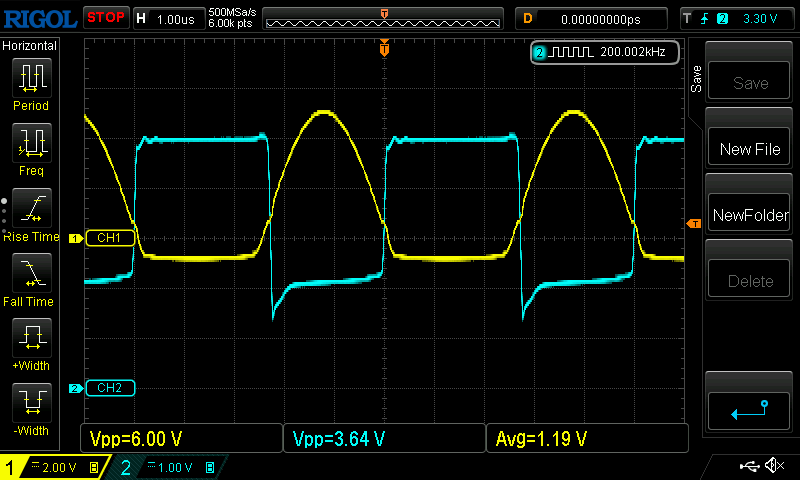

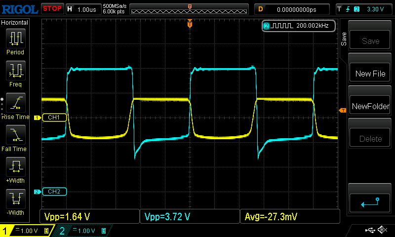

Real crash test of input protection:
yellow - base voltage, blue - collector.

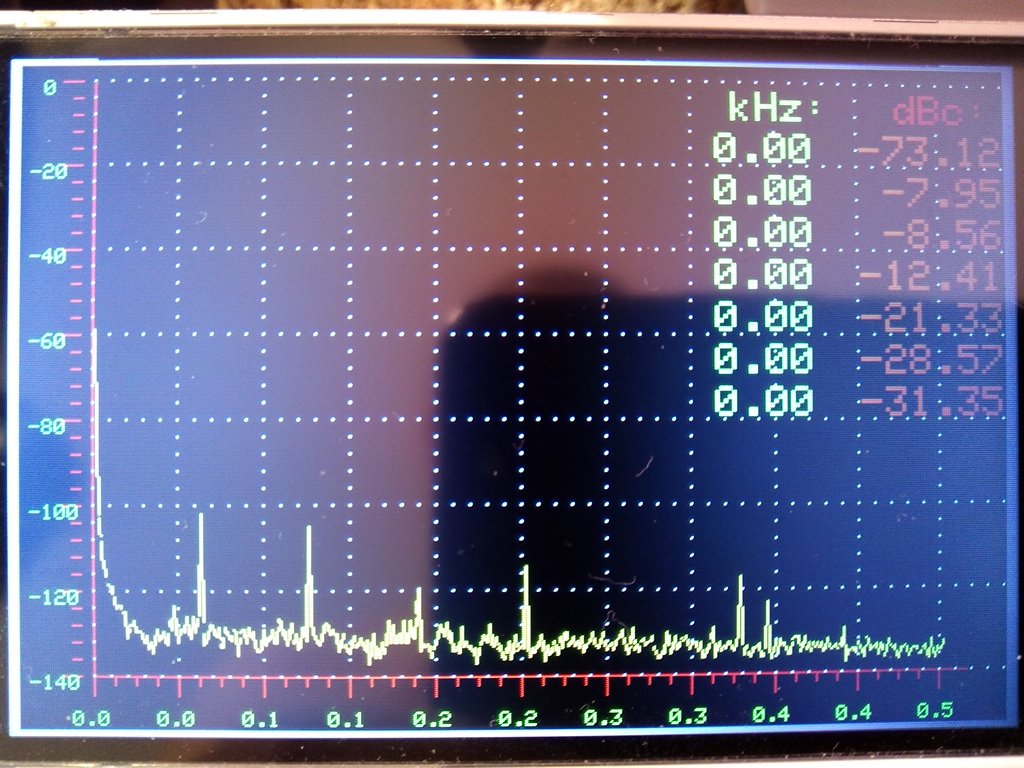

I'm not familiar with the instrument you are using to generate the bode plot and am not sure how to read it. Does the 1/f noise limit the lower end of the bandwidth, or is that calculated based on your various RC time constants?
My quick math says that the 20 ohm protection resistor on the input would contribute 0.580 nV/sqrt(Hz) of noise right off the bat. Did you need to short it to achieve the 400pV/sqrt(Hz) figure?

Project in progress, running on breadboard at this time.
Instrument:
MCP3561 DIY spectrum analyzer, freq. chart - linear scale, low freq. end is distorted by DC offset, so data < 10 Hz is not accurate. Span is 500 Hz.
In the mid-scale error about +-1 dB. Verified by Rigol 1022 SG, two steps divider /100dB to get 10 & 100 nV markers.
I've build another SA ads131m04 based, 4 channel and log freq. chart starting from 0.1Hz on the left. But not using for now, since fft-32k takes about 2 min to update screen, not any good if doing some adjustment.
20 Ohm was not installed when SA chart taken. Resistor added later on to conduct overload crash test.
Mosfet adds ~4 Ohm resistance at 2.5V G-S (diotec 2n7000).
Likely I'd keep <10 Ohm or so with another schottky diode as input protection. With optional by-pass jumper.
<400 pV results with base directly grounded by 1500 uF.
<800 if 20 Ohms in series
< 1 nV if 100 Ohms. Noise level is rising quiqly.

There's no backwards protection diode across the BJT's base-emitter junction - usually advisable to protect against EB-junction reverse breakdown for low-noise use (even a short transient could increase the devices noise figure if zener-breakdown happens in the EB junction).

I have two diodes, should be fine.
2N4401 is not low noise type, no UHF type that usually has lower BE breakdown threshold 1-3V.
2N4401 chosen due low Rb, alternative is BC337.

Transistor specified to 5V BE, and there is no reason to believe that more than 1V reverse voltage may ever appears. See stress-test oscillogramme.
