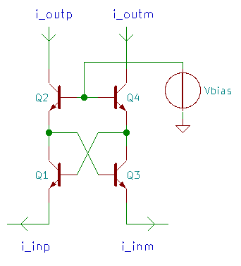

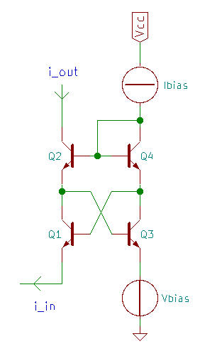

One of the proposed circuits features current followers to be put between the DAC core and the reconstruction filter. There is an exotic type of translinear current follower that might be useful for that application; it uses several kinds of feedback, both positive and negative, but I think those all count as local. If I'm not mistaken, it's called a crossquad, although that term usually refers to something else, namely a common-centroid layout technique.
When Q1 matches Q2 and Q3 matches Q4 and they all have reasonably high hFE, the voltage at the input is determined by voltage source Vbias. That is, the input voltage is Vbias + vBE,Q3 + vBE,Q2 - vBE,Q4 - vBE,Q1. As Q2 and Q1 run at essentially the same current and the same holds for Q3 and Q4, the base-emitter voltages ideally cancel. Finite hFE and Early effect and self-heating in Q2 can still spoil it to some extent.
When you choose Vbias > 2.48 V, for example equal to the 4.96 V reference, there will always be a net current flowing out of the emitter of Q1. That's obviously necessary to make it work.

Forgot to mention that this is a balanced version of the crossquad current follower. It only works well for differential currents. For common-mode currents, it is equivalent to just a pair of plain old common-base stages (Q2 and Q4) with diode-connected transistors in series with their inputs (Q1 and Q3).

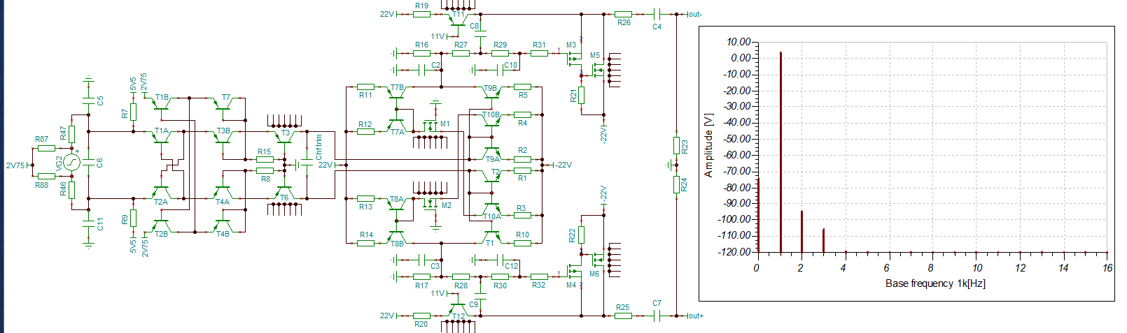

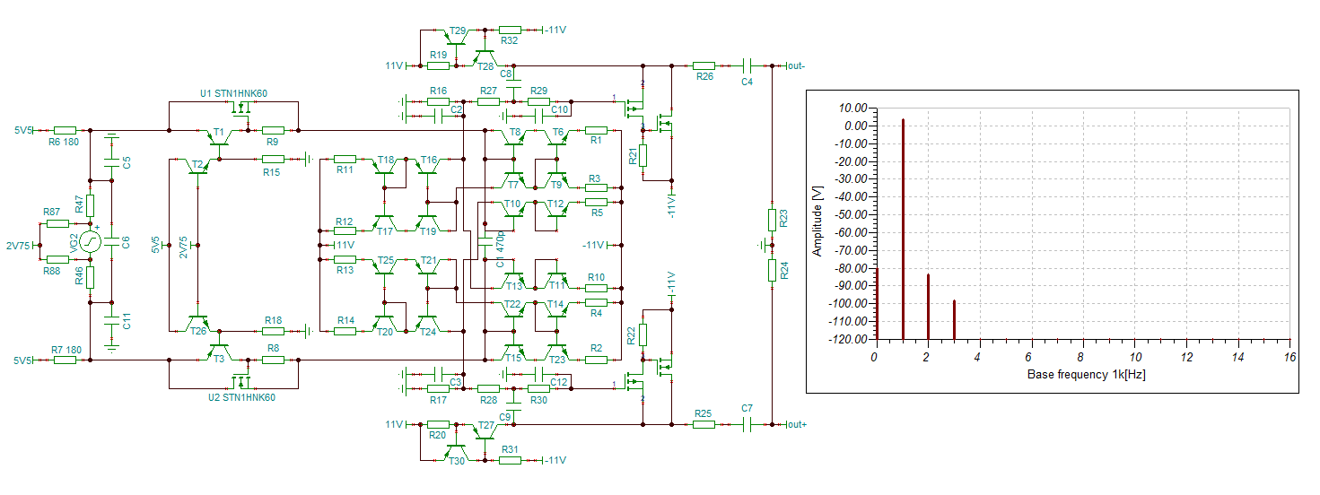

Is there an ultra-low distortion (<125 dB THD (DC to ~30 kHz), non-GFB, discrete components (non-opamp), non-complex design (basically "not that many components") DAC line level amplification circuitry (gain 5-10x) in existence somewhere accessible? I am asking because MarcelvdG's RTZ FIRDAC design in this post:
Well, for a number of reasons I dug out some old design for an AMR product that never got released. It shows reasonably well what non loop NFB not excessively complex can do. Now note, I am not simulating a circuit fragment, but a complete practical circuits.
It's for a discrete FIR DAC (not exactly MvG's on, but similar enough).
The I/U conversion uses a BJT/FET Sziklai followed by a bunch of current mirrors that split and mix the currents, to create two single ended outputs that mix the two output current phases and allow also balanced out. Followers are added (FET Sziklai aka inverted Darlington), as otherwise output impedance is rather high.
The followers together with I/U conversion resistors and the other RC form a 3rd order LPF, 20Hz-20kHz is +0/-0.05dB or better flatness, at the cost of a ~190khz -3dB point, which is rather high given noise shaping in the DSD Source. Attenuation at around DSD256 sample frequency is ~110dB.
Parts values / types values are no shown, but should be obvious / easy to calculate.
Sim suggests ~-90dB H2 for 0dBFS and SE out. Balanced cancels H2 and leads to lower THD but not really lower audible distortion. Non of the obvious tweaks to the circuit such as cascoding etc. offer any tractability in getting seriously lower HD. SNR looks 116dB unweighted re. 2V SE / 4V BAL.
In listening tests the results of the prototypes where excellent, there the followers were Tube Cathode follower.
I'd be interested to see circuitry that is more simple, higher performance or both.
While -90dB H2 is not hard, -120dB seems a trifle challenging.

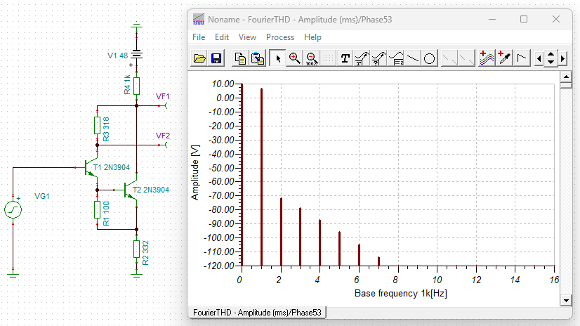

BTW ... This morning I happened to think about possible solutions and remembered the so-called Kulish structure (the schematic is on the previous page at the bottom):
https://www.diyaudio.com/community/threads/single-darlington-line-preamp.74861/page-4
Only two transistors, "high" input impedance & single-ended it reaches ~ -135 dB 2H in simulation. In practice though it may require a relatively high supply voltage and the DC voltage output level from the RTZ FIRDAC is a little lowish to optimize the error correction of this circuitry - it probably would require a smallish negative voltage supply as well to allow for resistor values of suitable sizes. But maybe an option ... ?
Build it, measure it. MY simulation suggests a much worse performance.
MIND YOU, for such a simple circuit the result is not bad.

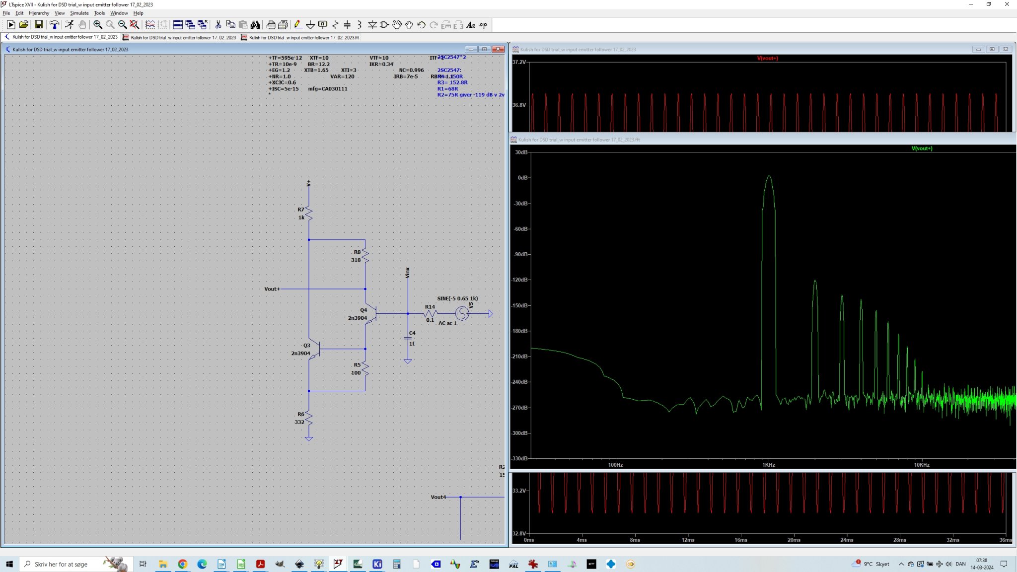

@ThorstenL : Hmmm, well, it still is not quite the type of circuitry I am looking for but who knows - maybe some day it may come more into vogue ...
Regarding the Kulish circuitry I linked to, in LTSpice it simulates to ~-122 dB 2H with the setup shown in the link (see attachment). Output level 4Vpp. However, other transistors simulate better than the 2N3904s.
In practice I have found it to be capable of at least - 108 dB 2H - but in a suboptimal measurement setup so I wouldn't be surprised if it did better than that in a more optimized setup. One advantage of this circuitry I have noticed though, besides low component count and single-ended performance, is that it appears to be almost unaffected by the load impedance it looks into. On the other hand it is quite sensitive to temperature variations and the actual precise value of the resistors used. Even very low changes in both temperature & resistance values may cause significant changes of distortion levels. So IMHO a somewhat "picky" circuitry.
