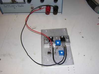

I just made an experiment (see below) to see how the MOSFET's should be temp. compensated. You need around 2.5 V on the VBE multiplier, and some 5.5 V of temp. stable Zener voltage on top of that. I used a varialbe Zener diode to find these values, why not use steady resistors in the VBE multiplier, and a variable Zener diode in the real amp?
The Variable Zener Diode is: TL431A from TI. (cheap).
You don't need the 'Emitter' resistors! Just short them together as i did.

Just adding: The test sample above is cooking hot on this picture. It is completely bias stable (within 10%) from room temp. to 120 deg. C.

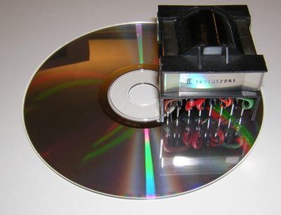

Sure PerAnders, we discussed the use of Switched Mode PSU's on page 5.
It is not so expensive. This one is factory wound for the UL listing, but since it only contains about 25 windings in all, any DIY'er can easily make it at home. The ferrite cost the formidable sum of 1$, and 2m of electrical wire cost .. nothing. (almost). So a 1kW transformer for around 1$ .. not bad i think. Of course you need a bit of support circuit, but it can also be put together cheaply.
.... if he/she has accurate instructions... very important if the switching speed is high.Lars Clausen said:It is not so expensive. This one is factory wound for the UL listing, but since it only contains about 25 windings in all, any DIY'er can easily make it at home.

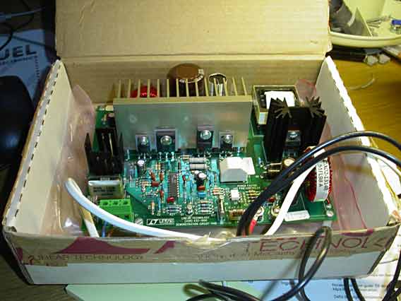

Here is something to put your teeth in.
Check the ready design. I have this PS at work. Very nice working PS which I got for free!
http://www.linear.com/pdf/lt1509.pdf

Not at the picture how small the transformer is and compare the rest. This PS gives 300 W with forced cooling and approx 200 W just as it is.
