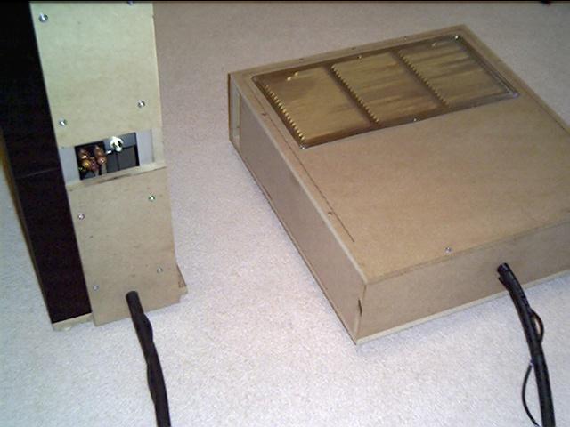

Cheapest enclosure that I managed
two 2x4 mdf board - $12cdn, plus some left overs from prevous projects.
two 2@ 8 foot alum.corner strip - $12.50cdn
so besides screws and paint etc..$24 +25cdn to make two set of these;;
PS, I forgot how much the vent cover cost from Home Depot
Oh , and 16 wooden door knobs for feets @ 1.25cdn each

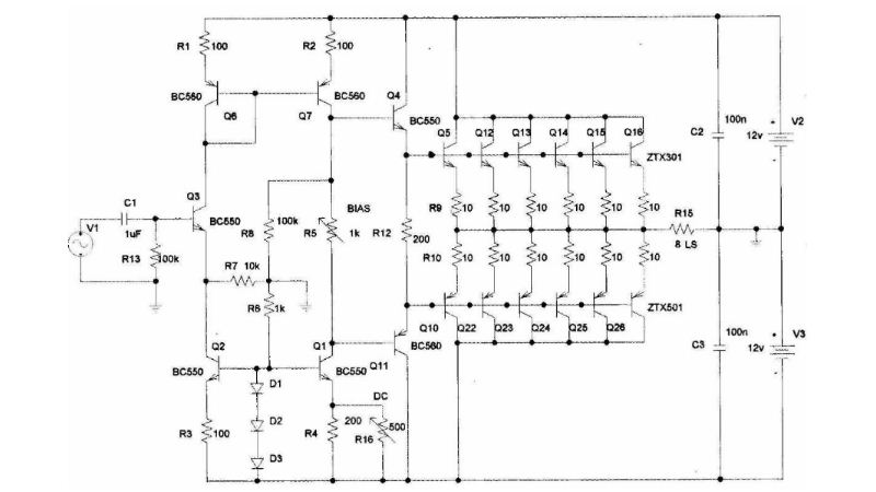

That's an interesting design. Like the one from Lars Clausen, I find it interesting not because it seems optimized for low-cost, but because of the topology.
Have you build this one? Do you know how designed it, or where it's from or any other info? I really like it. I have simulated a bit this weekend with this topology, and it has some quirky, quarky issues, but still, it is very differrent and I am trying to design something like this for a while now...

It would be the perfect solution to a high performance head phone amplifier. I think 5W in 8 Ohms is enough... Even for a sensitive loudspeaker 5W can make enough power for most uses.
Very interesting design. How about using 100 output devices, like this, and producing 50W in 8 Ohms. (With a little bit higher voltage too of course) ??
Hi tschrama,
I haven't built the amp (yet) it's really just an idea with components chosen for convenience as much as anything else (no optimisation) but it does simulate quite well and should work ok with a few tweaks, it may need a servo to stabilise DC offset. The cost to build should be very low even including PSU, a pair of surplus 12V SLA batteries would be ideal.
It's essentially a single ended input stage driving a current mirror (Q6,Q7), gain is set by the ratio of R7 and R8. Without the current mirror it would look like a common emitter stage with R7 at one end and R8 at the other. The rest is just standard EF push-pull.
The distortion characteristic is dominated by the input stage and although relatively high compared to amps with nfb it is classic low order so could sound very good coupled to efficient (90dBW+) speakers and the soft-clipping may give the impression that it's more powerful than it really is.
I liked the idea of using multiple small output transistors rather than power transistors because they can be bought very cheaply in quantity, they have higher current gain, bias stability should be good due to the use of high value emitter resistors, the large collective surface area of lots of small devices avoids the need for a heatsink and most importantly rows of transistors look good🙂 I specified ZTX's because of their high current rating (500mA) but anything would work providing there are enough of them.
With enough output devices it could be biased into full class-a with a dissipation of less than 25W which could make an interesting and aesthetically impressive project. The problem with building amps is often cost and hardware concerns but by thinking small there's a lot more freedom to experiment with more unusual designs.
Richard C,
I love it! My simulation should some serious distortion, but I still like it. I have no doubt that when tweaked a bit it should perform good enough.
If you are serious about building and are ordering parts then (only if you don't mind) maybe you would be willing to oders the parts duoble and send one set to me. Offcourse I will pay your costs.

Lars Clausen said:It would be the perfect solution to a high performance head phone amplifier. I think 5W in 8 Ohms is enough... Even for a sensitive loudspeaker 5W can make enough power for most uses.
Have you seen Dr. Meier's opamp based amplifier? 44 LM6171 per channel, see here.
I think when I simulated the amp I used a single resistor for R4,R16 of around 107 Ohm and a bias resistor of about 460 Ohm for an Iq of 50-100mA. The trickiest part is setting the output to 0V there isn't much room for manouvre with such a low supply voltage but distortion's quite low when everythings set right.
Before ordering parts it's worth building a prototype with just a single pair of O/P transistors so that any issues (and there are a few) can be sorted before commiting to a final design. I'll try and find time to do something this week...

You should try lowering the current of the input transistor, 14 mA is a bit high. I think you will have trouble keeping it DC stable as the temperature of this transistor changes.
With a 100k Gain resistor, you only need 1 mA to produce 100 V of output voltage, more than enough, when you have a 12V supply rail.
And 10mA to feed the current mirror - also way too high 0,2 mA is more than enough.
